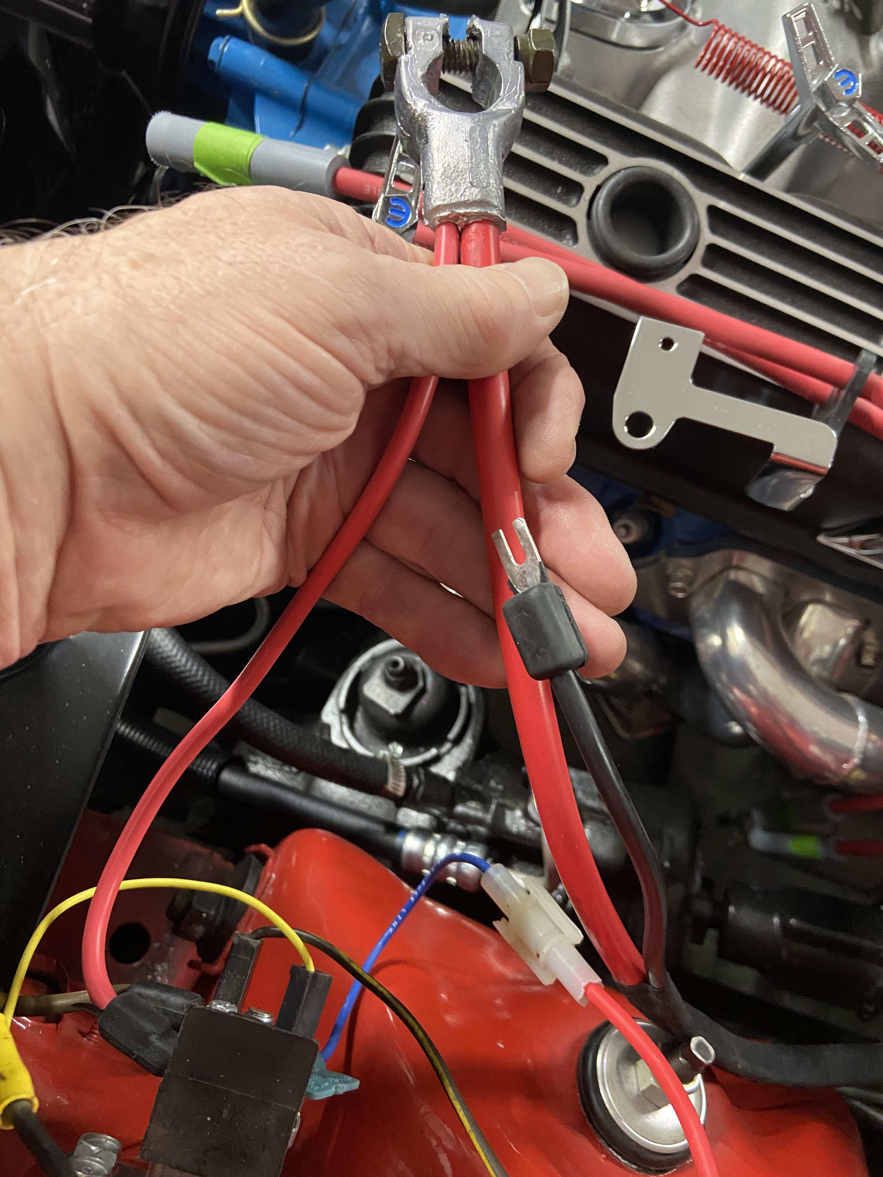

Dec 10, 2023 #1 L luft29 Well-Known Member Joined Feb 19, 2022 Messages 57 Reaction score 7 Location Berlin NJ Hi, does anyone know where this black wire with the u connector goes, it’s part of the positive cable, thanks

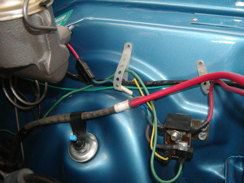

Dec 10, 2023 #2 Challenger RTA Well-Known Member Joined Oct 28, 2018 Messages 4,016 Reaction score 2,120 Location PA Flood city On the starter relay. not a good picture. I'll see if I can find a better one.
Dec 10, 2023 #3 Challenger RTA Well-Known Member Joined Oct 28, 2018 Messages 4,016 Reaction score 2,120 Location PA Flood city Here you go. Sorry took me a minute.
Dec 10, 2023 #4 Challenger RTA Well-Known Member Joined Oct 28, 2018 Messages 4,016 Reaction score 2,120 Location PA Flood city By the way make sure the relay mounting screws have a good ground contact.
