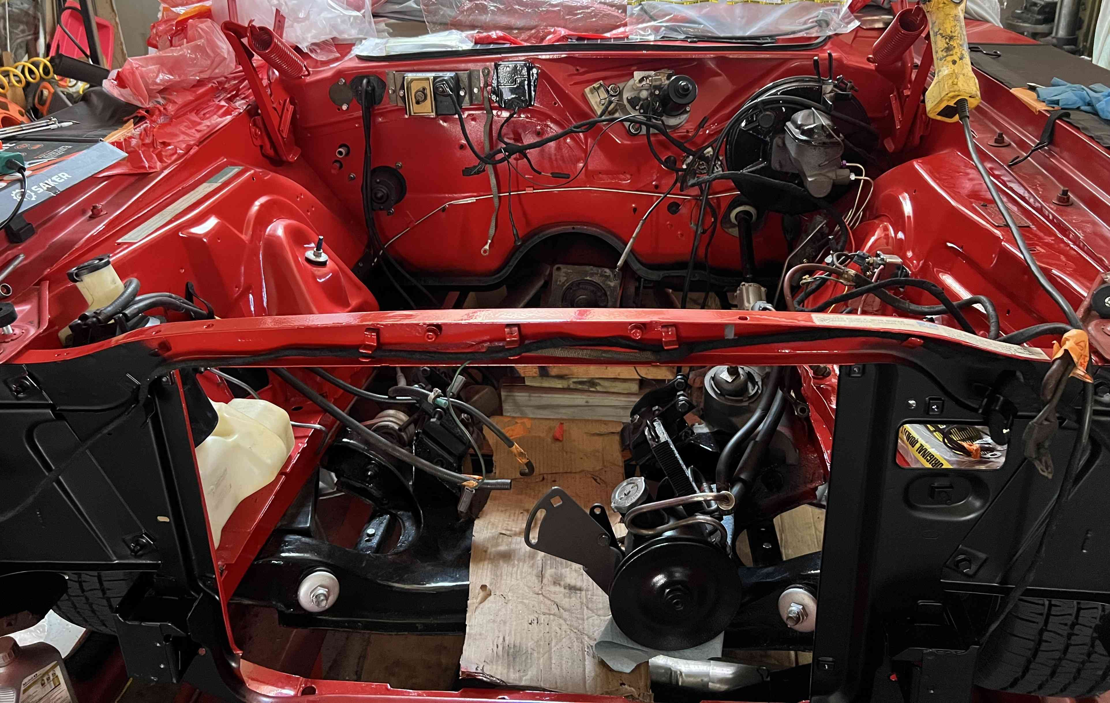

I have been working on partially restoring the original harnesses of my 1970 Challenger. I have completed the harness that goes behind the dash after changing out all bad wires, upgraded a few (larger gauge) as needed, re-wrapped with the non-adhesive vinyl, cleaned all connectors and used contact cleaner on all terminals!! I am now beginning work on the harness going from the bulk-head connector to the headlights via the drivers side inner fender. At the start of the harness, about 5 inches from the bulk-head connector, there is a translucent, almost white, 1/2" wide wrapping that goes for about 6 inches and covers the black vinyl wrap. This harness appears original and even still has the 1-inch wide, white, part number "tag" on the harness where this translucent wrap starts, so I think this extra wrap is original. Does anyone know what that kind of wrap is called and where it can be purchased? I have not seen it before on an original harness or restoration harness from Year One, etc.

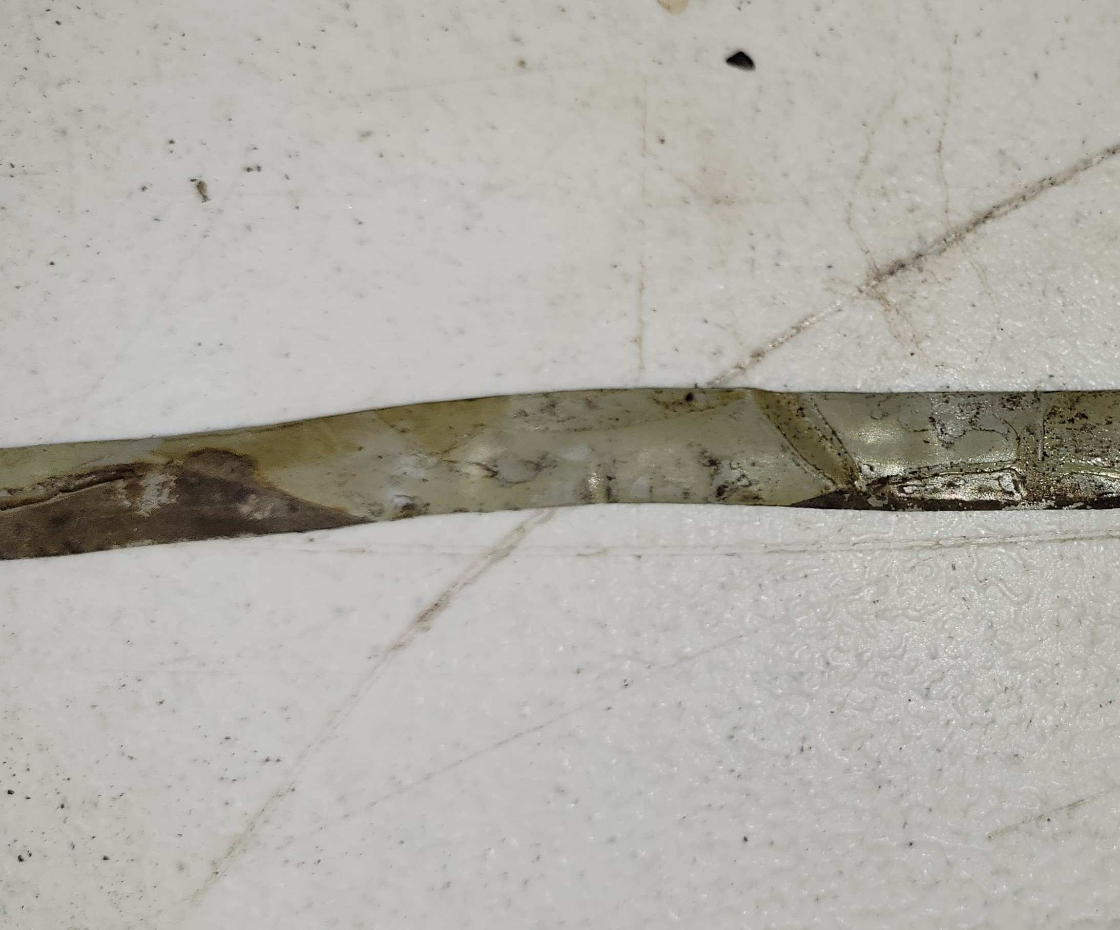

Edit to my original posting. The "translucent" wrap is not actually translucent at all. I carefully cleaned off about 2 inches worth of the wrap on both sides. It is a light grey color. The wrap is 3/8" wide and the entire piece is only 52" long. See photo included.
Hello everyone! Submitting this post in hopes that no one has gone down a rabbit hole trying to figure out where the grey wrap over the black vinyl wrap comes from. After removing the remainder of the wrap on the harness and inspecting the wires, it appears that the grey wrap is not original, but an attempt by a previous owner to fix some wiring issues. They grey tape is quite dirty for the most part, and as I was uncovering the entire harness, I found a LOT more of it

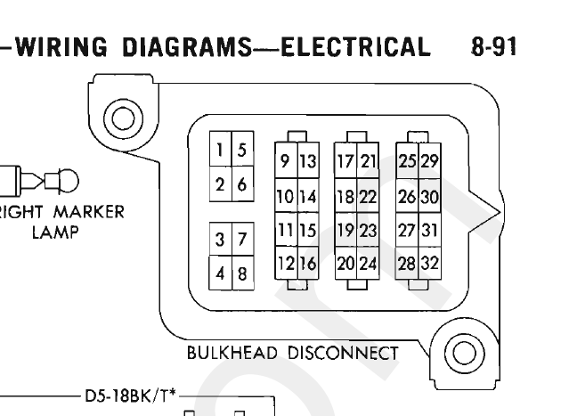

I DO HAVE A NEW QUESTION however. In the 1970 Dodge Dart / Challenger Service manual on page 8-91, there is a picture in the top right corner of a "bulkhead disconnect" which is quite different from the one I have. In the following pic there is a set of connections numbered 25 through 32 which do NOT appear on my bulkhead disconnect.
What am I missing? Are there more than 1 style of bulkhead disconnect for a 1970 non-Hemi Challenger? This is not a major issue of course because I am only going to worry about connections that exist in my harness. I am curious about the situation however!

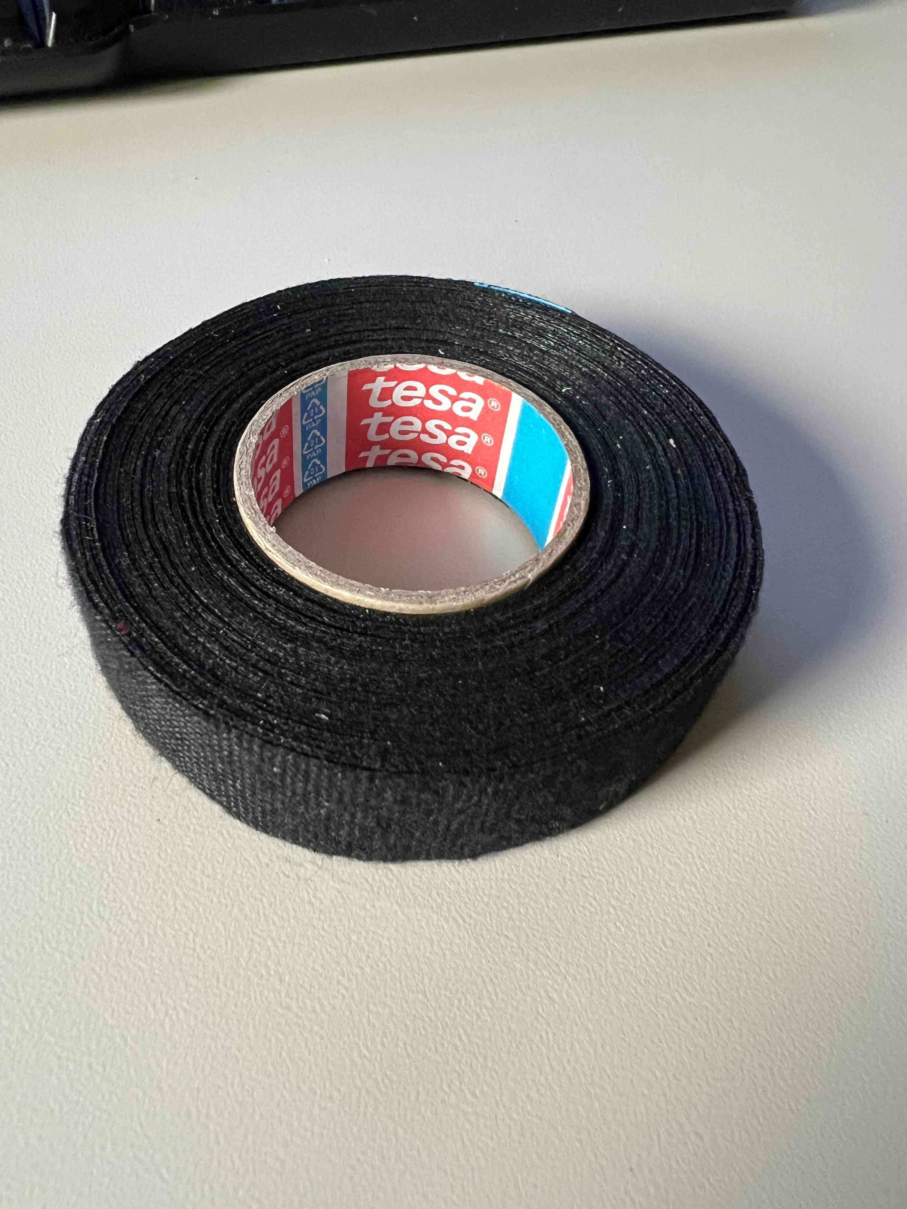

Later model OEM wire harnesses use Tesa tape. It has that fabric like tape consistency. Probably not OE correct for the early cars. But its easily found on Amazon.
I looked around and found Tesa tape. It feels fuzzy on the top side. Good for heat and will not tear with Great adhesion. Did my Engine Bay with it. Trick to remove old tape is a seam ripper.
