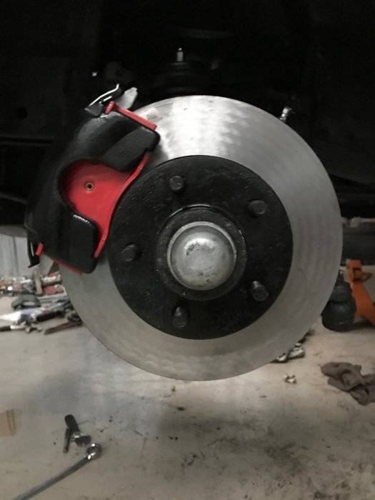

    I went from a /6 to a 440HP, no mods to tunnel but did convert to R/T suspension and power disk brakes in front.
