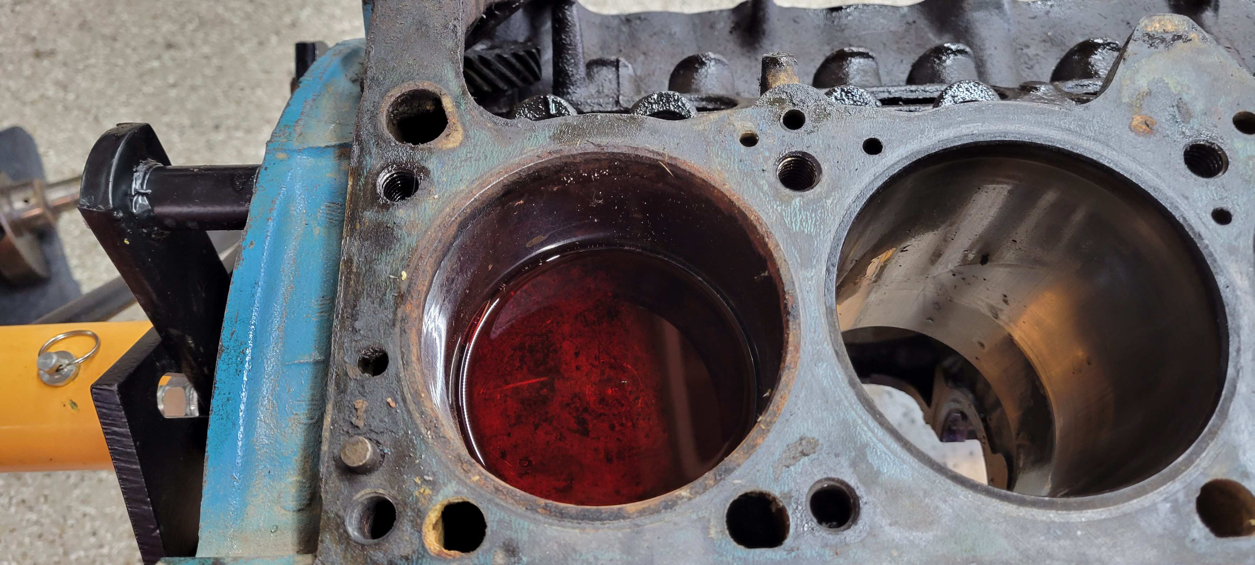

So far have removed the engine and trans and was able to free up a frozen cylinder enough to get all the parts out of the engine! Everything mechanical from the block looks ok except for cylinder number 8 that had a collapsed intake lifter and the piston rusted in place about half-way down the cylinder. Next up for that is measuring all the cylinders to see if it needs to be bored, or if I can get by with a good honing. Just by eye, the bad cylinder doesn't look too terribly scraped.

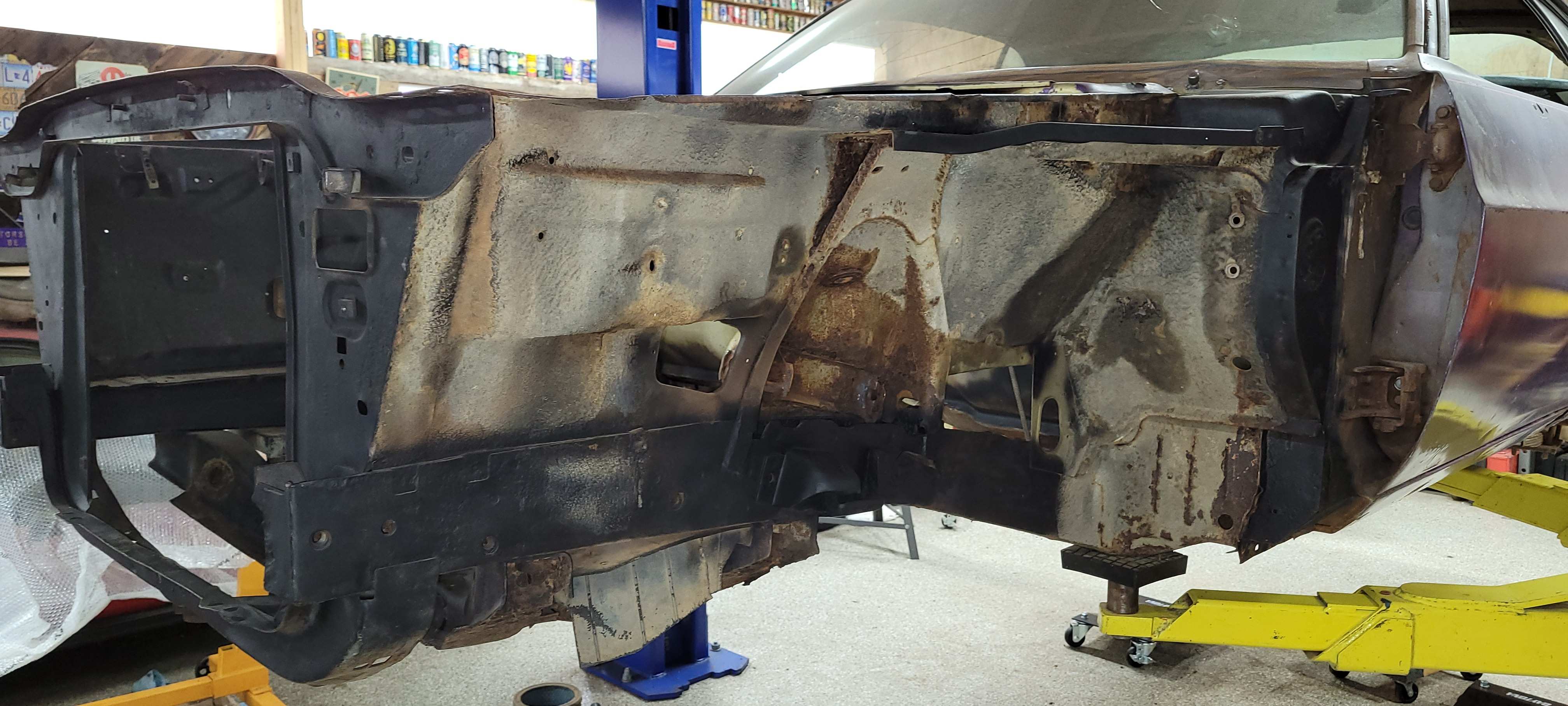

Also have the front of the car torn down to the frame rails and core support. The LH inside fender needs replacing as well as the shock mount, and some work is needed on the RH inner fender where the hood hinge attaches. I have removed as much rust as possible - I was surprised how much of it was just surface rust, and how nice the frame rails looked! All remaining was covered with a rust converter.

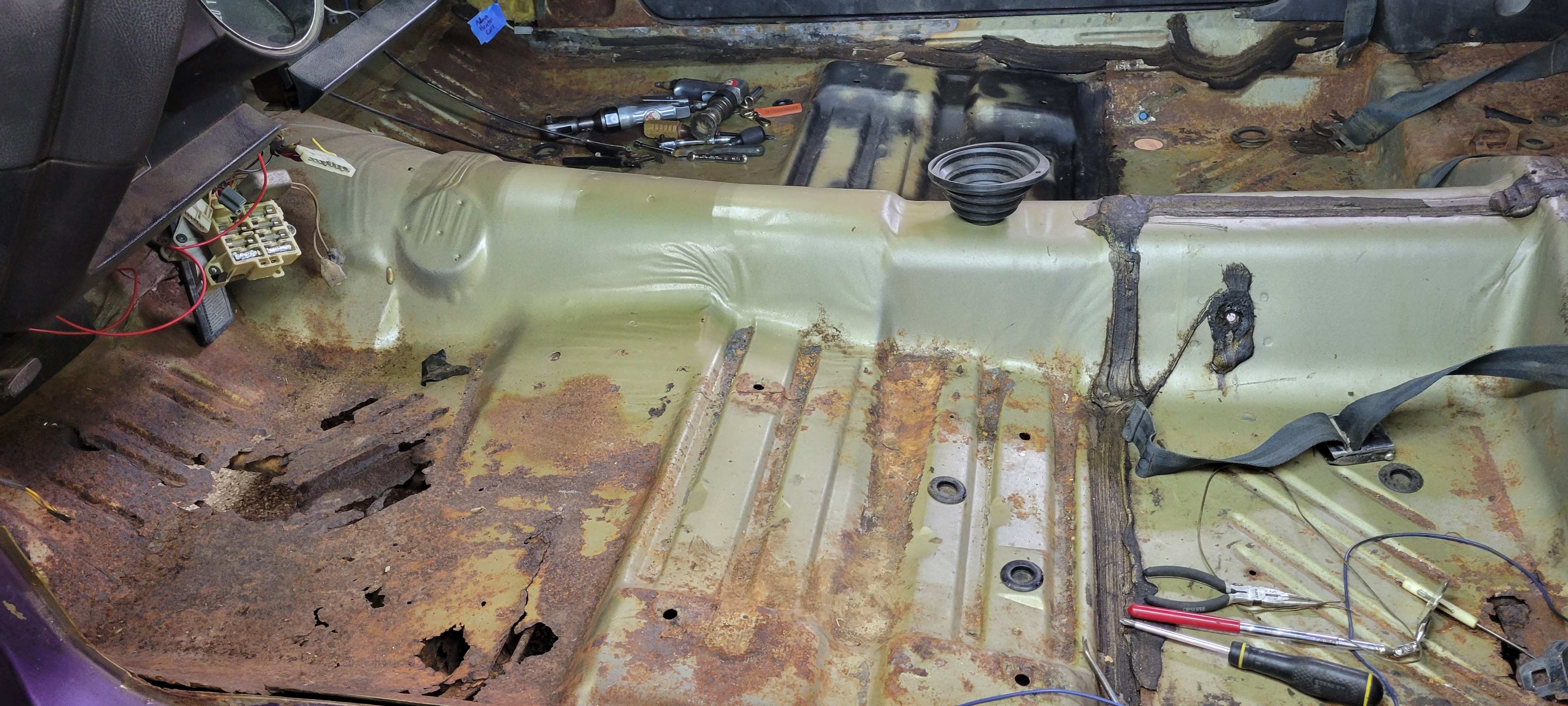

Interior is gutted except for the headliner, rear seat belts and dash. All will be coming out this weekend. Passenger side is covered in surface rust, but pounding on it with a screwdriver did no damage. Drivers floor is gone as well as part of the torsion bar support, so I am looking at a drivers side floor pan and a new support. I think Dynacorn has a full floor with everything, so I don't know maybe we'll do it all! The rear under seat pan is also no good, so that will be replaced.

Unfortunately when the rings rust to the cylinder such that the piston is stuck in there, it'll need a bore.

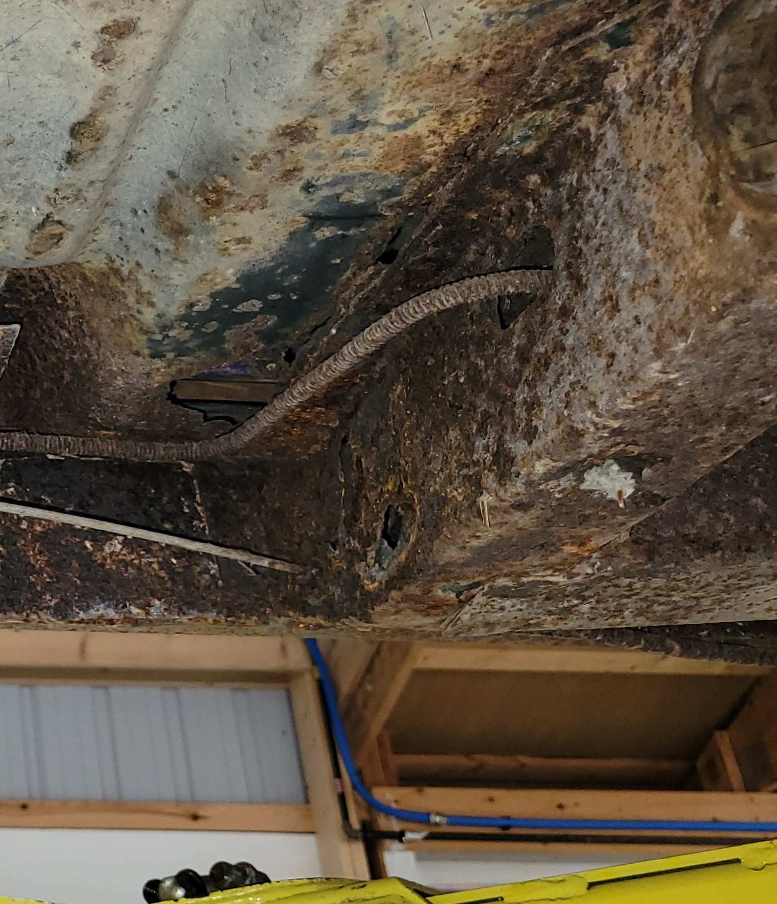

Unfortunately the torsion bar cross member is rotten on the rear side of the drivers end. Approx 2-/12 inches of it is missing, as can be seen in this pic! Although I could not force a screwdriver through any of the rest of the cross-member, I don't want to take a chance not fixing it and having a suspension failure!
heminut
841
688
Deming, New Mexico
That's pretty bad!

The number 8 cylinder wall doesn't look as bad as I thought it would be. Pitting from the rust is very light, so I may have lucked out there and won't need a bore (fingers, toes and eyes crossed)!! I have cleaned all the removed metal parts, but unfortunately I have been so far unable to remove the upper ring from the one piston that was stuck. Looking like a new piston will be required. Still need to mic everything including the cylinder bores before finalizing the plan, buying parts or performing any reassembly. All of the bearings look to be in nice condition (high mileage, but well cared for), and the cam and crank both appear undamaged as well.

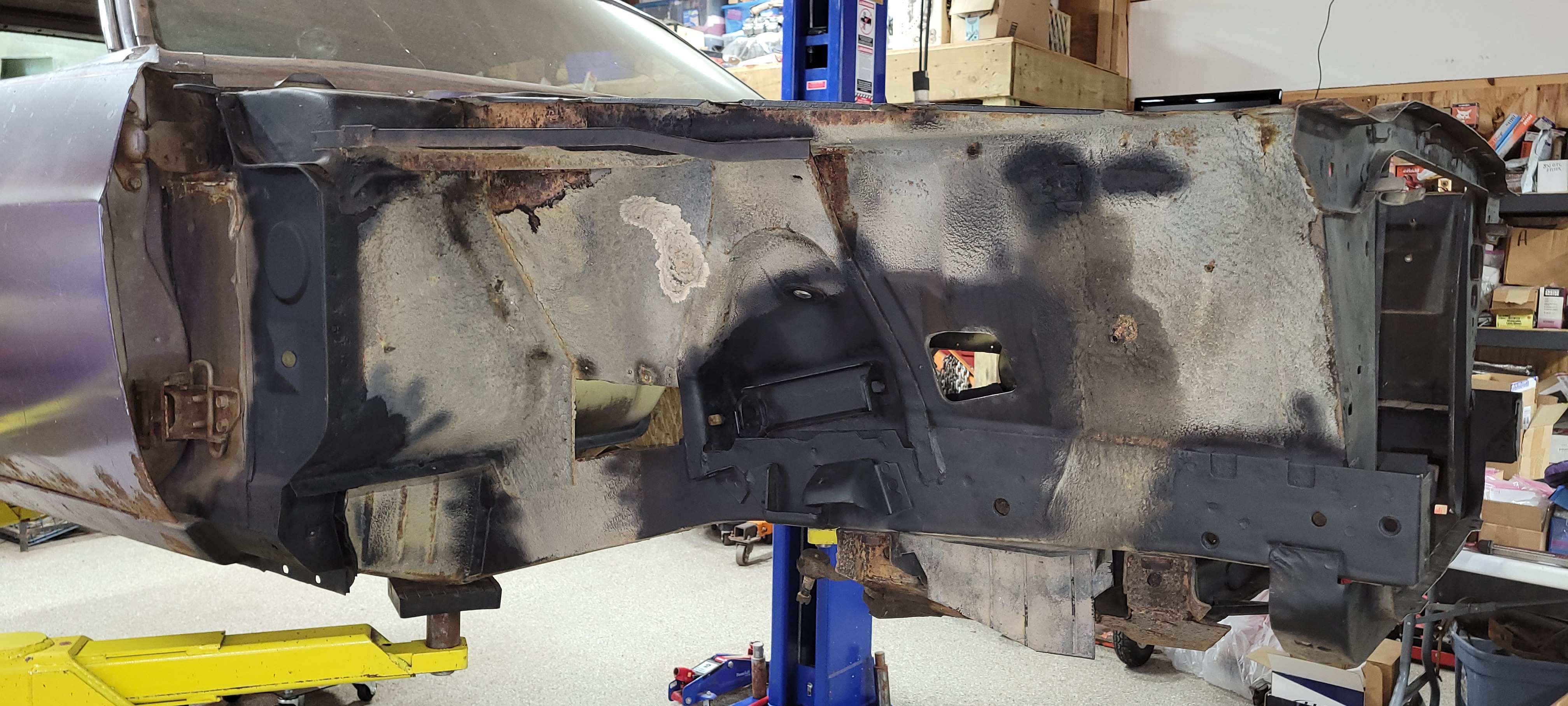

Attached are pics of the work done on the front end metal inside the fenders. Not doing anything additional to the drivers side as next step will be to remove the shock tower, brace and inner fender metal and replace.
That's pretty much it for now!

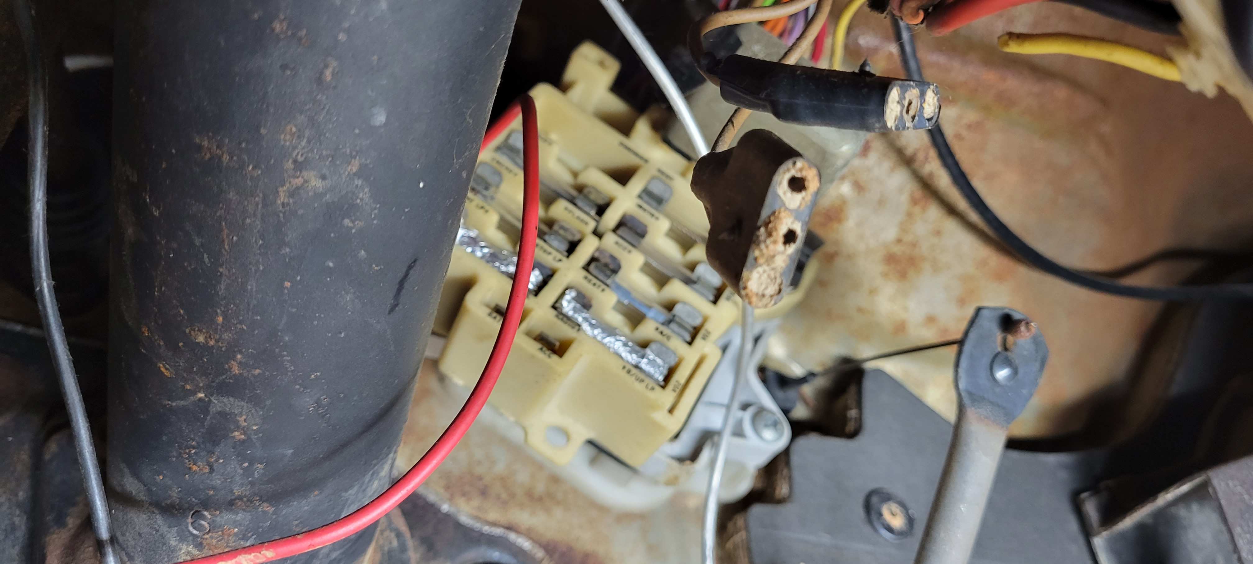

Just to keep the post up to date, here are a couple pics of what I am finding while checking out my dash wiring (needed something to do indoors during the winter months in MN!). The previous owner must have had an issue with wiring at some point because they had burned a couple of fuses. They decided it would be a good idea to put tin foil around them and reinstall!! I have a list of the color, length and gauge of wires I need to replace as well as the connectors and terminals needed. I will replace burned wires with one gauge larger. Will be ordering them this week I hope. Also going through each connector / terminal using different tools to clean and spraying with electrical cleaner. After finishing repairs on the main dash harness, there are several more I will uncover and repair as needed one at a time. As temps improve here, I will get back to working on the metal pieces. First will be the drivers inner fender, brace and shock tower so I can begin rebuilding the front and suspension.
Under-dash pic where you can see the fuses at the bottom of the fuse box installed with tin foil around them. Appears there may be a little corrosion on some wire connectors.

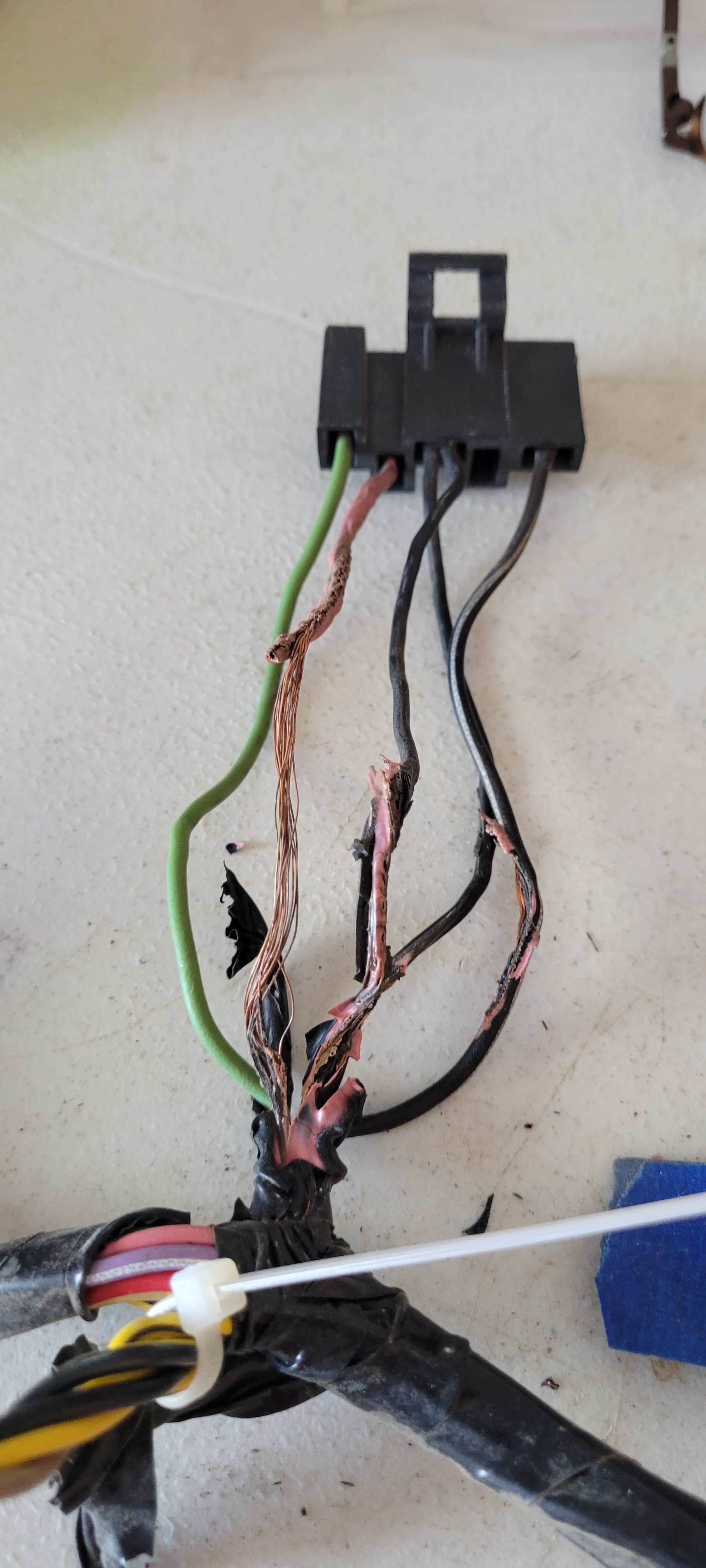

First issue found at Headlight Switch connector. The pink wire was melted to the casing of several wires within the length of the main harness. It took a couple of days to separate everything without causing more damage.

You are encountering the electrical issues of mopar. Looks like you have an understanding of what you are doing. Some would say buy a new one. I myself too. Then I thought who much is a new one. Me thinking
$700-800. NOPE! 1289.95+shipping and tax. There was a member here that bought a new AAW harness and there were issues. nothing that can't be sorted out.
But any how proceed. Just my 2¢.Whith my experience and some others here are too have. I would do what you are doing. You have the harness opened up and tied, so inspect for melted wires and brittle ends. The headlight hi low switch is a problem there is a replacement plug for it. The the best fix is a headlight relay circuit. Or else it will happen again. And other thing is the bulkhead connectors. Abandon the amp gauge and battery wires through the connectors some how. The wires in the dash harness from alternator and battery are sometimes melted from an over load. In any event I replaced and didn't wrap them up back into the harness.
The other thing to check is the fan switch and the fan connector. The also over heat.
The bulkhead connectors are more than likely the issue. Clean them up and check again. Splice 1 is never the issue unless someone messed with it. You can feed it some other way. through the washer foot pump grommet. But use the fusible link.
