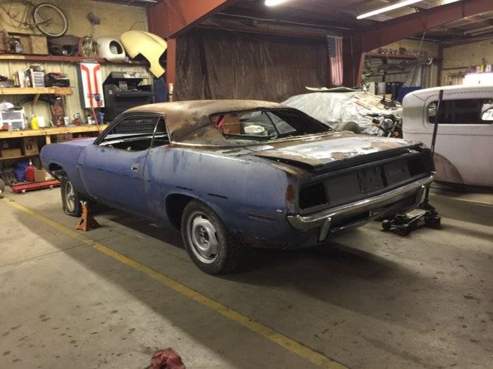

I picked this up a couple weeks ago:
1970 Plymouth Barracuda
383 HO 4-bbl (don’t have it, unfortunately)
4 speed with pistol grip
8 3/4 posi rear end
B5 blue with a white vinyl top
White interior
Air Conditioning
Manual steering and brakes
The plan:
Full restoration-ish. Some upgrades here and there, but I want to keep it looking stock. Especially the color combo, which I think is beautiful.
I have a 440 6 pack to build and put in it. I plan on keeping the flat hood if the 6 pack setup fits underneath.
I am a student at McPherson College, I hope to have this car at least in paint by my senior year. We have a big car show on campus at the end of each year, so that is my goal.
Thanks for any advice you have along the way! I’m learning through this experience while also learning in classes, so bear with me on some of it.

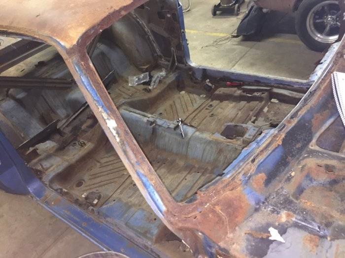

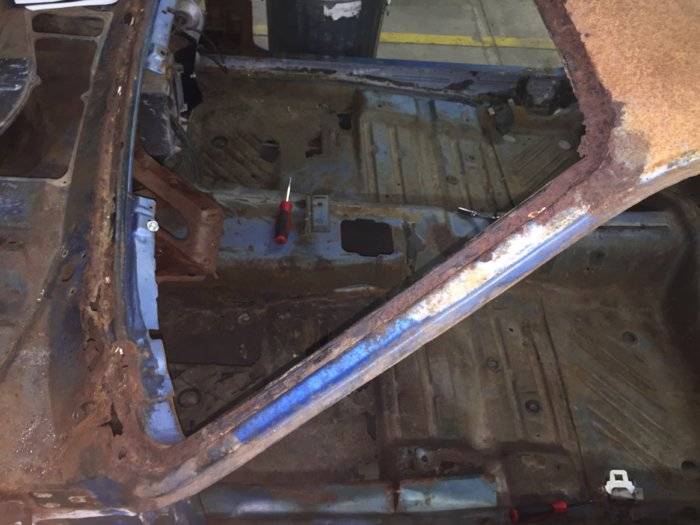

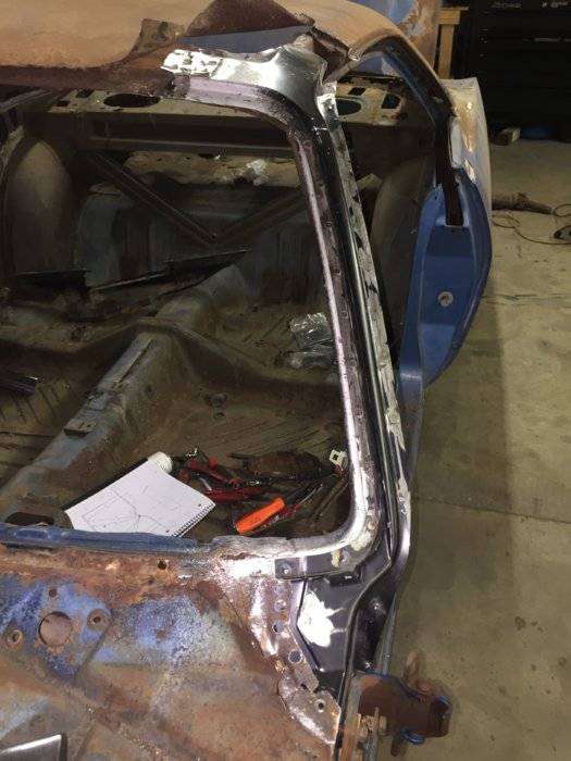

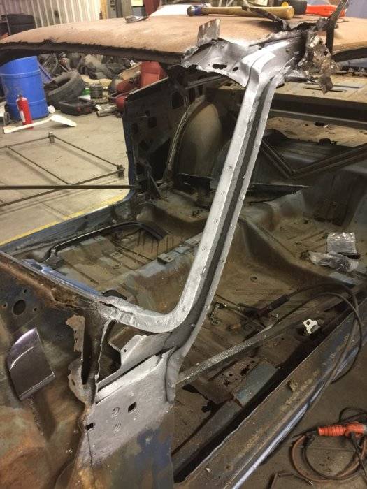

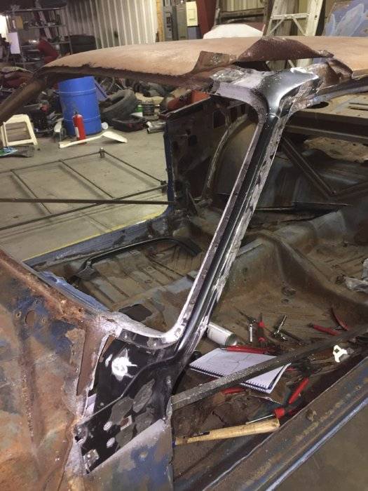

So far I have gotten it all cleaned up and started on A-pillars. I have gotten the left pillar done. The way I did it wasn’t definitely not the easiest...any advice? I wanted go avoid pulling the roof skin for structural reasons, and the drip rail and roof rails are both rusted so I figured I would cut those and the roof around the pillar to make it easier to install it.
It turned out pretty good, just was not the easiest process. Any advice before I tackle the other side would be amazing.

Good job on the A pillar; I would pull the roof skin, and drip rails; easy to drill out the spot welds along the drip rails and window openings; I don’t think the skin has much structural strength. Then you can treat the rust on the inner structure. AMD (auto metal direct) makes an excellent roof panel. I’m sure some of the regulars are tired of my photo album, but I think pics 125 to 135 may be helpful to you.
