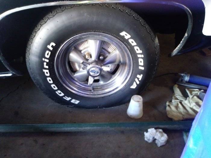

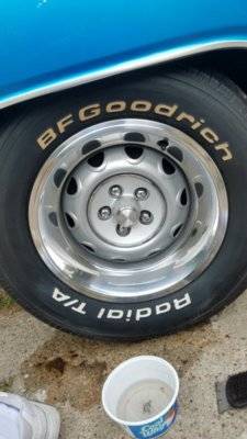

I was able to file a claim w/BFG and they took 40% off a new pair of T/A's because of the browning that effects the lettering.... I used everything from brake cleaner to sand paper to Mr Clean pads and they would a vanilla-ish white but that's about it...then they just get darker from there. View attachment 62838
The 255/60-15's on the rear of my Swinger do that and the fronts never did. I contacted BFG and they suggested I contact a local dealer to get them adjusted. They know there is an issue.
Try carb spray or brake clean. It helps but the discoloration will come back. I have tried absolutely everything else. Acetone works pretty good as well but it's not a permanent fix. Like I said, the rears did it and the fronts never did. It's a defect in the tire.

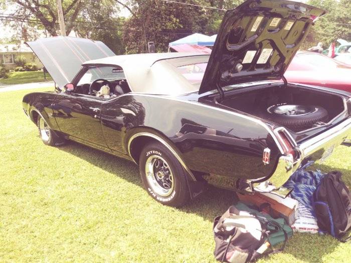

As far as the yellowing letters has anybody tried a Mr. Clean magic eraser?? These things are magic...I have set of these tires on the Duster and the letters look yellowish...I'm gonna try the magic eraser....
Yes but doesn't work... It comes from inside...it's a Michelin thing. I see F250's w OWL Michelin's and there just as bad but my neighbor has 25 yr old T/A's that were
obviously made differently back then also thr Goodrich tires but like the Jetzon's above there as white as snow. These new ones are already not 'white' but too early to tell if I'll have the same problem til I scrub them....

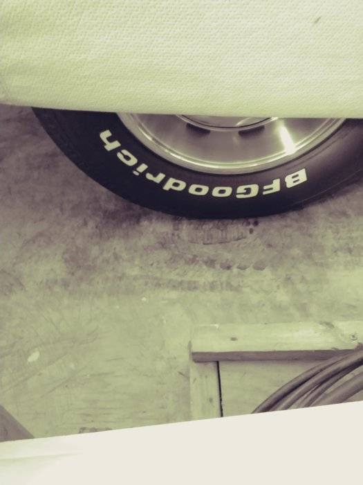

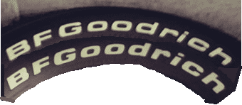

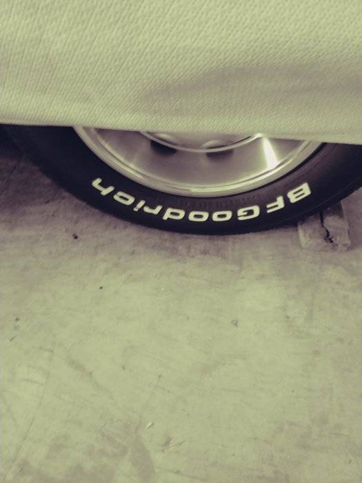

Got the new tires and was warned that they may not match lettering wise and looks like that's the case. As mentioned before new tires made in different plant... There ever so slightly larger...seem to measure the same down to the millimeter but somethings just not right... 2nd pic are new 2019 tires
Yes, definitely a difference. Subtle, but obvious.
Every letter is off.
