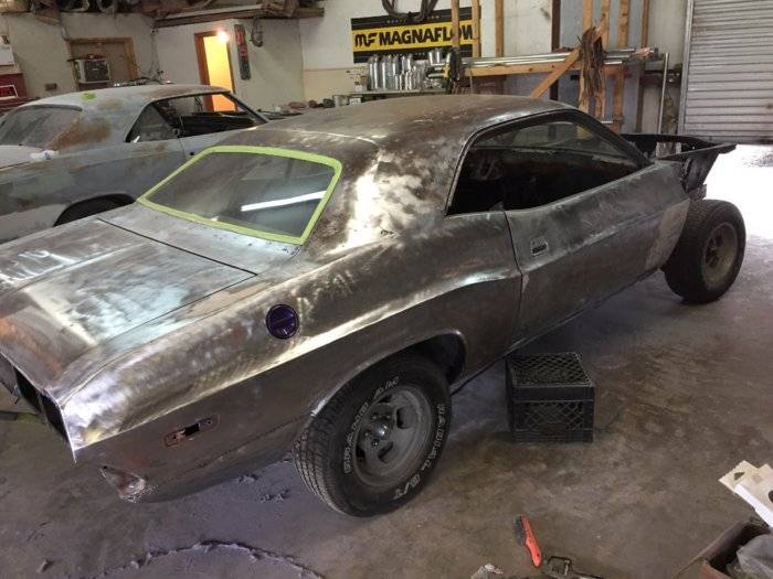

I have a 73 challenger rallye 340 car with 440 transplant. Will have it done in a couple of months...i hope.

Was blue i think. Plum crazy when I got it, I plan to paint it back plum crazy. This was a 340 3 speed. Had it for about five years now and fixing it for my son. 1967 440 .03 over. Just had the engine refreshed with bearings and head work and balanced. EXCITED!!!
