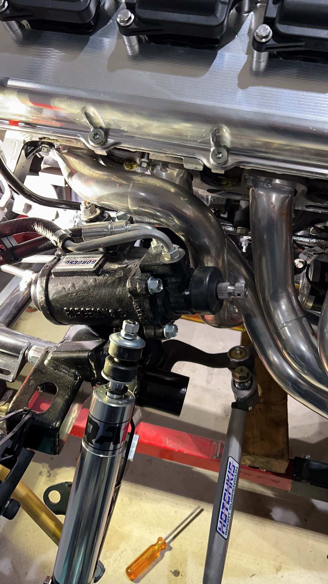

I have it on my restomod. Can't say enough how different for the better it feels when driving. I used the Holley PS pump for the Gen 3 Hemi. It all works great and looks amazing as well. And, looks really good also.:)
