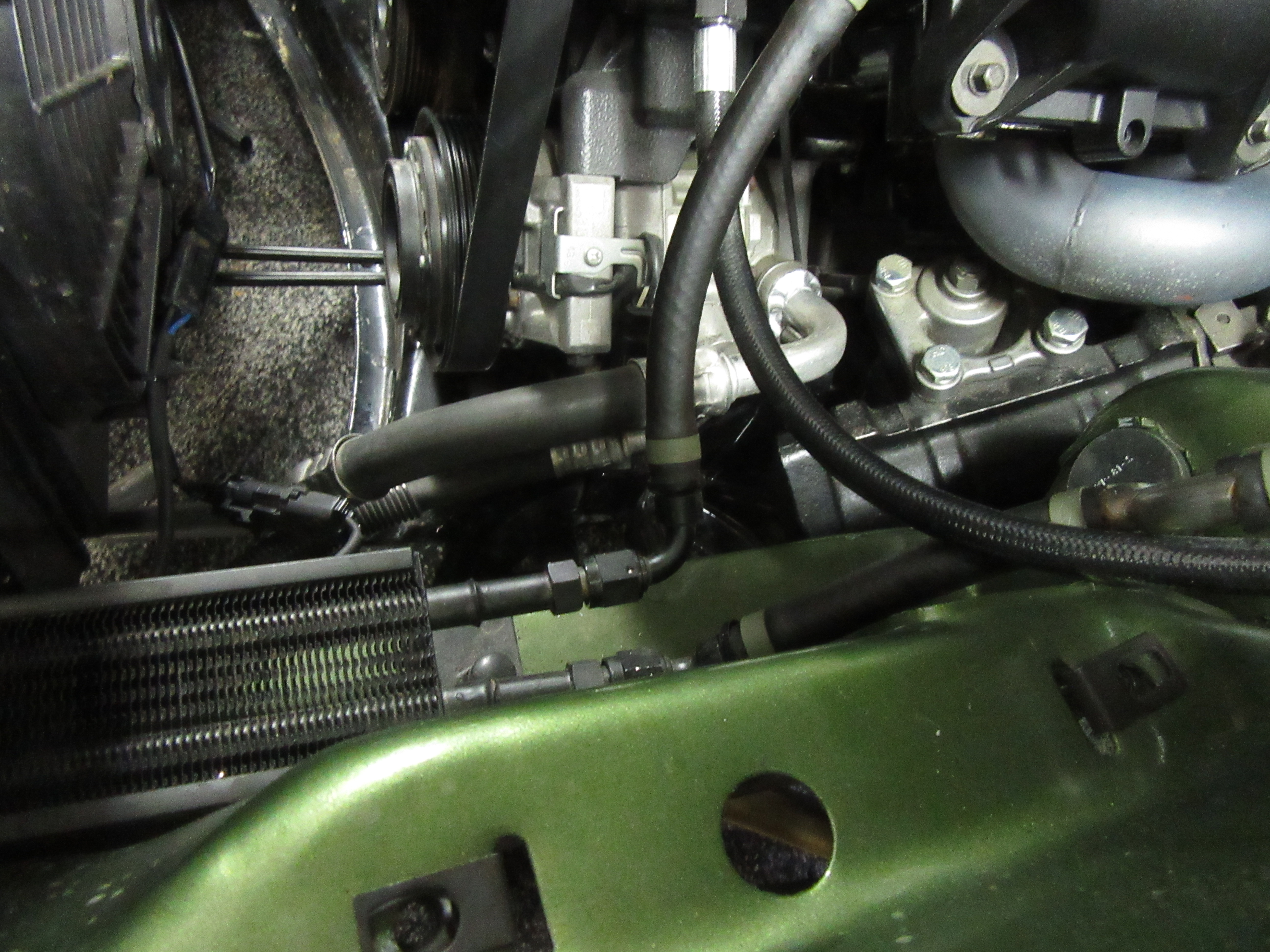

Thank you everyone. I just ordered #800127 conversion kit with the VJ coupler, Hose kit, Saginaw PS pump w/ pulley and the PS pump bracket. Do I need the PS cooler kit they show on the Borgenson site? Did I miss anything?

I have not yet found a vendor that makes a hose kit from Federal pump to Borgeson box. Saginaw yes, but not Federal

I purchased adapter fittings of Peter Bergman and used my stock hoses - both the supply and return.

Haha, I never thought about adapter fittings, such a good idea and you keep the stock appearance at quick glance till you see the box. I went with black -AN fittings and PTFE hoses, maybe I’ll change them out later to the rubber 👍
