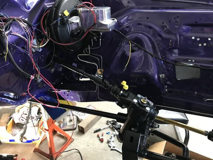

Hey DrEamer, We bolted one in and fit is perfect. Be sure to follow the instructions completely. It provides a bunch of room for header clearance, one of major reasons I went that direction. I have yet to fire up the Cuda, still working on all the details. Good luck with the project.
I have 1 in a 71 Cuda for seven years and love it. Makes car steer like a new one, because no more slop.

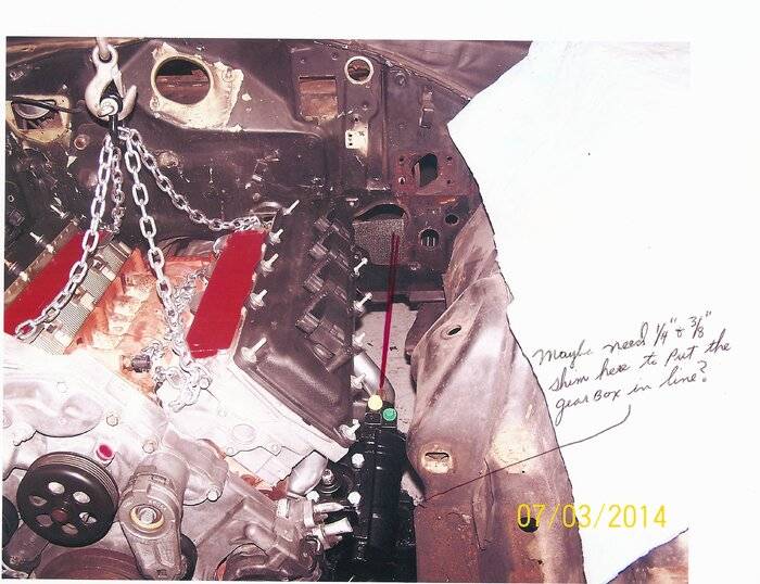

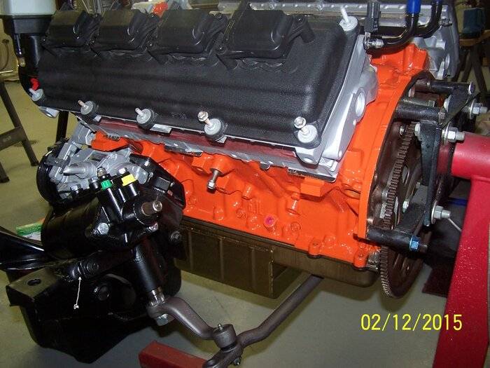

I'm happy with mine also. Only problem I had was the mounting ear they added to fit our old iron seemed to have the gear pointed outward and not lined up with the column. Probably would have worked ok but I ended up adding a 1/4" spacer to make it line up the way it should. They more than likely made it that way to help clear the exhaust headers or something. I brought it to their attention but was told to add the spacer if needed. Here are a couple pics. The white arrow shows the added spacer. Good luck with your upgrade. You will appreciate the improvement.
