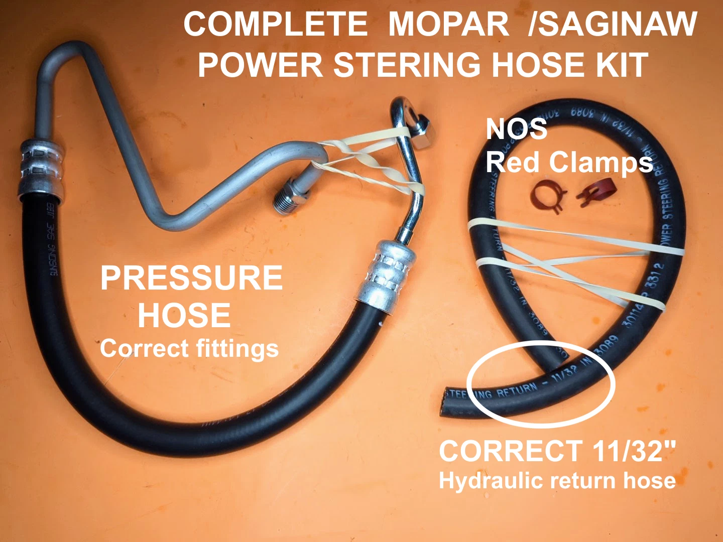

just installed the Borg. box and pump. my OEM pressure hose does not fit, to long. is there a off shelf hose that does or, do I have to get one from Borgeson

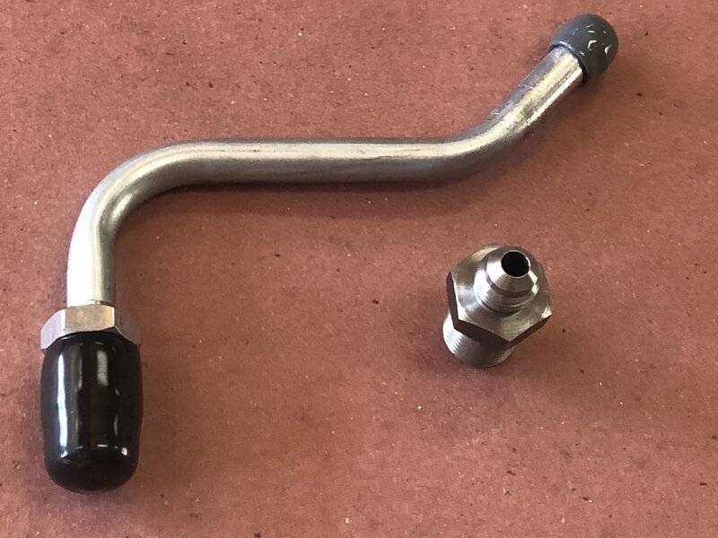

return hose is no problem, it's the pressure hose that is a problem. question. two fittings. upper right and lower left.on the steering box. which is the pressure fitting----no instructions of any kind in the shipment
You did buy your Borgeson box from Peter at Bergman Auto Craft and got his kit with the proper fittings he machines, didn't you? If not, give him a call.
(516) 384-6438
i've installed 2 of them, no issues, Peter is a good guy you can solve it with a call and a credit card. I got a full kits with pump and hoses, all new is good, then its over, usually.
