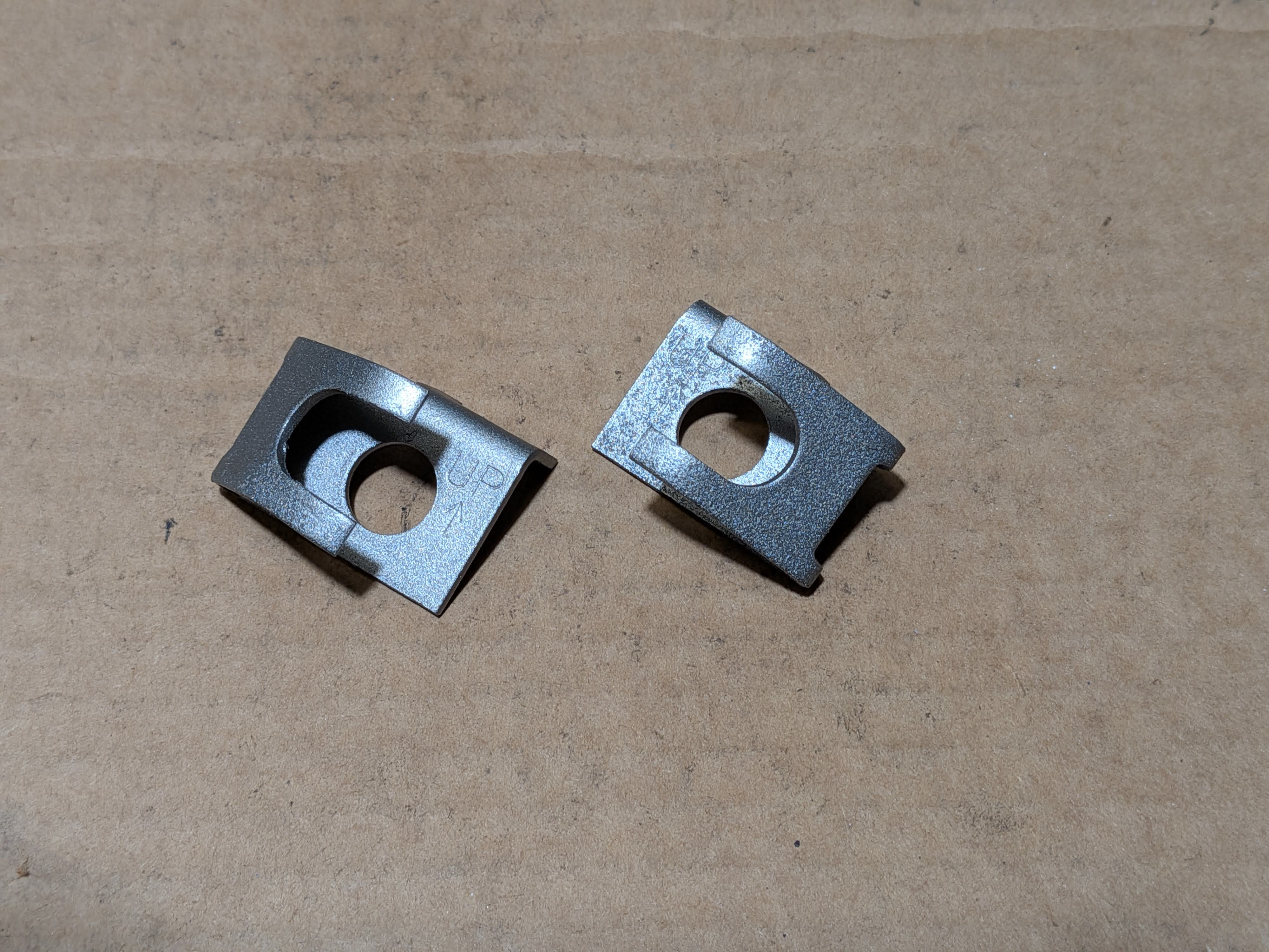

The following image shows the 1969 - 1970 positioners, part numbers 2944722 and 2944723:
The 1970 positioners have a raised area around the hole.

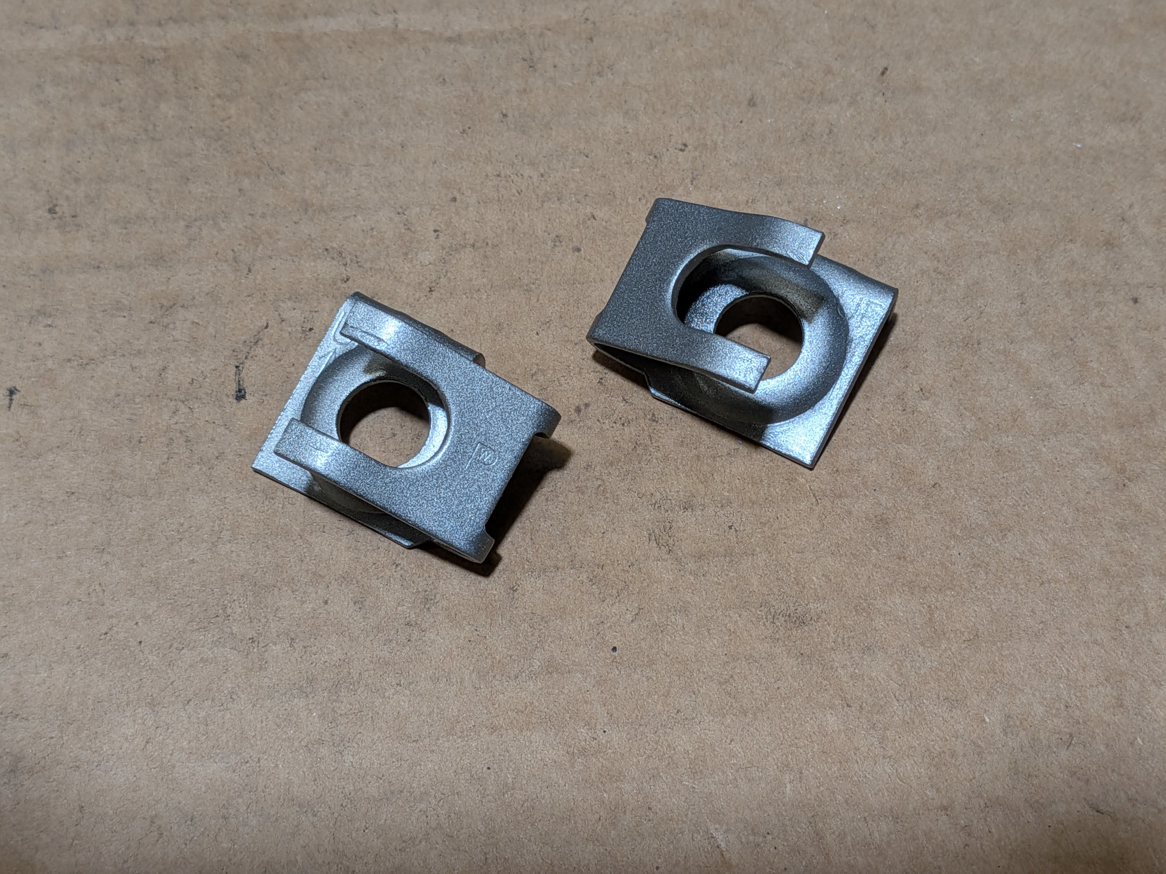

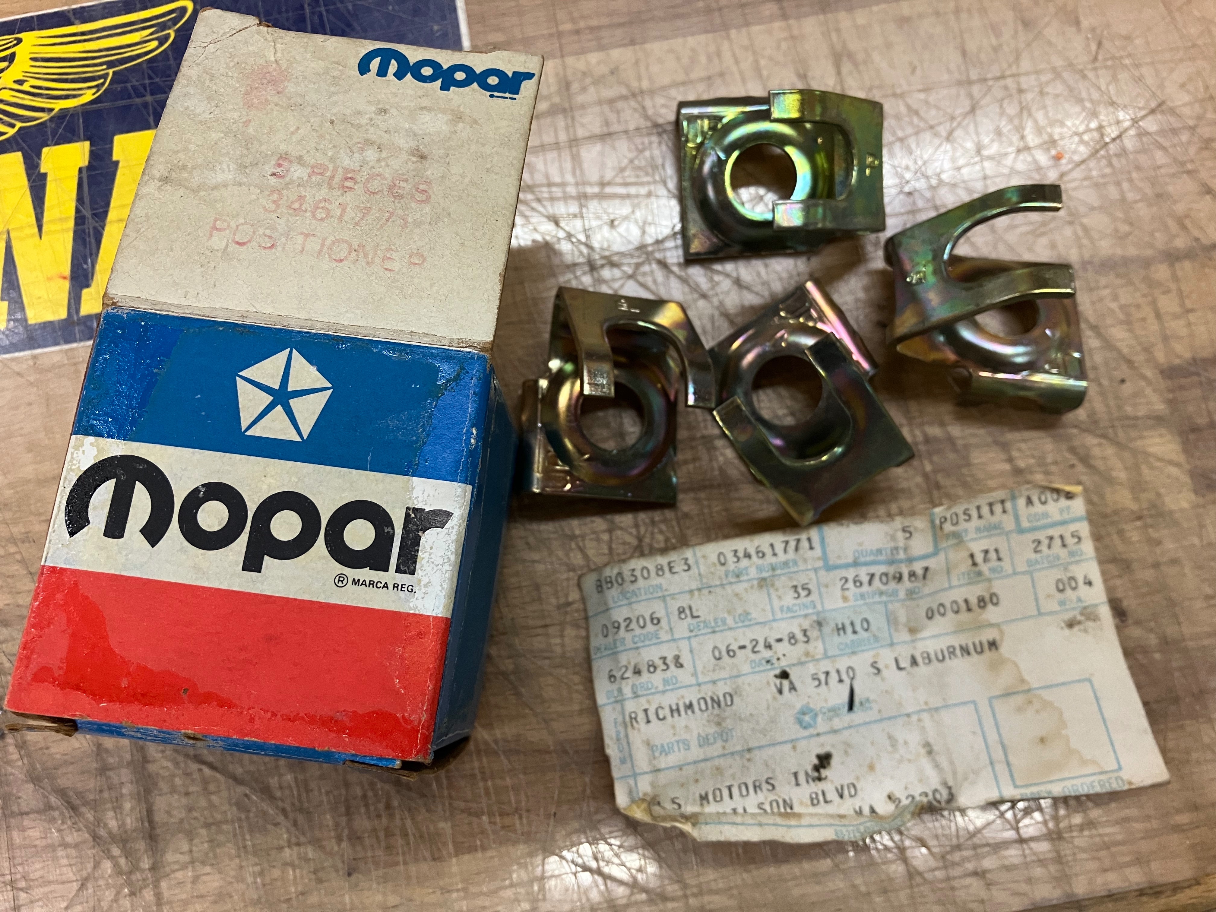

The following image shows the 1971 - 1972 positioners, part numbers 3461770 and 3461771:
The 1971 - 1972 positioners do not have the raised area around the hole. This style is also what was, and is, available as most aftermarket or reproduction parts. The later style can substitute for the earlier style.

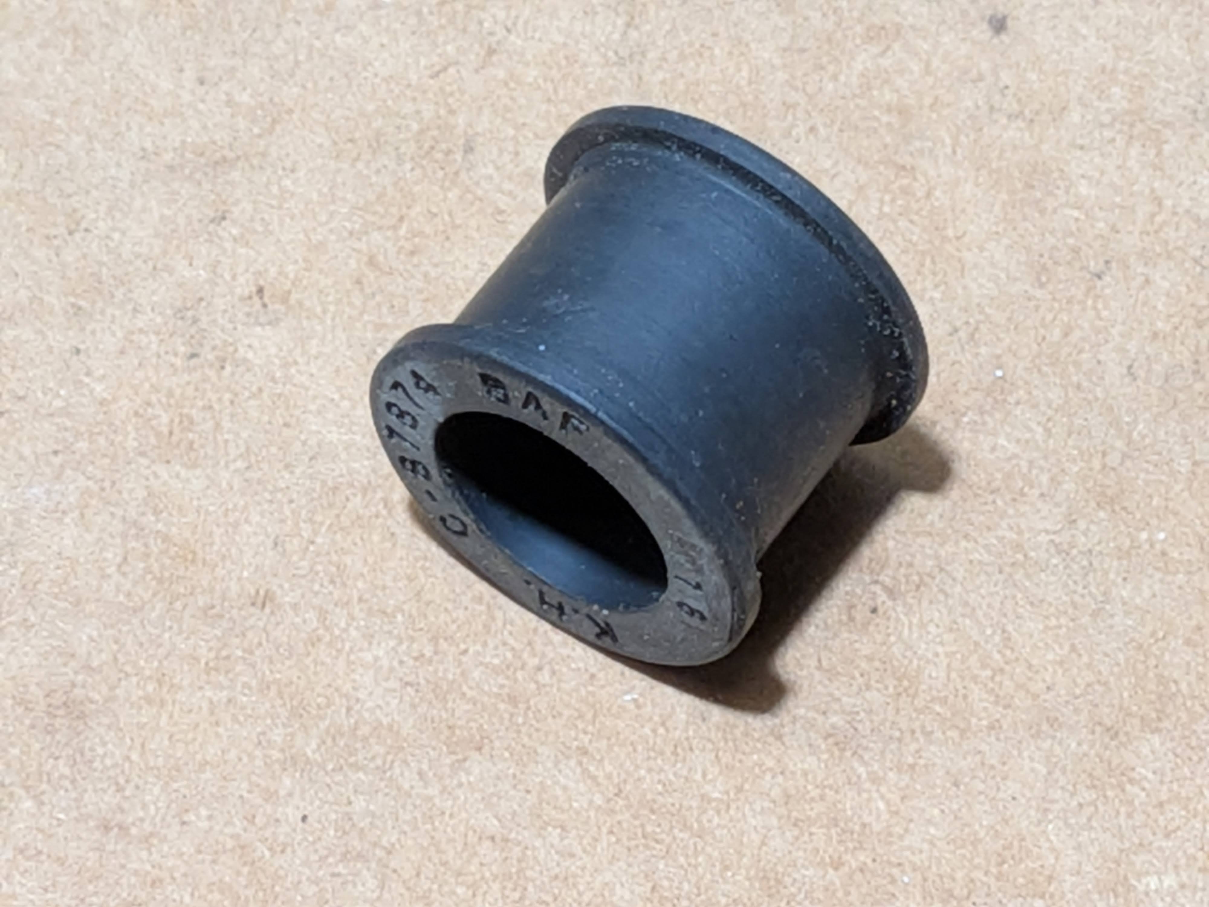

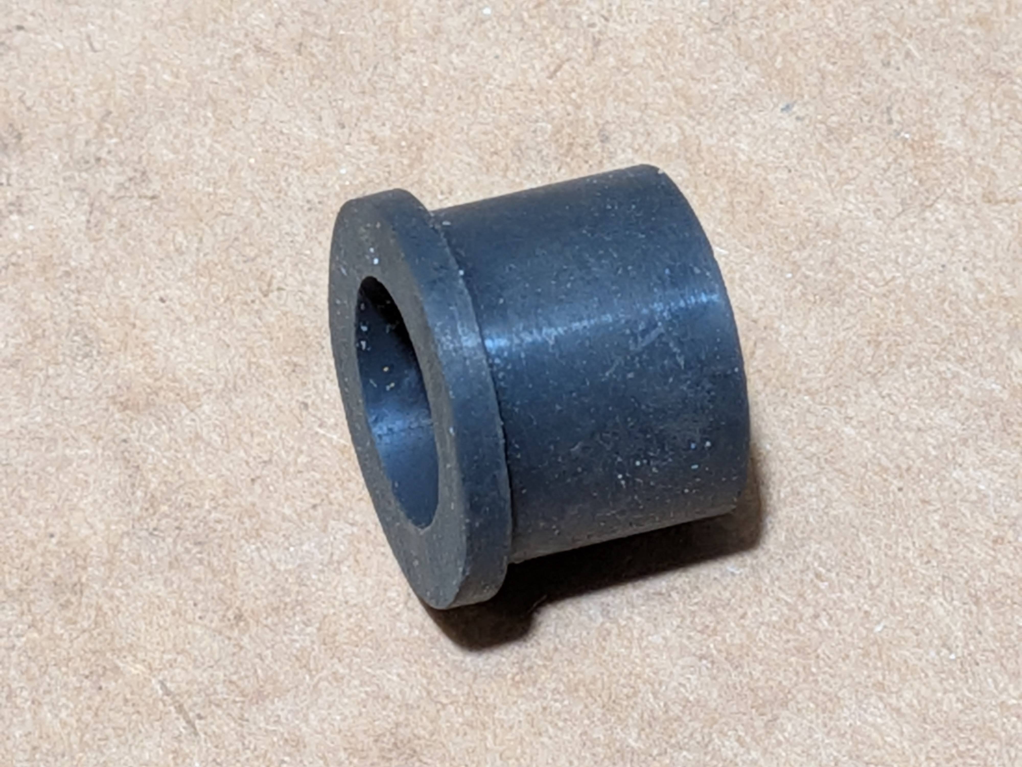

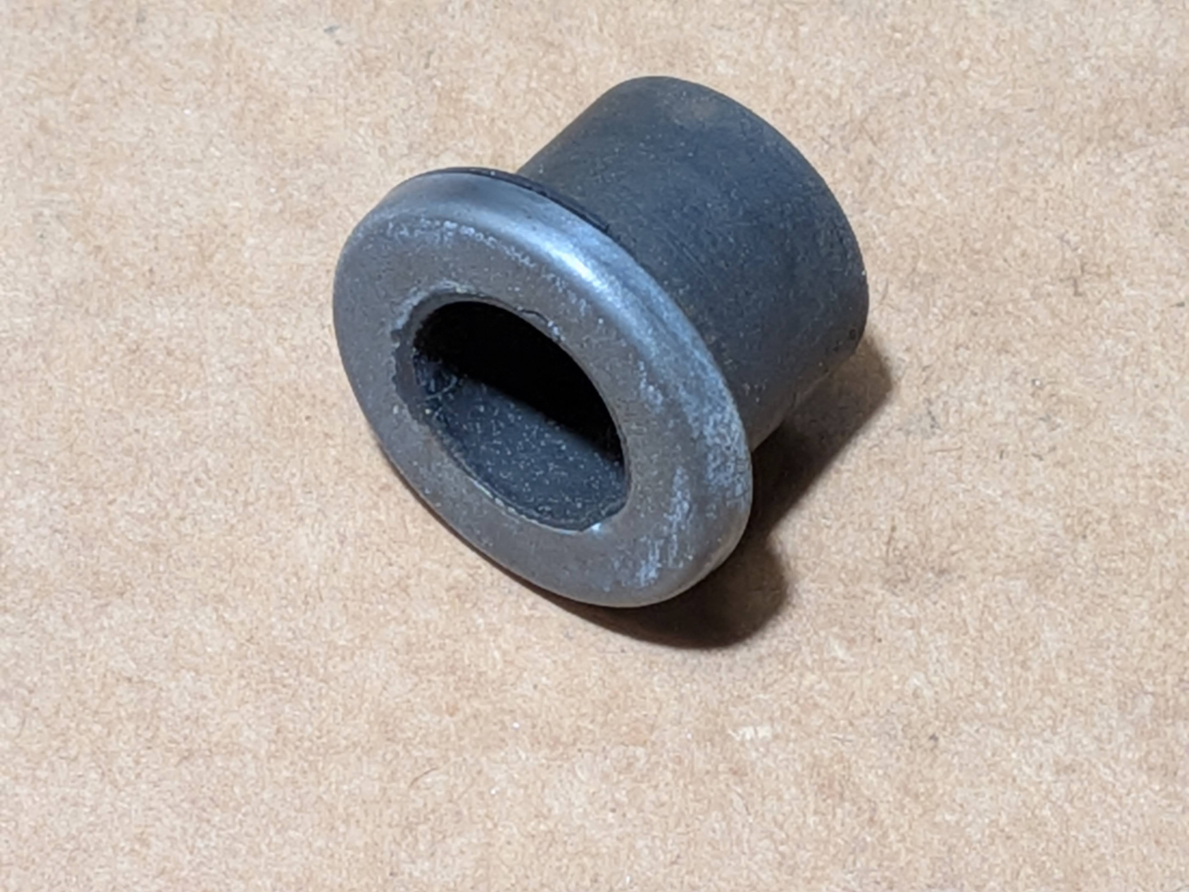

The following images show the 1969 - 1972 original type single lip bushing with the metal cap, and aftermarket version of the single lip bushing and a 1973 and later double lip bushing:

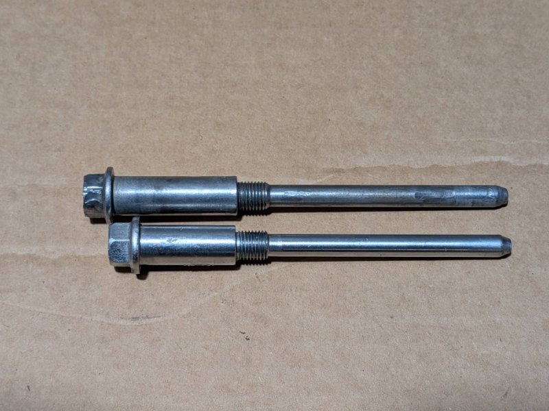

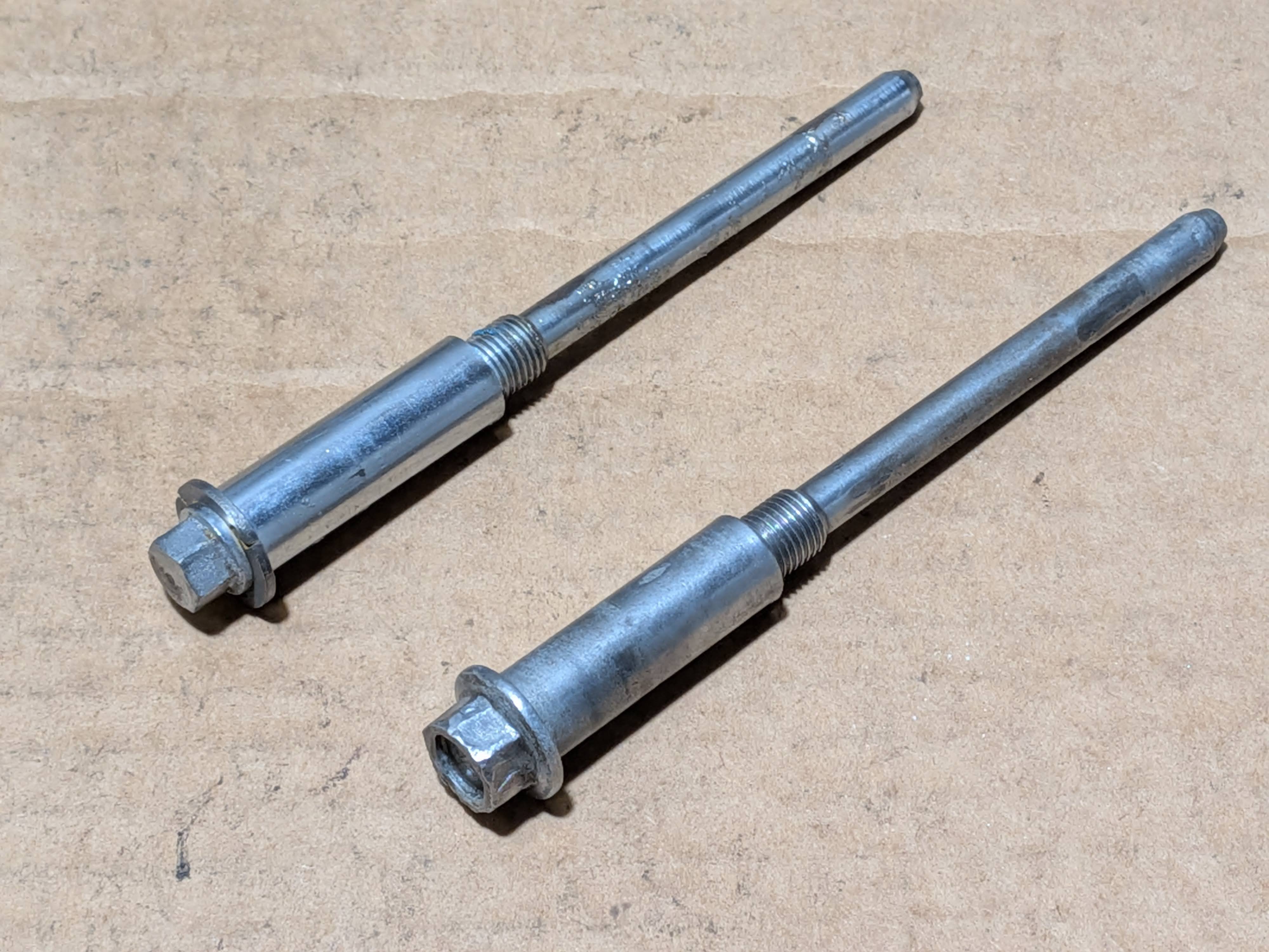

The following image shows the difference between the long shoulder and short shoulder pins:
The long shoulder is 1-17/32" long and the short shoulder is 1-5/32" long. The remainder of the pin and the threads are the same.

The later bushing and shorter pin can be used in the earlier calipers, and the positioner is not used in this case. Running the later pin and bushing as replacement for the earlier setup is acceptable and a customary service replacement. The earlier pin can be also re-used without the positioner if the later style rubber bushing is used. The double lip bushing must be used if positioners are not installed.

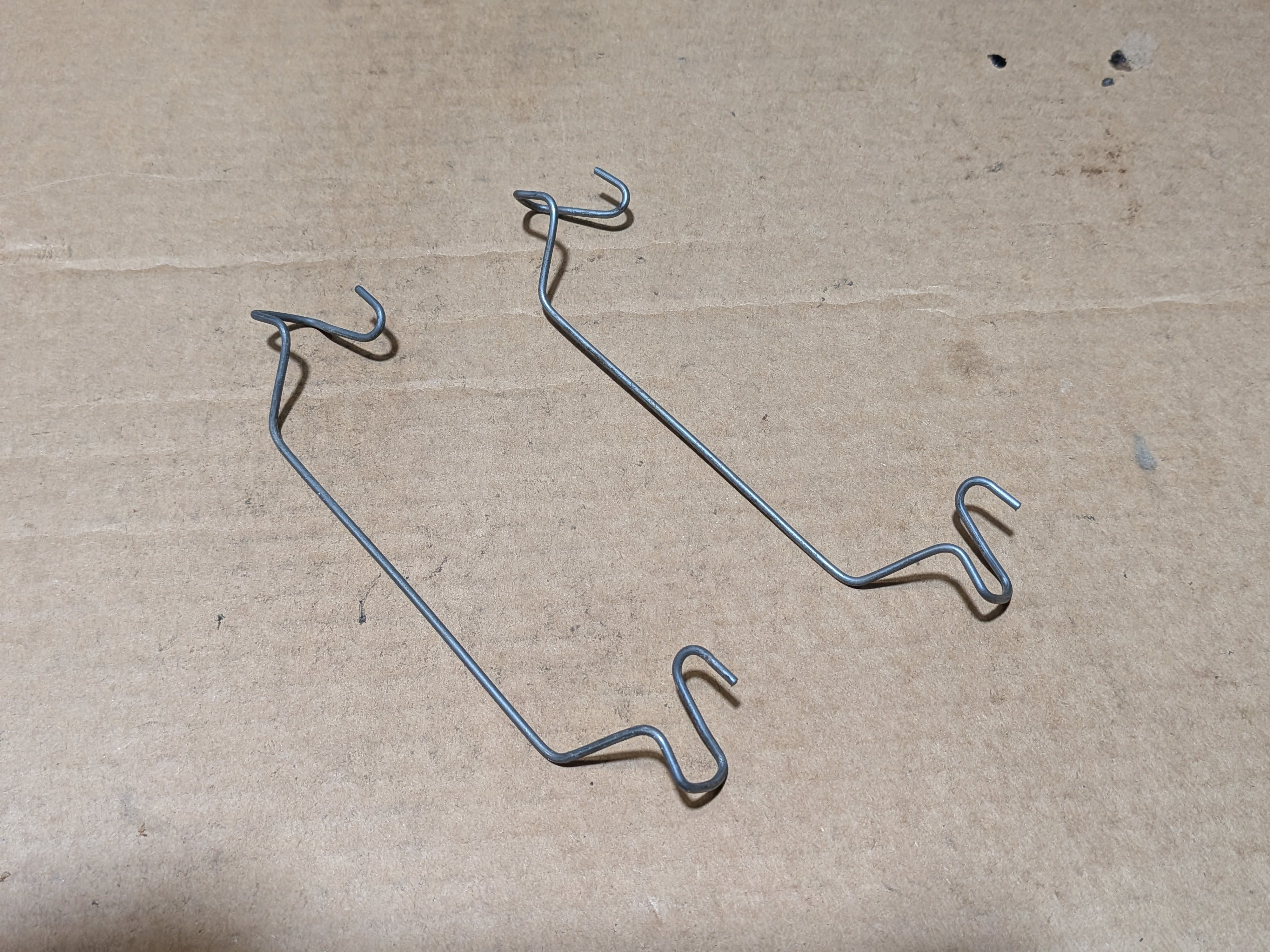

The following image shows the anti-rattle springs, or clips:
