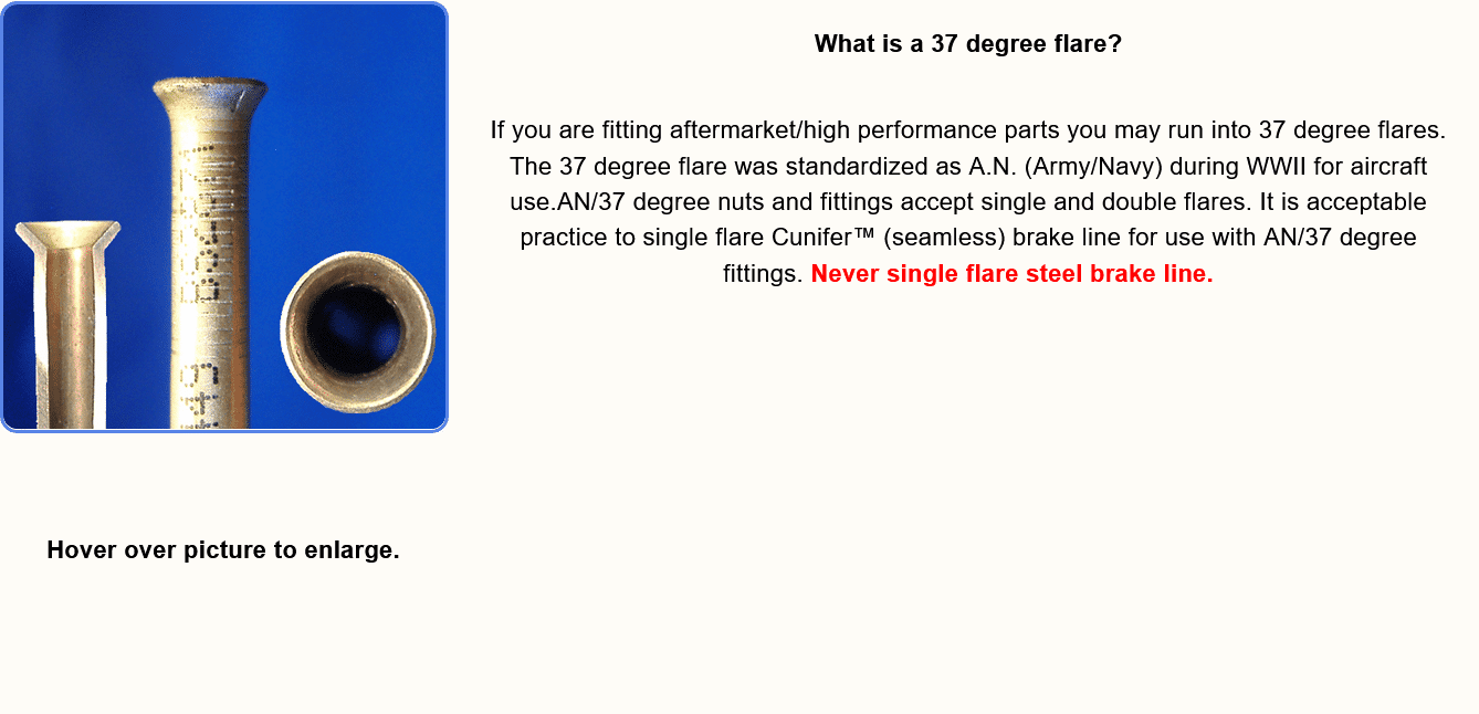

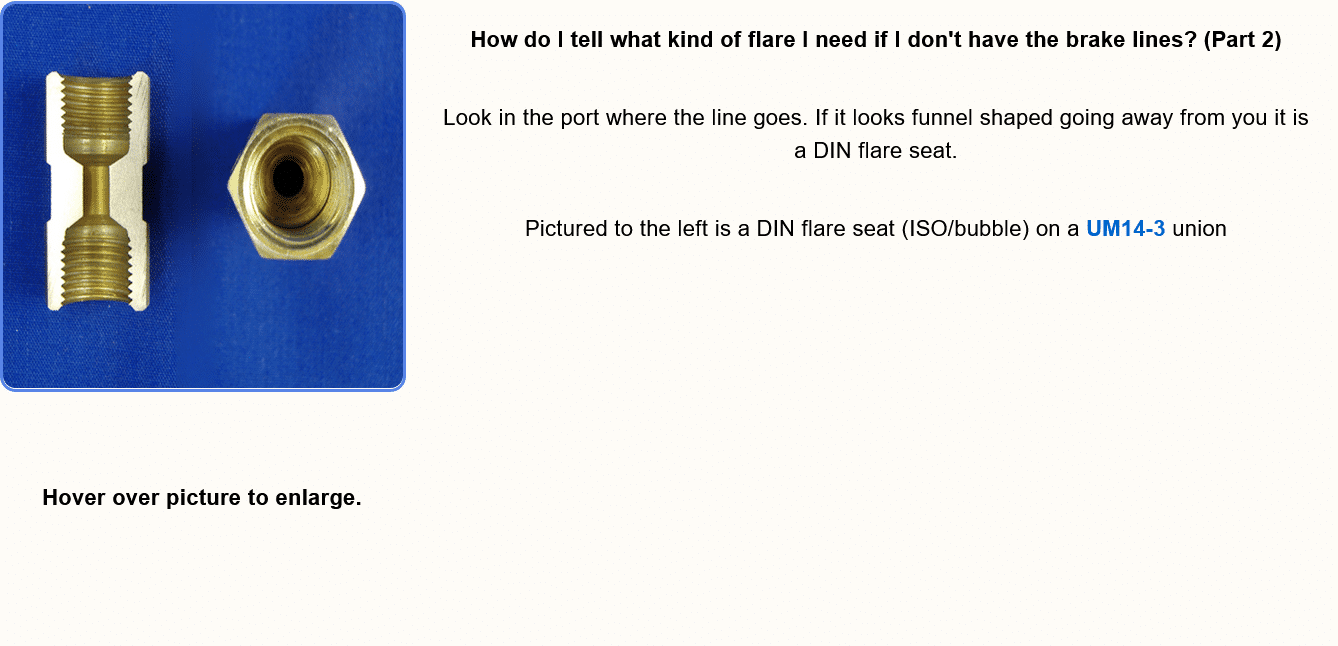

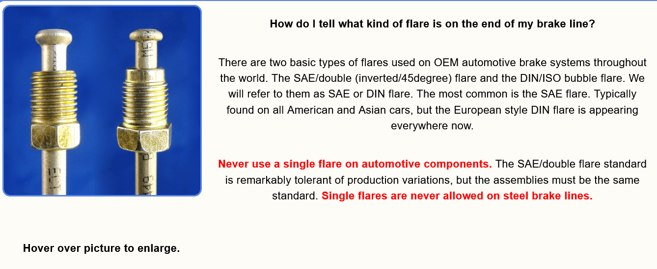

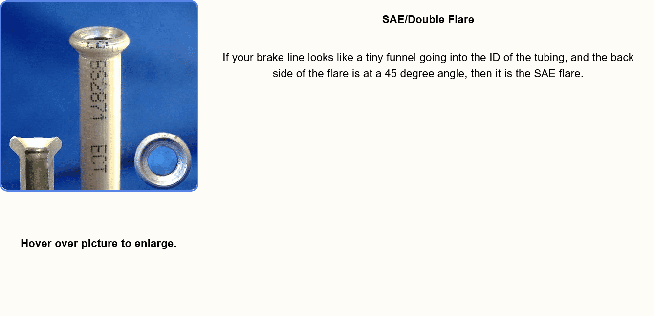

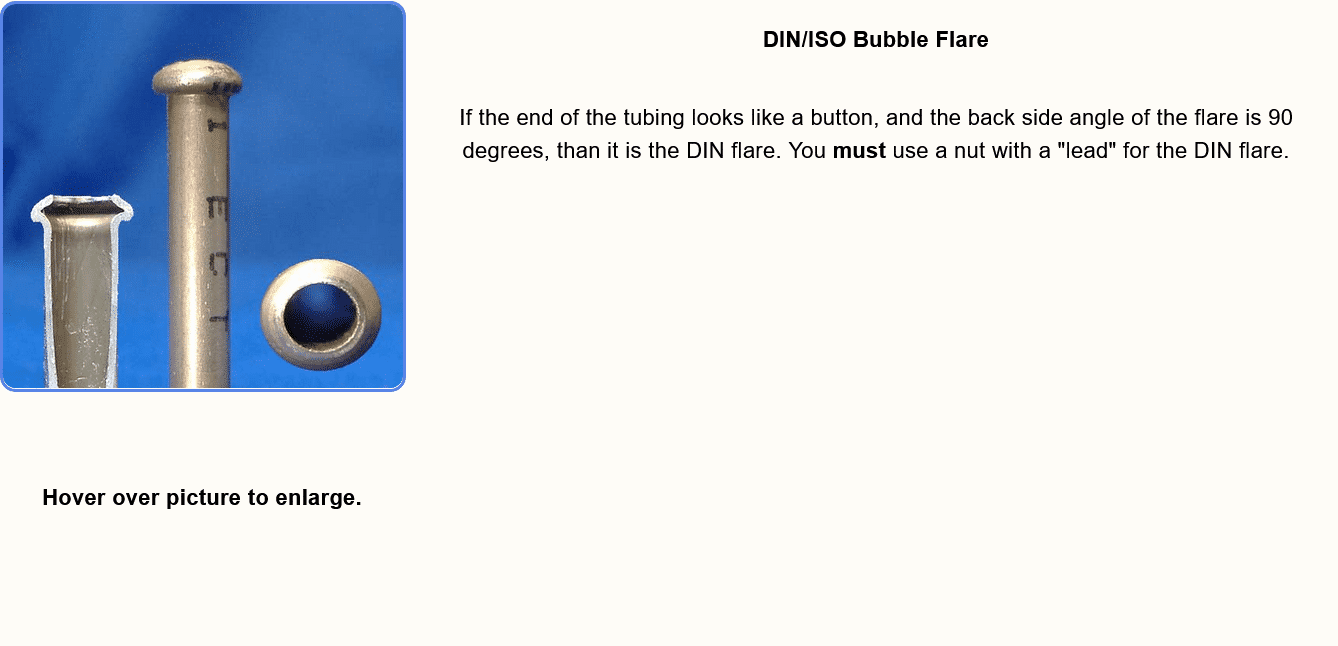

I plan to fabricate my own brake lines ('70 Challenger). This will include lines from the master cylinder to the proportion valve. Do all the brake lines have the same type of end, whether it be a double or bubble flare? Also, is a double flare and inverted flare the same thing?
Thanks much
Remember If you bend your own lines, don't forget the flare nut. :D
Yes. All the brake lines have the same type of end. Double flare and inverted flare the same thing? Yes, and I think they are more reliable then a bubble flair. 99.9% of the time I've seen double flare,bubble flair skipping a step. 25' would be enough for most small or midsize cars. I always have a roll or two around ,for myself friends or family.

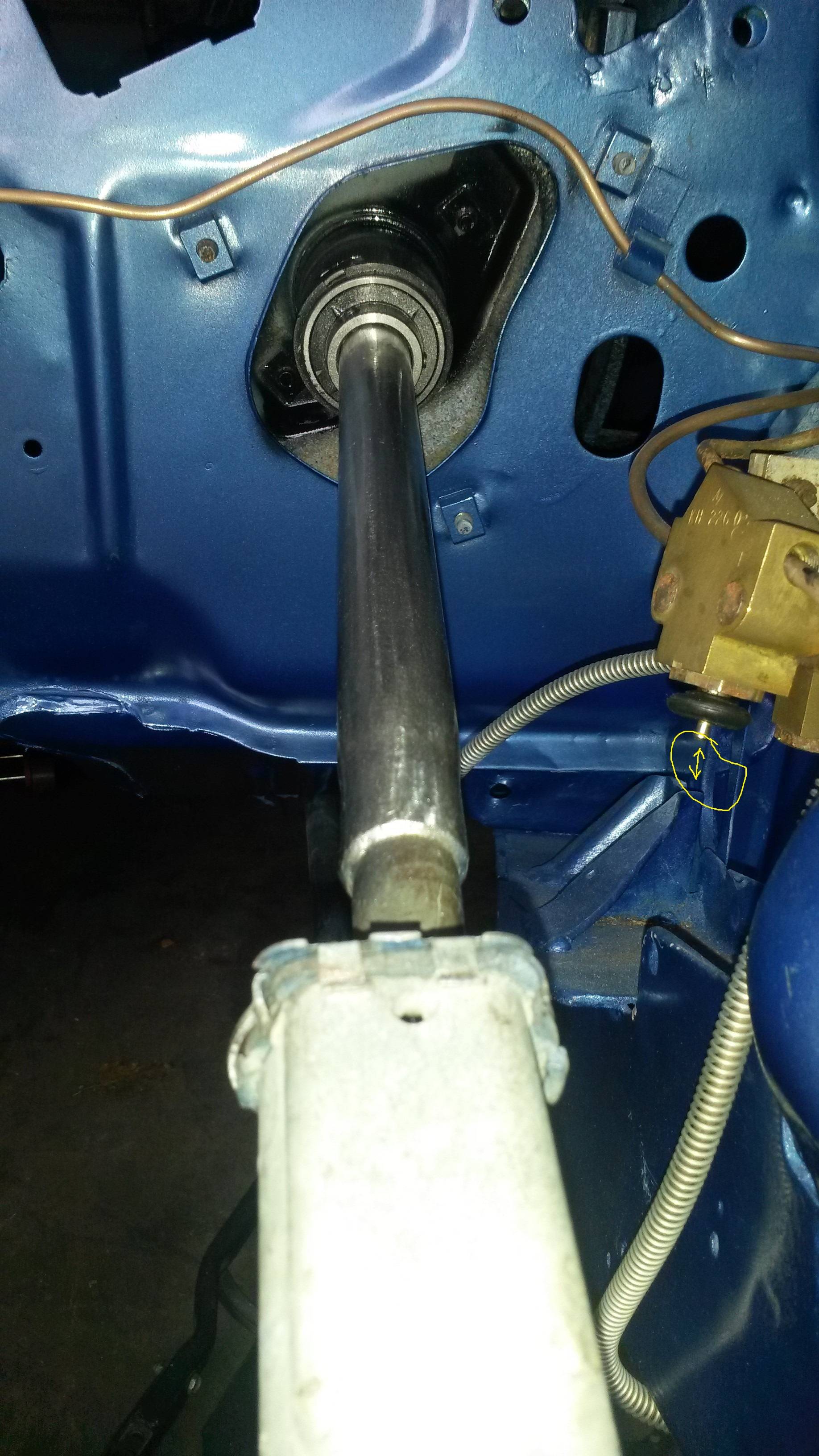

When bleeding reset brake valve if need be.pull out and hold.
