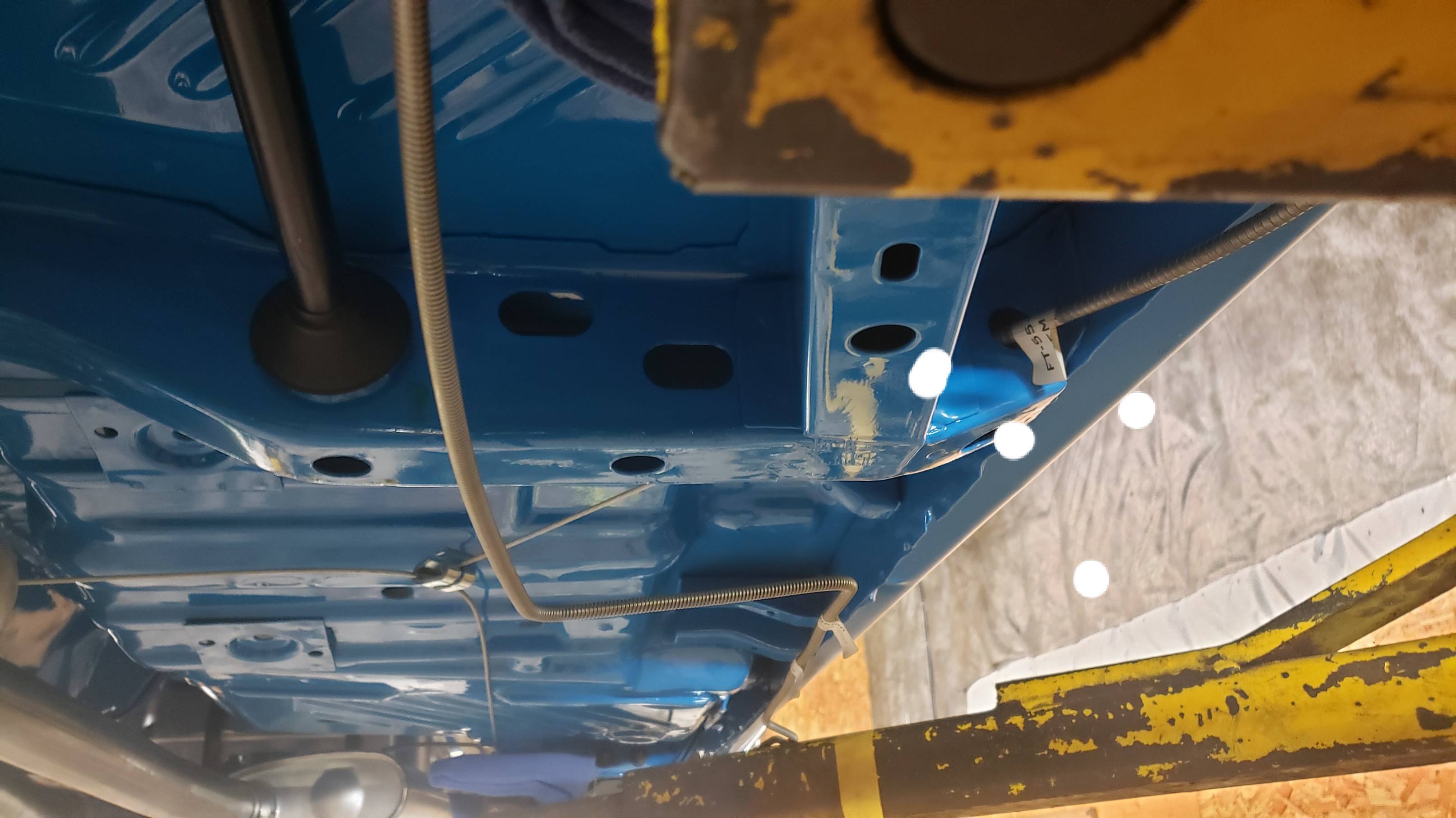

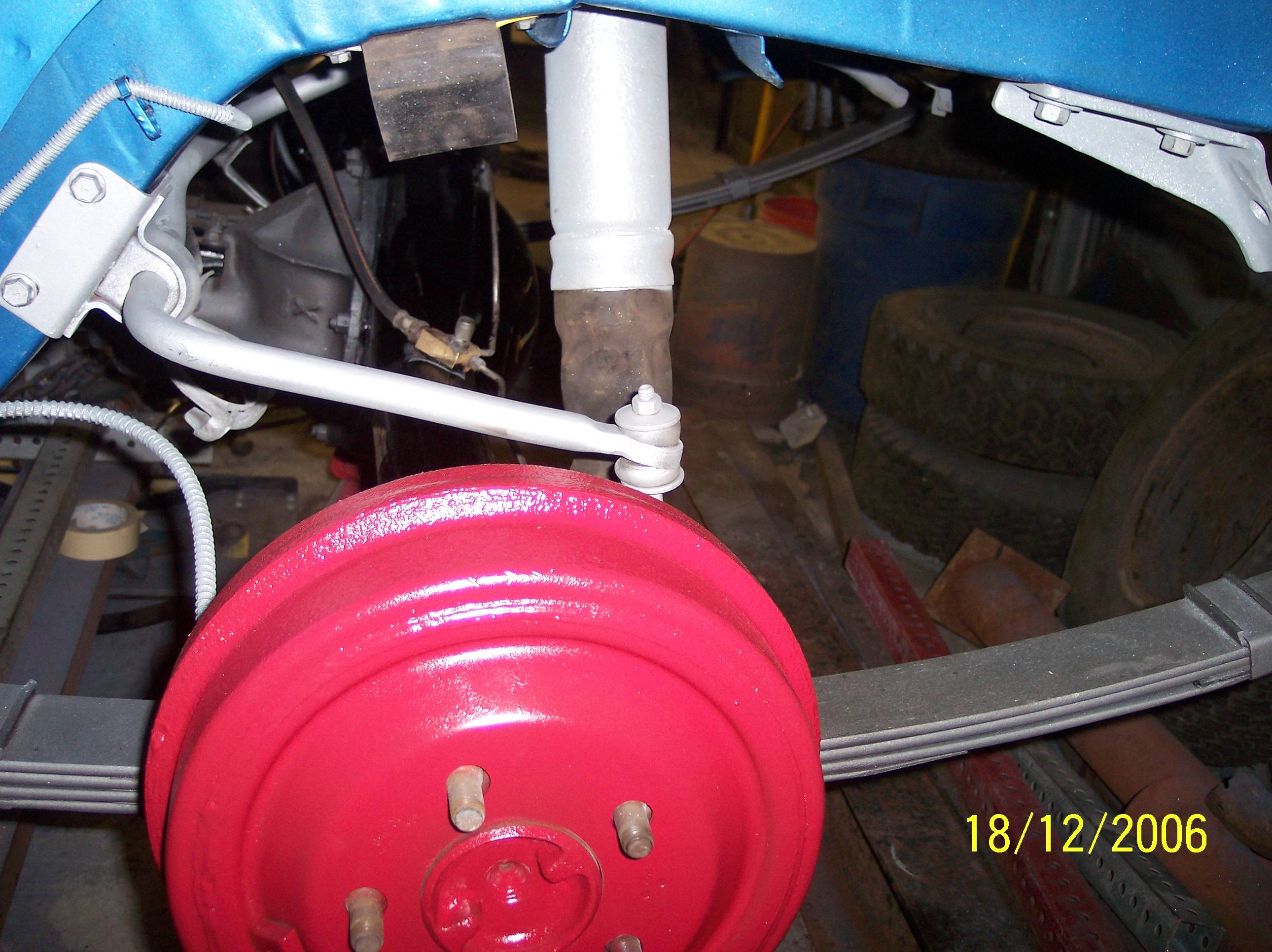

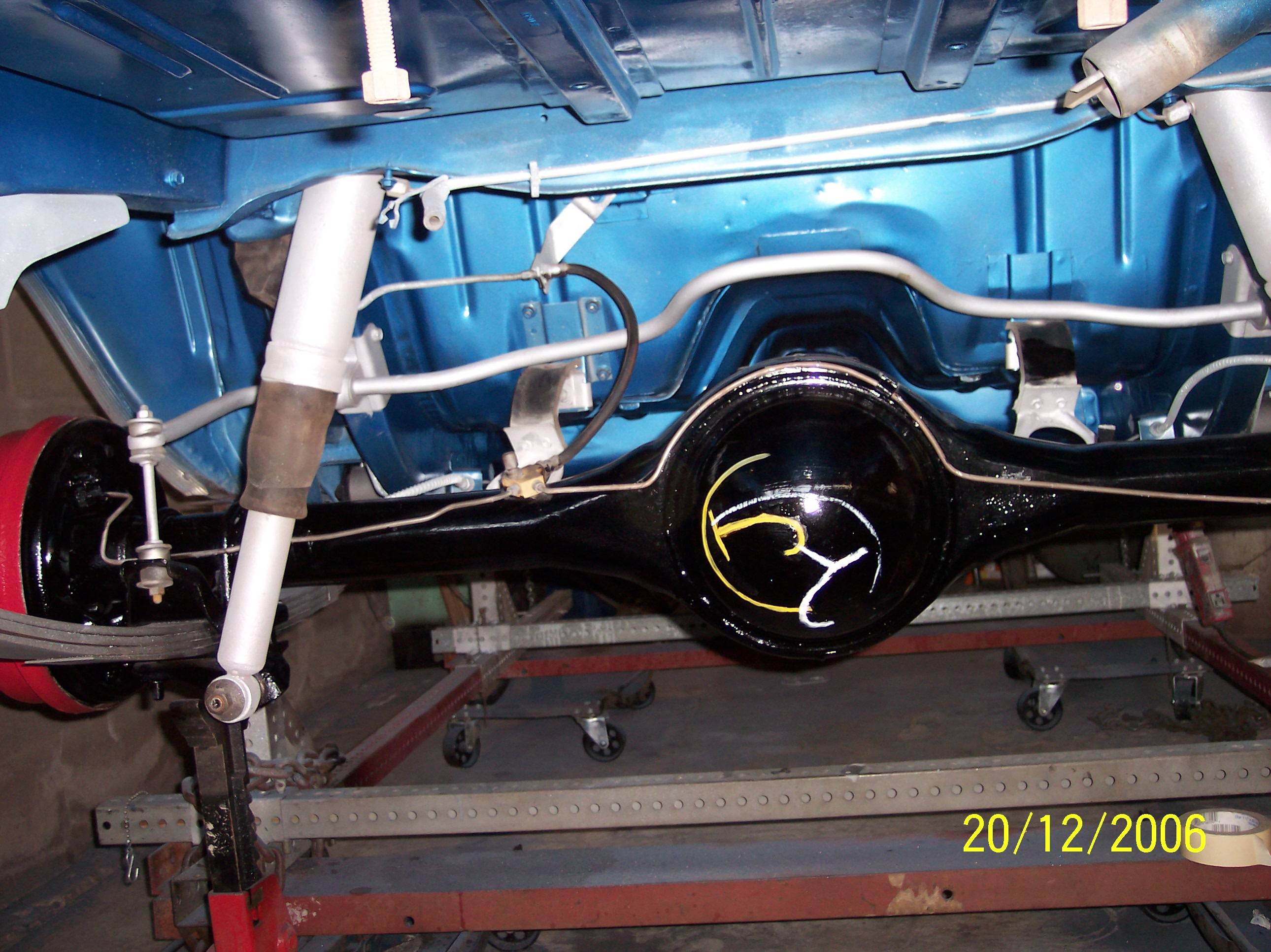

Jun 24, 2021 #1 Barnstormer Member Joined Aug 15, 2016 Messages 11 Reaction score 1 Location Wisconsin United States Anyone know the proper routing of the rear brake line?
Jun 24, 2021 #2 Challenger RTA Well-Known Member Joined Oct 28, 2018 Messages 4,273 Reaction score 2,309 Location PA Flood city Here's the back to start. I'll look for or take more pictures. Attachments 20061812_2289.JPG 455.6 KB · Views: 530 20062012_2304.JPG 459.9 KB · Views: 1,926

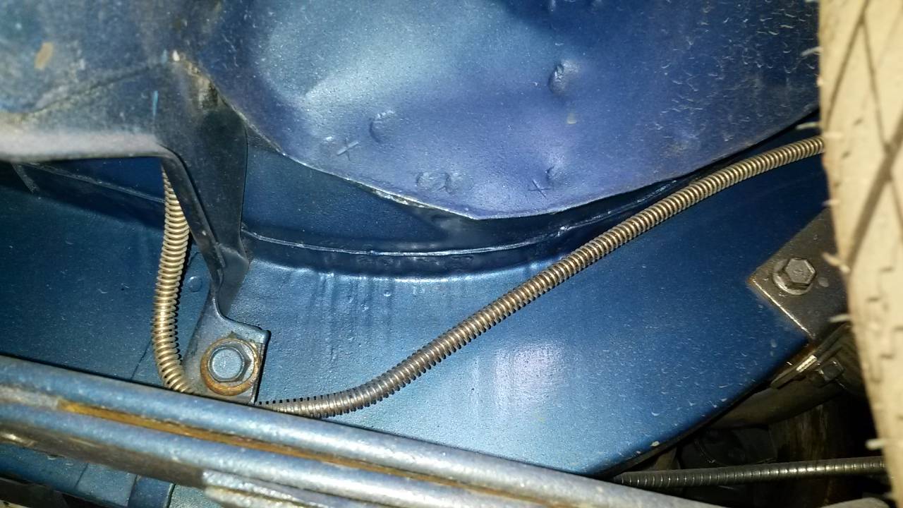

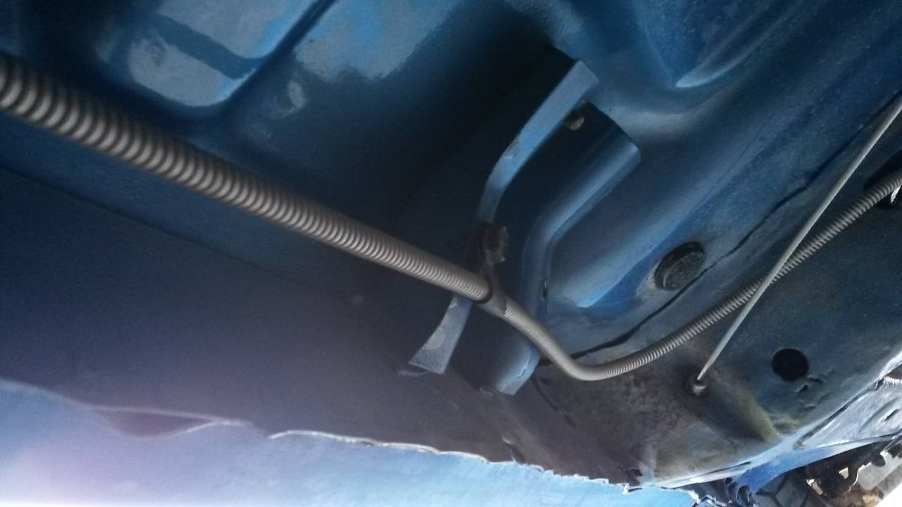

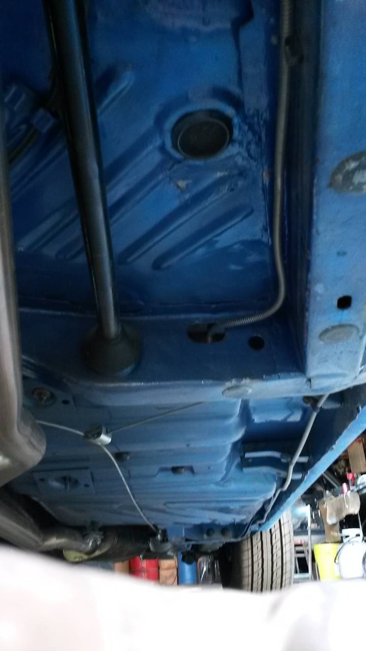

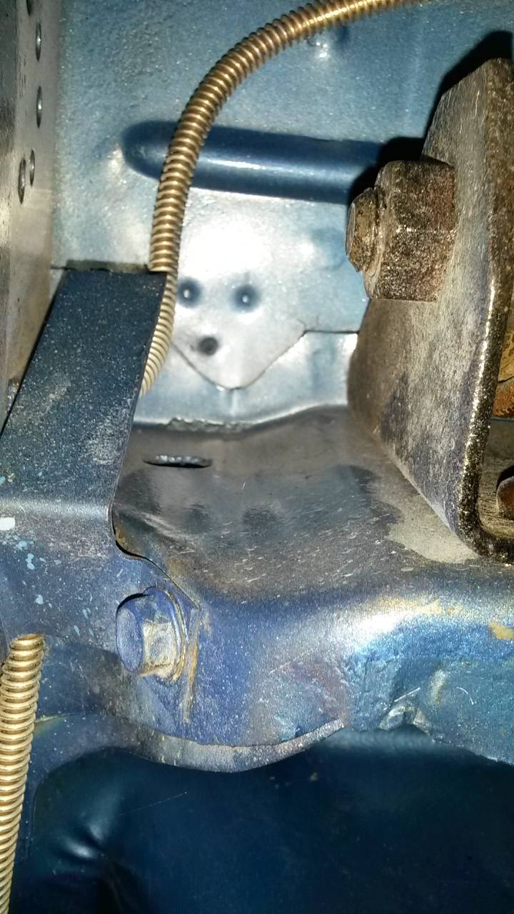

Jun 25, 2021 #3 Barnstormer Member Joined Aug 15, 2016 Messages 11 Reaction score 1 Location Wisconsin United States Thanks, nice color car by the way. Really need to know if the line is supposed to go through on of those holes in the torsion bar support.

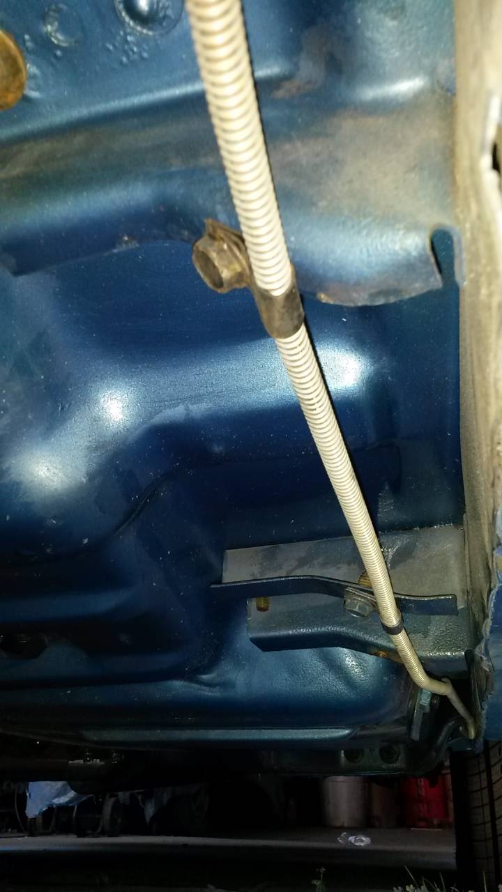

Jun 25, 2021 #4 Challenger RTA Well-Known Member Joined Oct 28, 2018 Messages 4,273 Reaction score 2,309 Location PA Flood city Yes give me a couple minutes.I'll get a picture.
Jun 25, 2021 #5 Challenger RTA Well-Known Member Joined Oct 28, 2018 Messages 4,273 Reaction score 2,309 Location PA Flood city Had original lines on. I used copper nickle line and put the armor over.Before flair! Good luck. Last edited: Jun 25, 2021
Jun 29, 2021 #6 Barnstormer Member Joined Aug 15, 2016 Messages 11 Reaction score 1 Location Wisconsin United States That helps a lot, thanks! Could you possibly have some images of the fuel line? I bought some pre-bent lines and want to make sure it's right.
