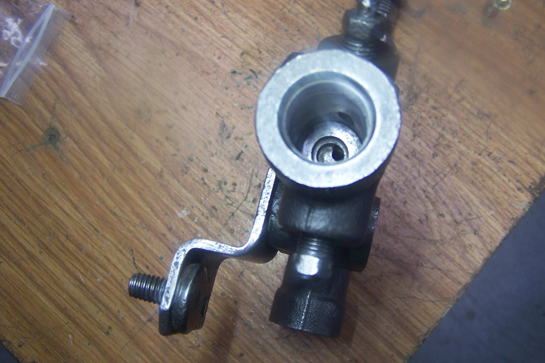

Got the plunger out but now have to get inner piston assembly out. Tried air -didn't budge. which end does it come out ?

That video doesn't show how he got this assembly out--skips right over that part.
Oh....I know it didn't show everything but the part I was talking about was where he plugged a couple of the tubing holes and fabbed a grease zerk into one of them and pumped grease in to push that rubber and spring out. Did you not see that? It was around the 3-4 minute part of the video.
As far as the shuttle valve, Once you get that plunger out along with that little brass hat & spring, there is a small V shaped hole at the bottom. You take a 1/8" long punch and tap it in there. It will push the shuttle valve and the brass seat out the other end. You can see the hole at the bottom of the picture here. It all comes out the other end.
I did see the part getting the plunger out using the grease gun and that is how I got it out. I just didn't know how to get the shuttle valve out. I see how it is done now. Thanks again for the info I really appreciate it
