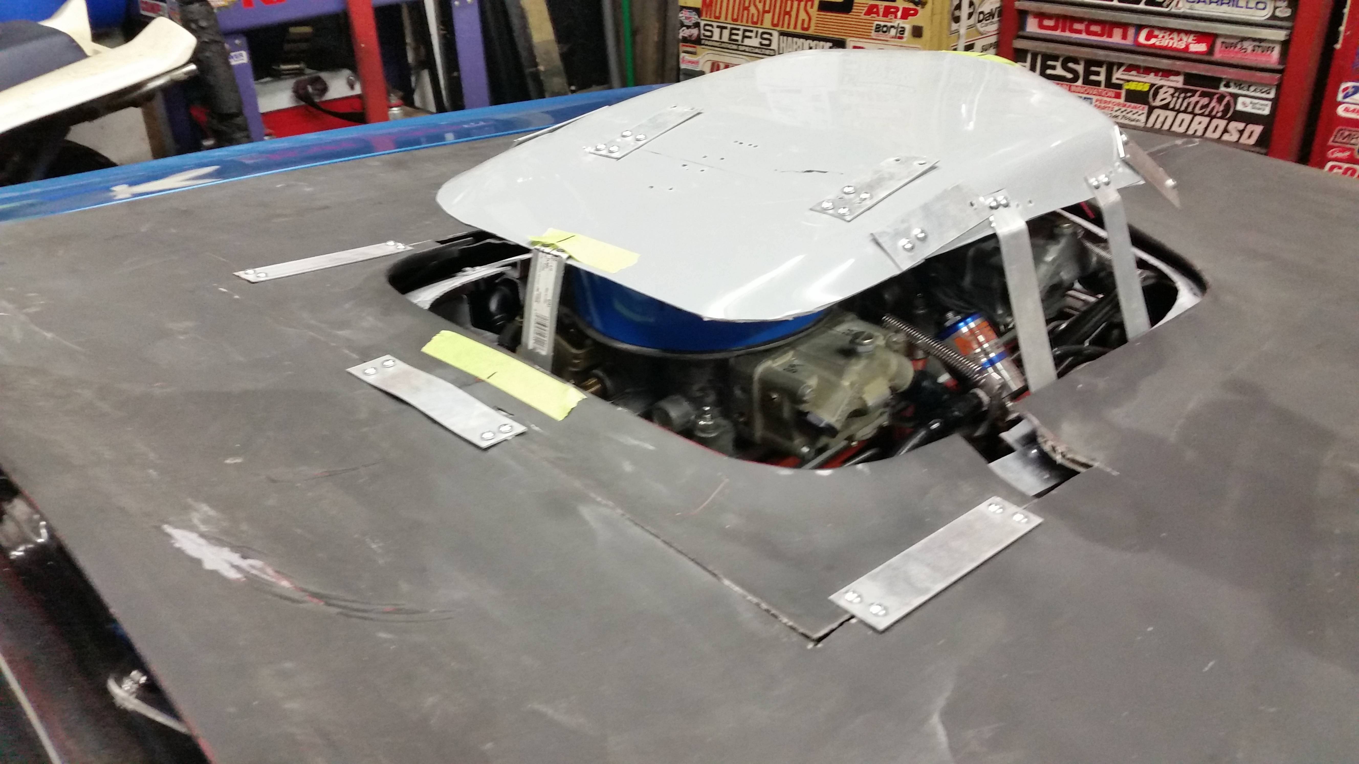

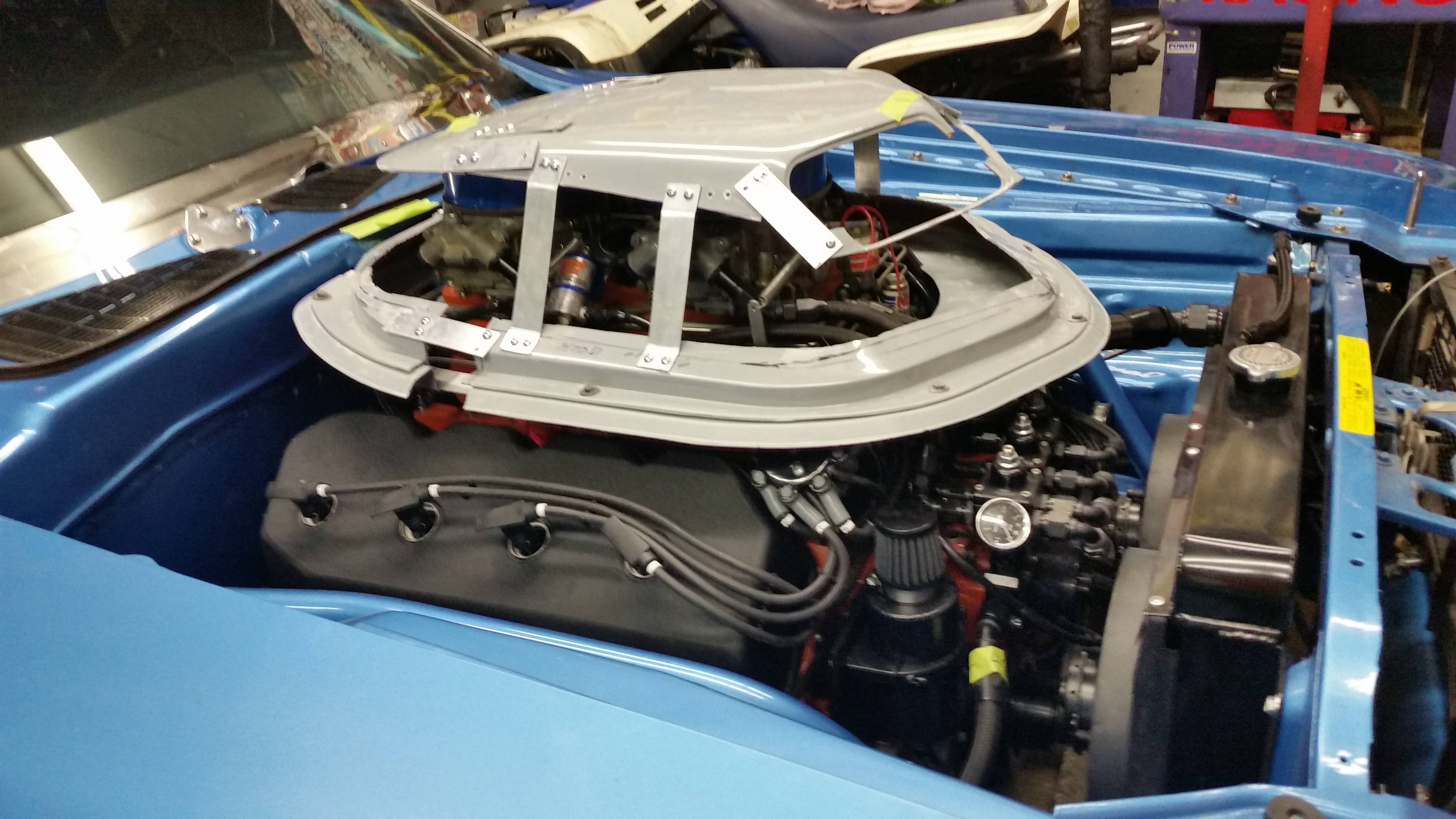

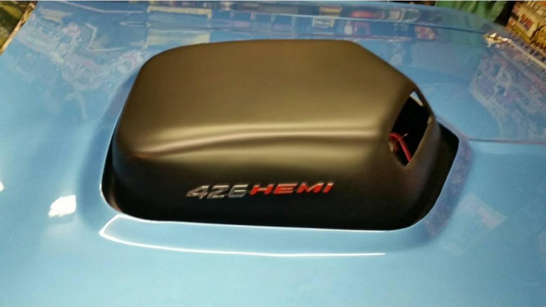

With a little work or in some cases alot of work. You can make the shaker fit for sure. I have alot of hours in my custom Shaker that I made to clear my tunnel ram and two 1050 Dominator carbs.
