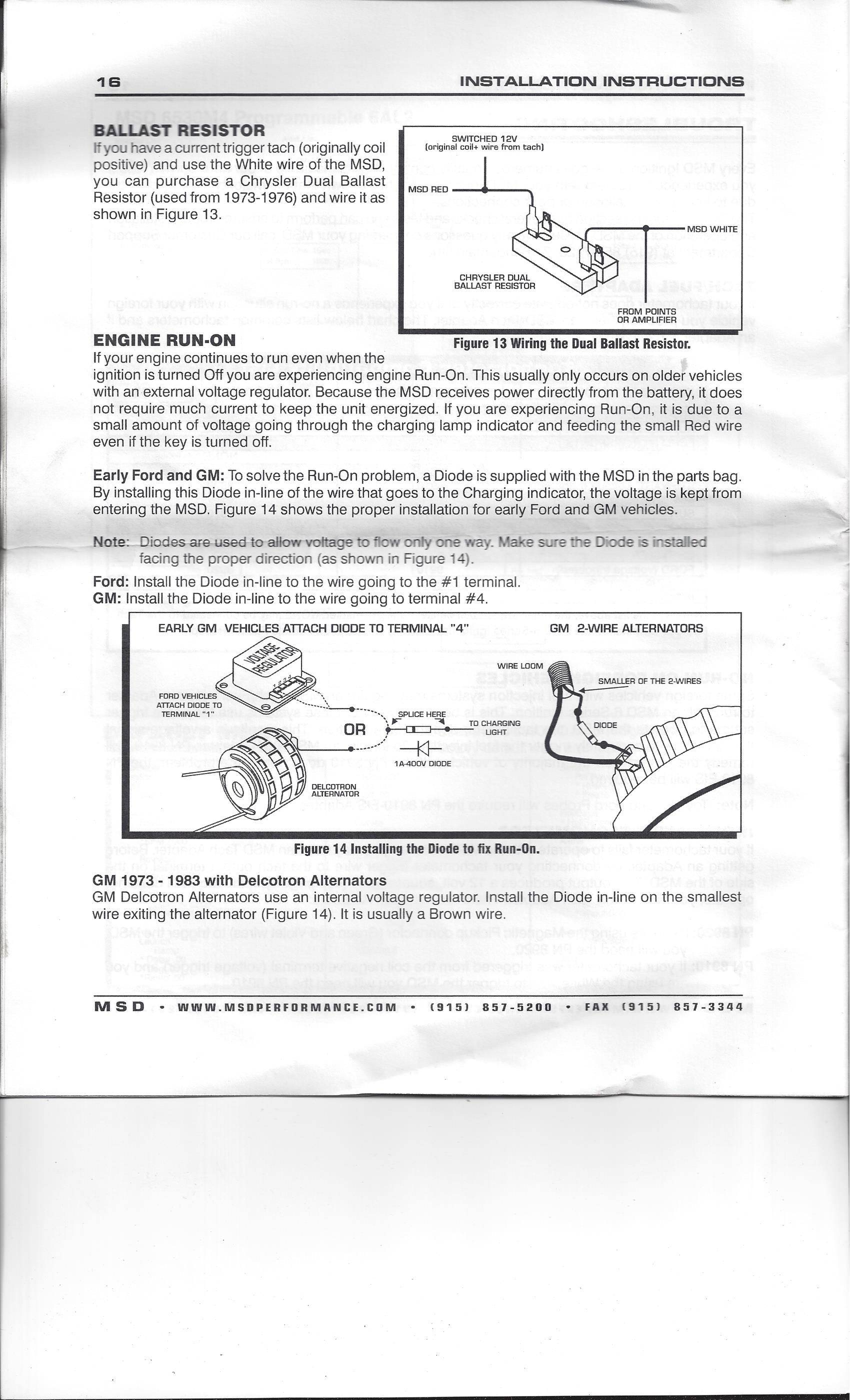

1970 Challenger 383 Petronix ignitor 2 inside stock Mopar distributor. Car wouldn't charge battery but would turn off when key was turned back. I replaced the alternator and now the car charges the battery but won't turn off when you turn the key back. Am I wiring something wrong?
