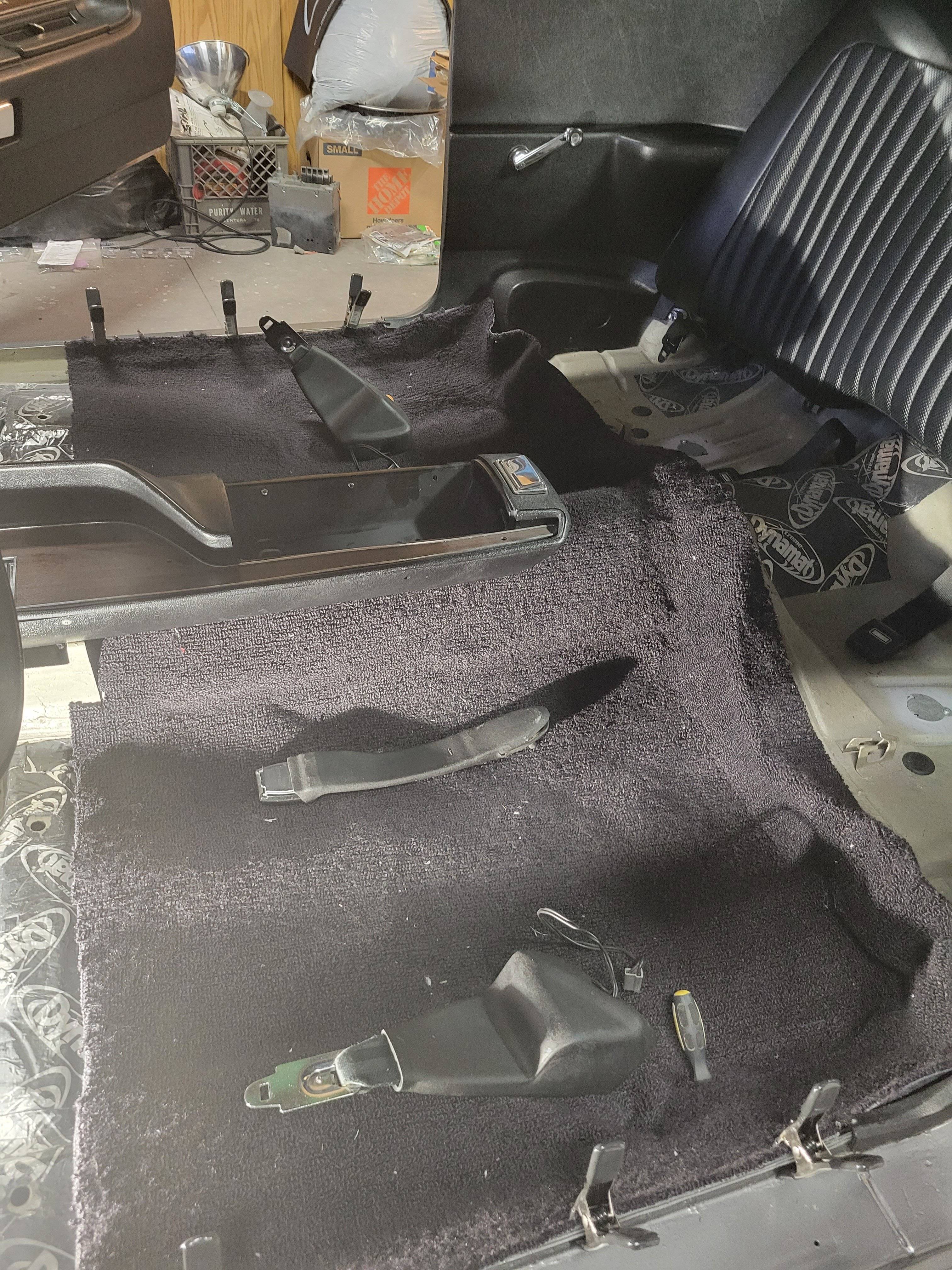

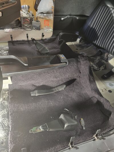

I have new carpet going into the 73 Chally. I have cut holes around the rear console mounts and getting ready to cut holes for the seat belt bolts. The carpet is conforming nicely to most areas, but I'm thinking right where the carpet turns just under the back seat would be a good spot for some glue, and maybe other places. Do you use contact cement anywhere to secure the carpet in place?
Upholstery shops use a steam machine to flatten out the carpet.
I would not glue it - you can but it will make it harder if you ever want to take it out.
