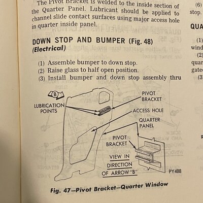

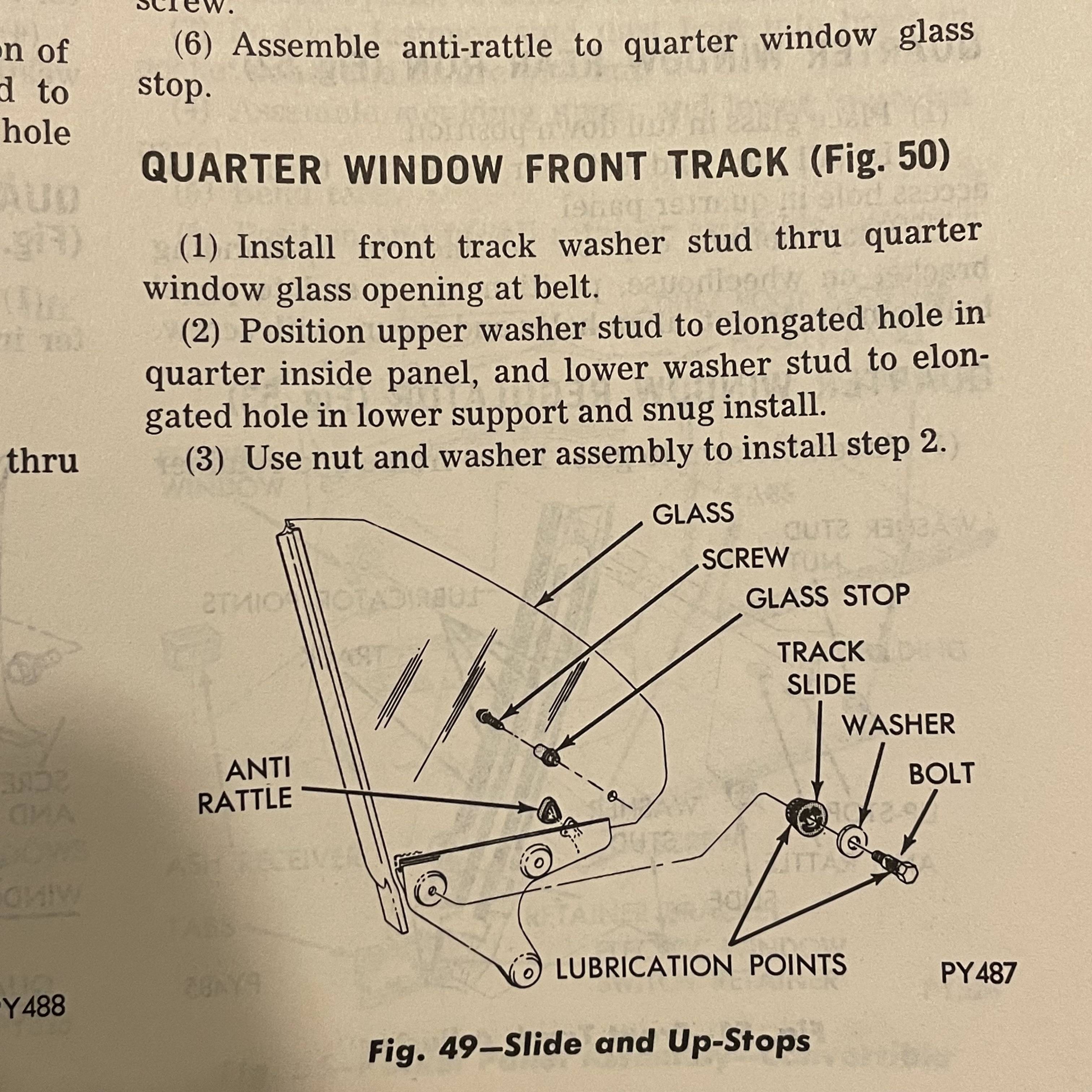

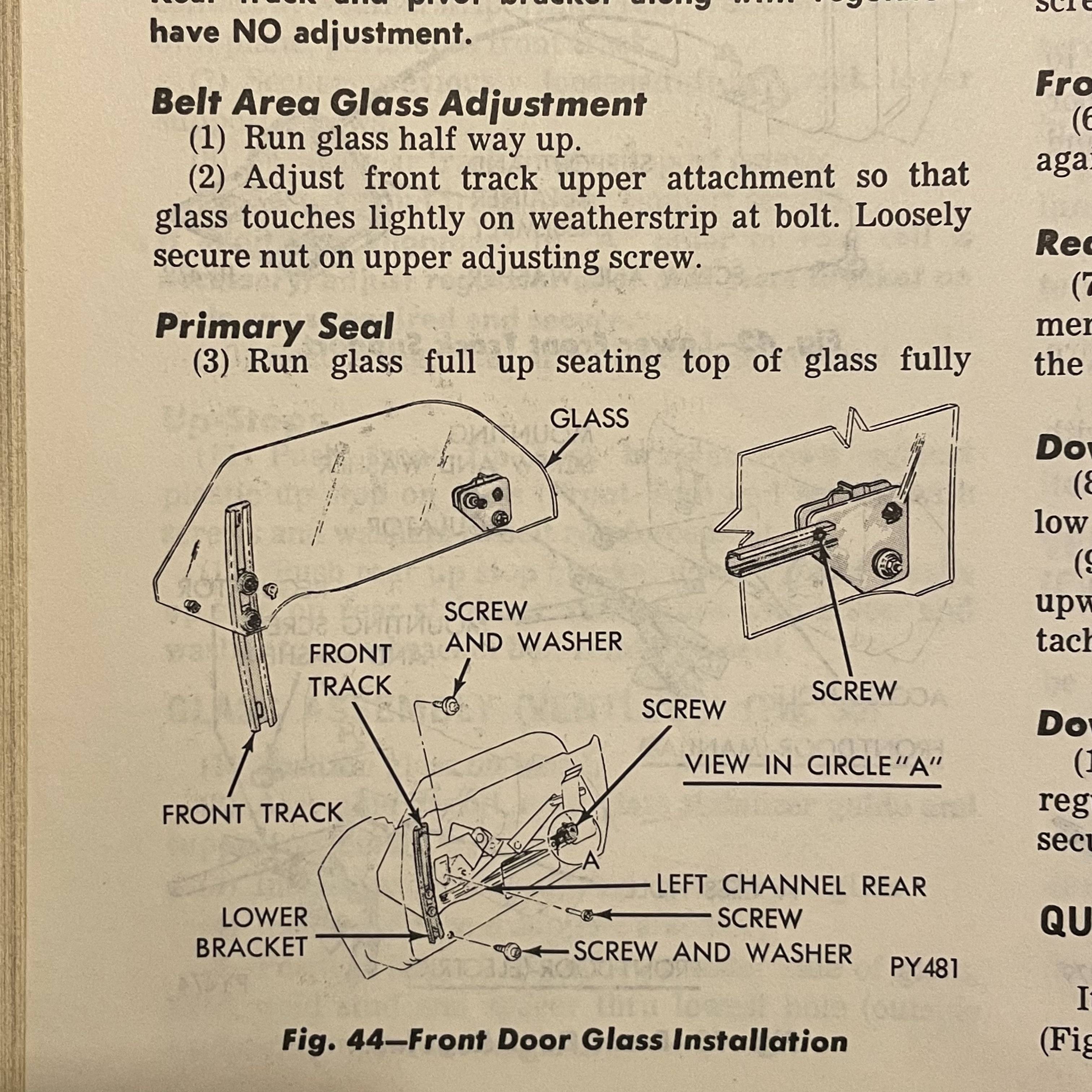

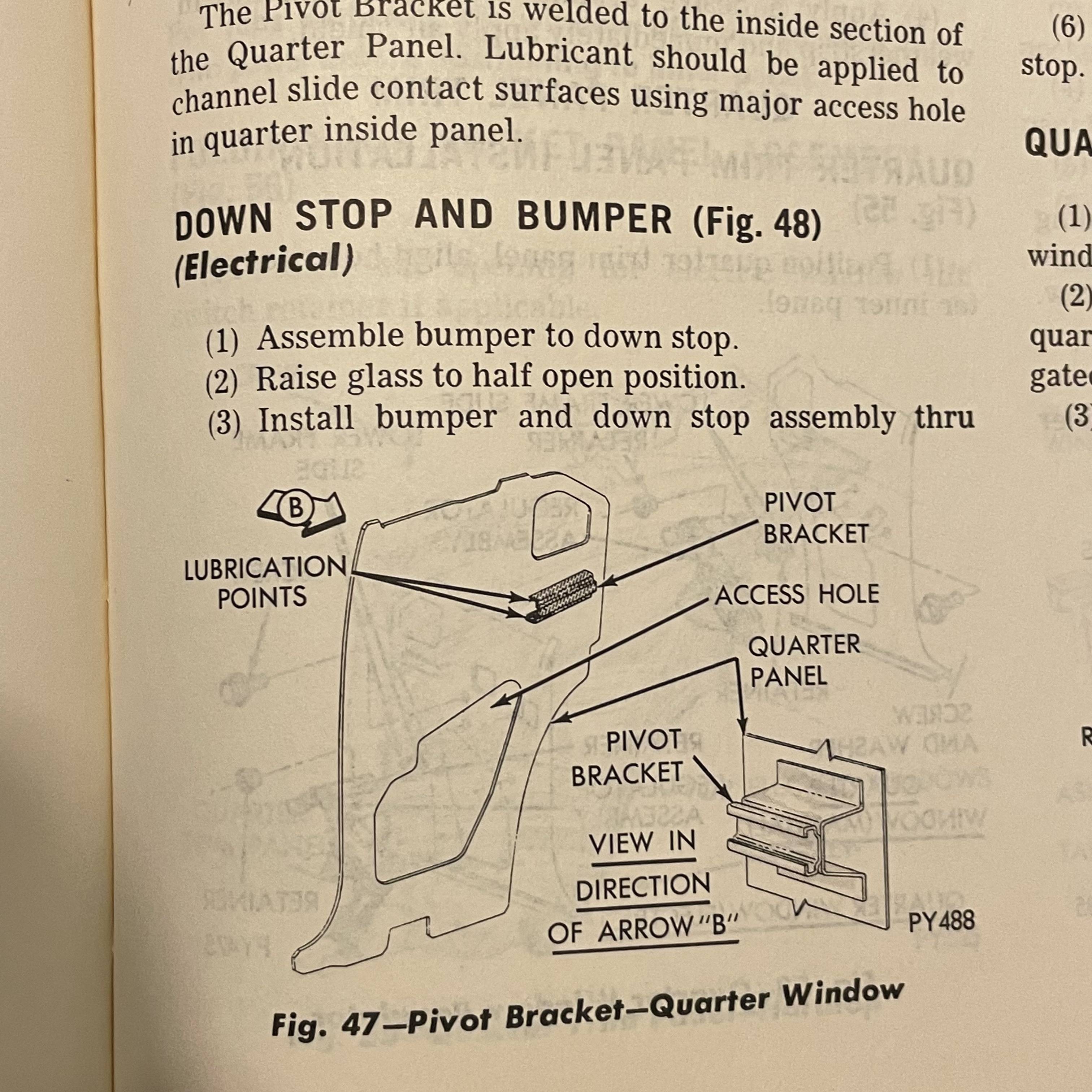

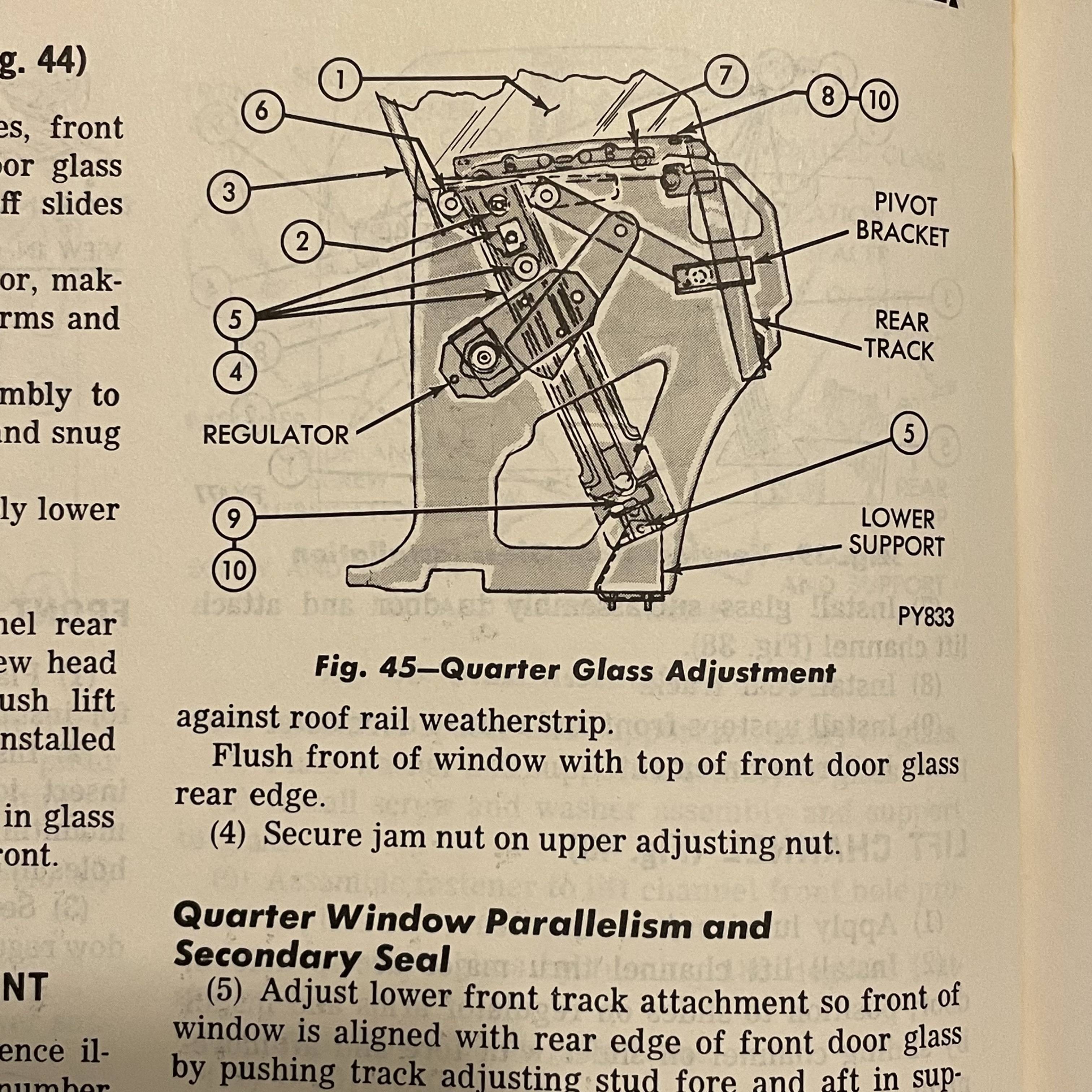

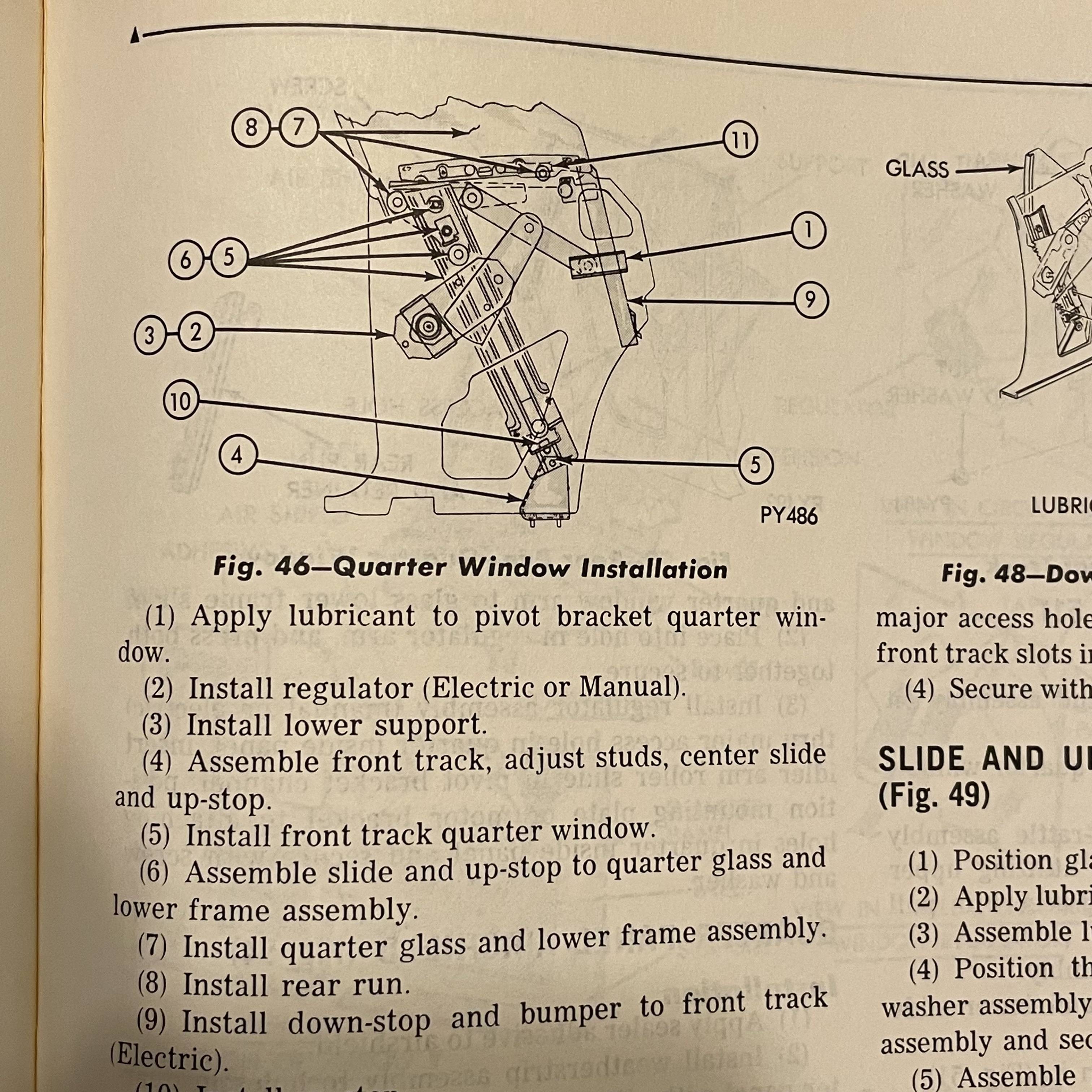

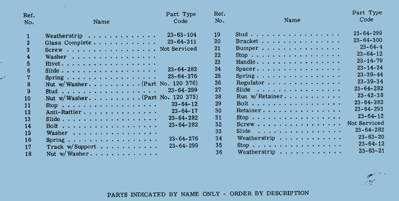

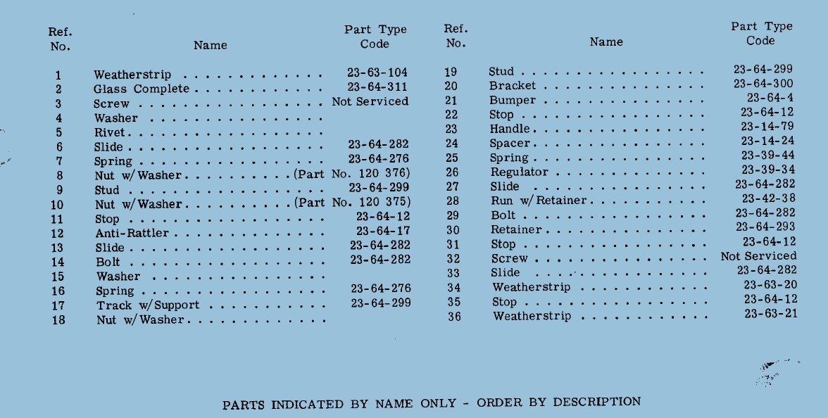

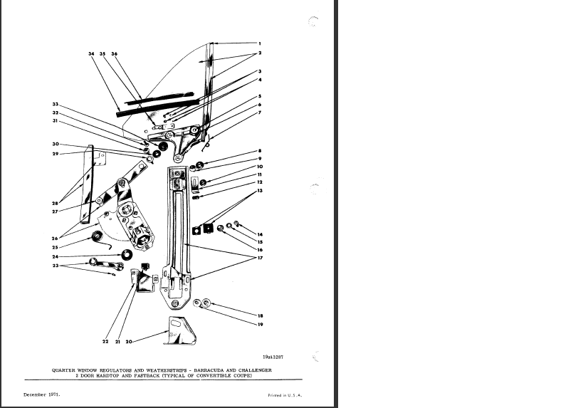

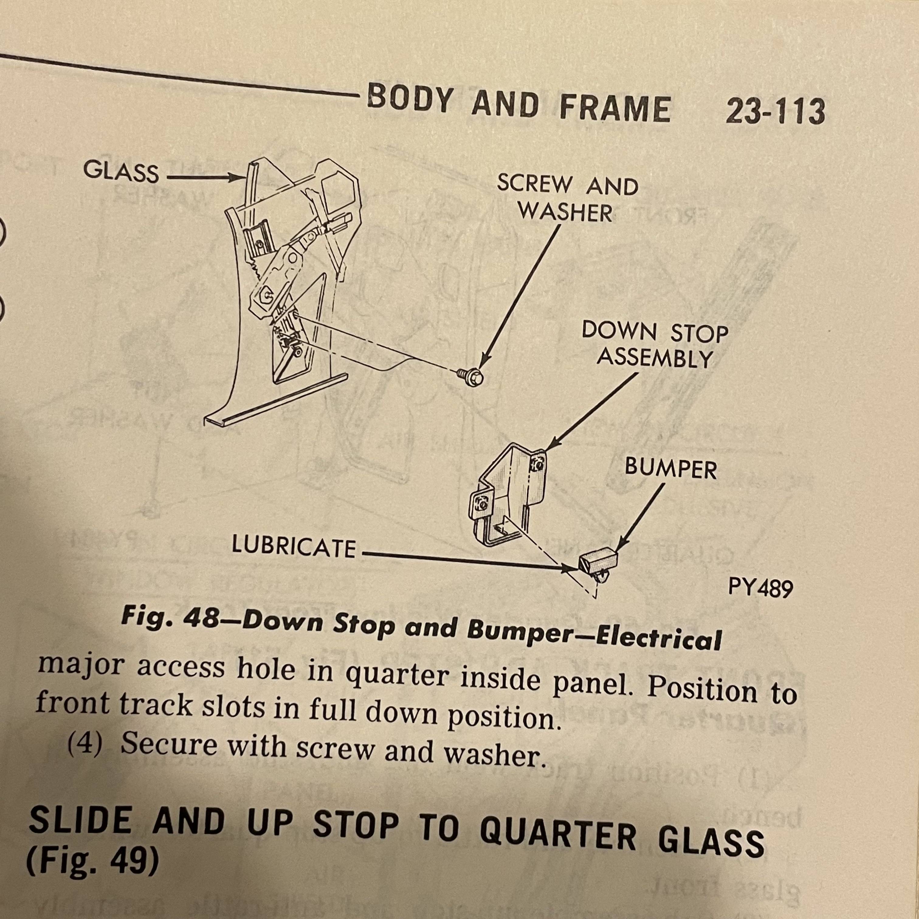

If you have a 1970 shop service manual sec. 23 page 112 and 113 shows your rear window set up
Bug Guy
Mar 22, 2022
103
39
California
Take a look

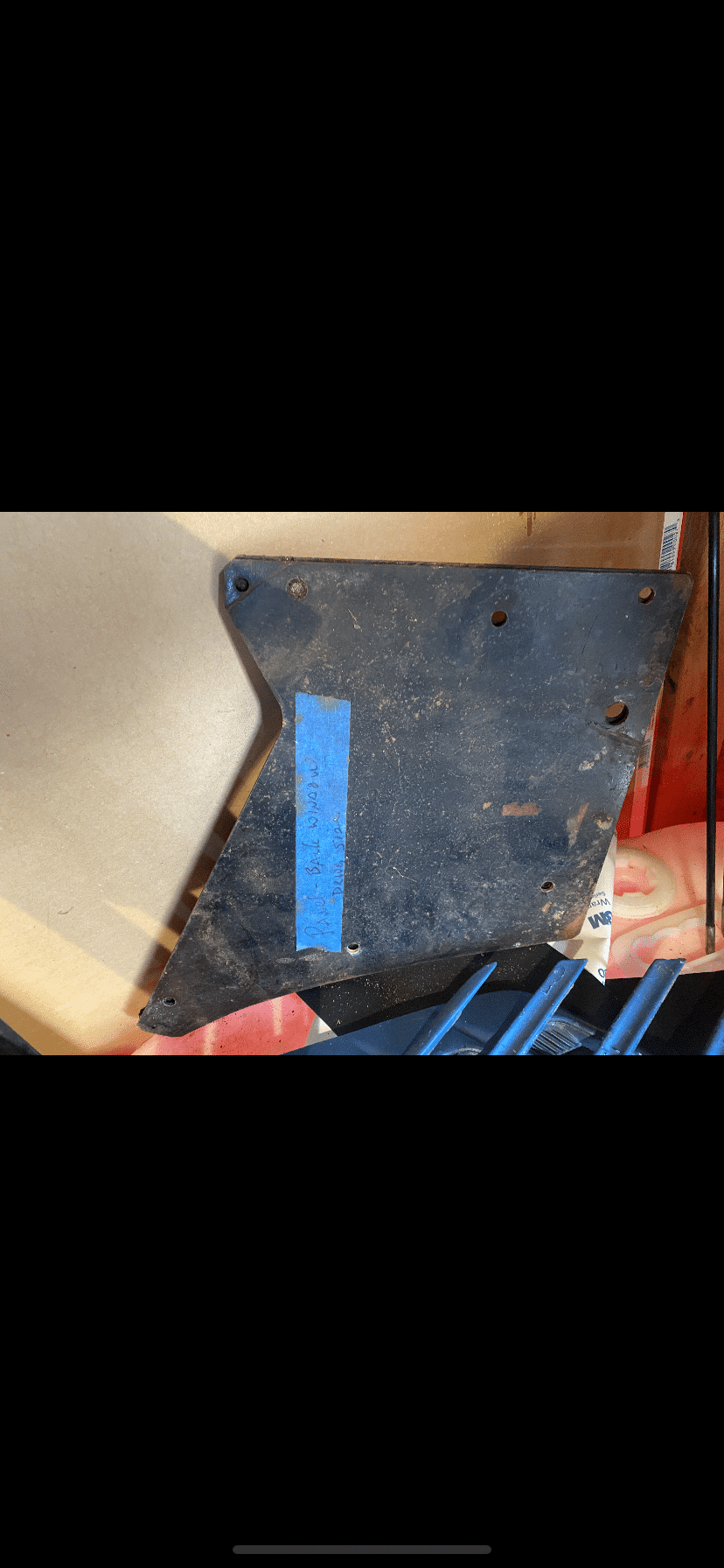

challenger6pak
Feb 27, 2011
4,087
923
The plates screw to the body, under the interior panel, once everything is back together. They are a reinforcement added in 74 only.
