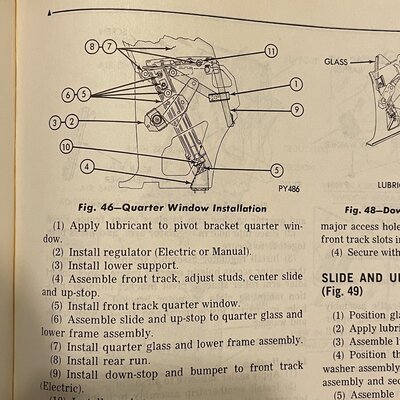

my challenger rear windows were gutted and now wondering what I'm missing , and if I buy all that is missing how to find out how it goes in ? over googled and YouTubed it and nothing.
Windows rear meaning 1/4 windows?

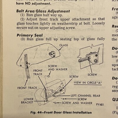

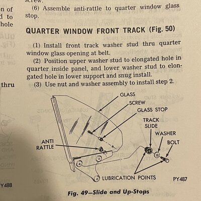

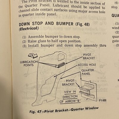

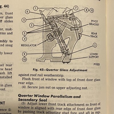

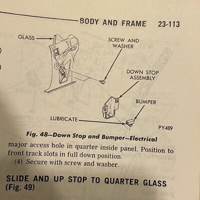

If you have a 1970 shop service manual sec. 23 page 112 and 113 shows your rear window set up
Take a look

The plates screw to the body, under the interior panel, once everything is back together. They are a reinforcement added in 74 only.
