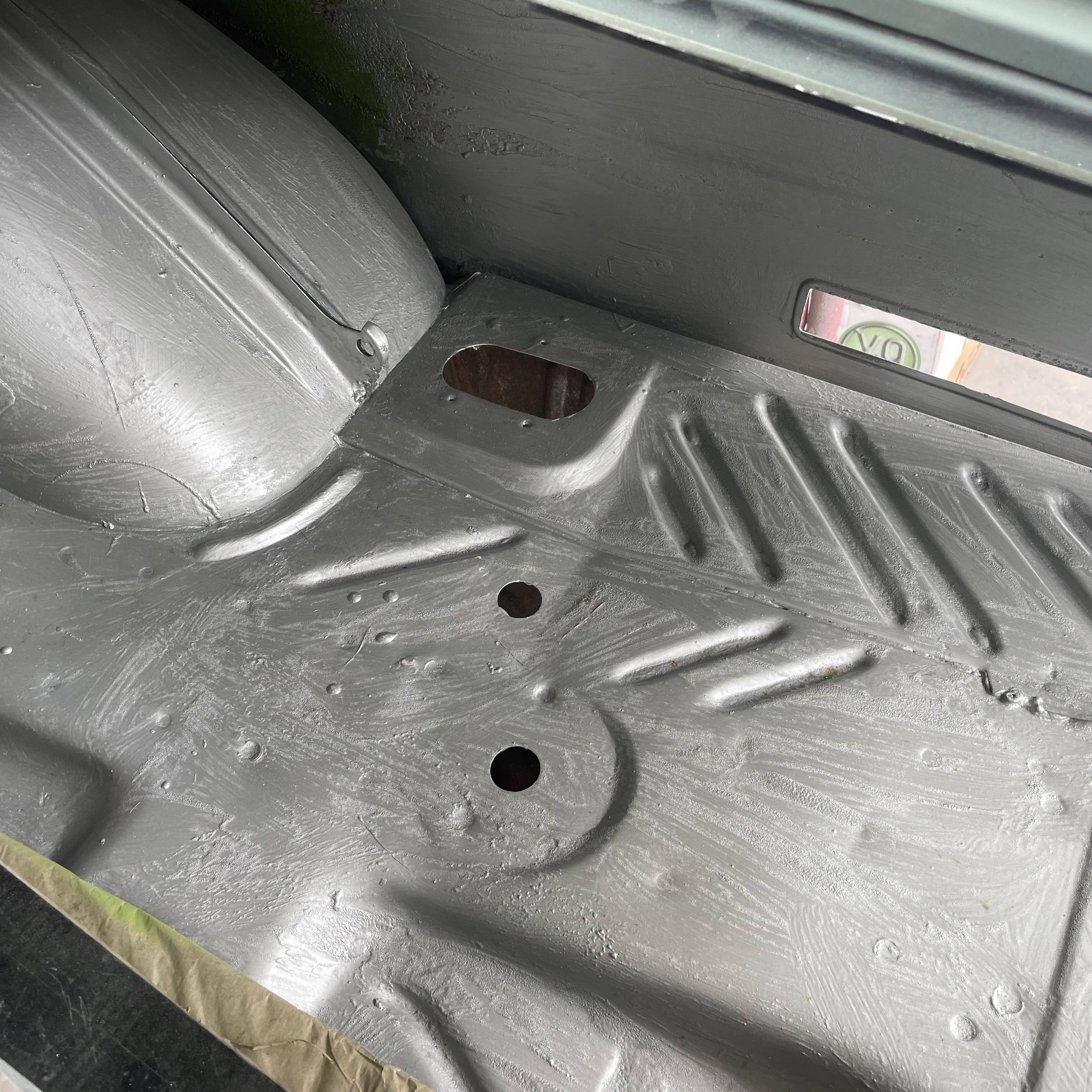

Hi Folks:
Would anyone be able to tell me if T/A were available with California emissions?
I have a CA emission 70 R/T with the gas tank vent tube assembly in the right side of the trunk.
I'd like to put in a retractable factory antenna in the rear T/A location, but the antenna and tank vent tube look like they would want to occupy the same space.
If anyone has any insight, they'd be appreciated, thanks.

Yes I would think so if sold in California.I have a AAR sold from SoCal it has vented gas tank assembly on the right side of my car

Hey! Thanks!. Greatly appreciated.
Good to know that the solid and 3 piece telescoping types fit - which is what I have up front.
For some reason I though the telescoping ones went down flush and would project well below the fender line - which is what I was concerned about.
I think I'll put a 1 piece mast type in. I have both. The 1 piece looks a little slimmer
