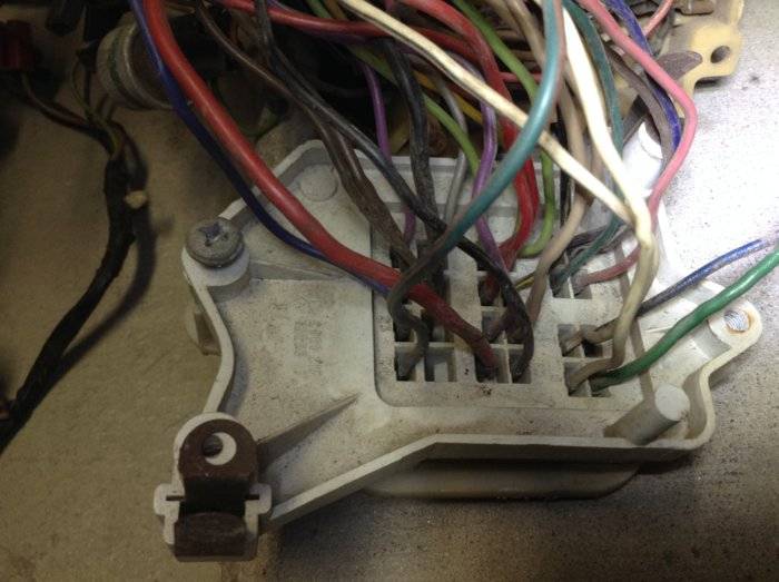

I hope that I can point you the best direction. If it’s my car that has your problem the wiring is where I’d starter. Don’t try to fix the starter cables, replace cables. With these old cars, the electrical system has a large amount of amperage. All of the attach points need the be cleaned with no resistance.
Next I would pull the fire wall connector apart and look for burnt wires. The steering column has a connector that can have burnt wire connections too.
I wish you luck, because when you do fix your problem, you will have learned much.
Here is the firewall connector in my car totally rebuilt. With these old car the electrical must be totally rebuilt . Again, this is what I would do
Azmoparboy
