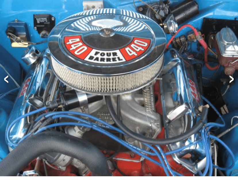

as you can see the coil in the photo was mounted close to the headers on its side. the car would drive maybe 30 minutes then shut down until the coil cooled off. I purchased an edelbrock coil moved it to the fire wall mounted it in the correct straight up position now the car runs 10 minutes and its (coil) smoking hot. on another issue mounting it to the fire wall I had to rig up a coil wire that was 5 foot long any one know where I can purchase one already made? I came across this searching the internet. The MSD Blaster Coil has an internal resistor, so the white ballast resistor mounted on the firewall is not necessary. I don't think it's good for your coil to have 2 resistors in your circuit line. ( mine is using the one on the fire wall .dont know if edelbrock blaster HAS ONE OR NOT) thank you

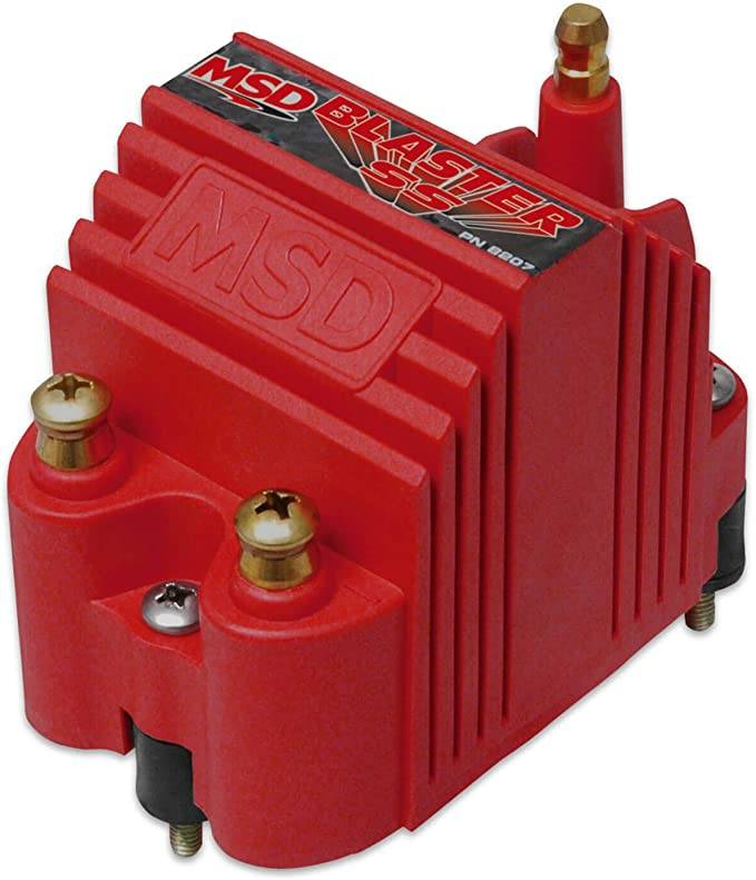

I had one of those MSD Blaster SS coils that failed (with a 6425 6AL box). It was less than 2 years old. On a long ride, about 3 1/2 hrs., the car stumbled, stumbled, then stopped. It re-started, then 5 min later did the same, but would not restart. I checked spark, it had spark. The coil felt hot, but it was a hot day, and typical very hot under the hood. Tried my spare 6AL, would not start. Got a roll back. Next day, Still would not start. After changing the pickup in the dist., and checking fuel, plugs, timing, it still had spark but would not start. Finally I tried my spare coil - IT STARTED!!! So I guess even though the coil had spark, it was not enough. After talking with MSD, they said the Blaster2 is the recommended coil. It would be nice it their web site said the same. BTW, my coil is mounted in the right front inner fender area near the horns - I thought that would be a "cool" area under the hood. I've had my coil mounted there for over 30 years, and this is the 1st coil failure I had. My MSD box is located on the floor, pass. side under the heater, to try and keep it cool.
I wish I would have chose a different company than MSD. I currently carry a spare 6AL box (one of them failed for me about 3 years ago), coil, and dist. pickup. Thanks MSD...
