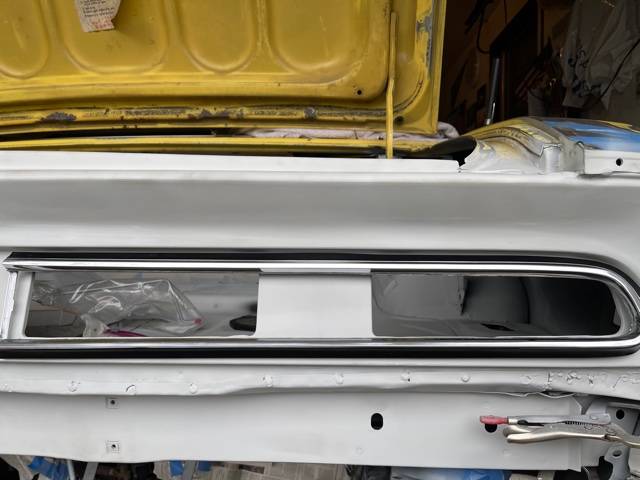

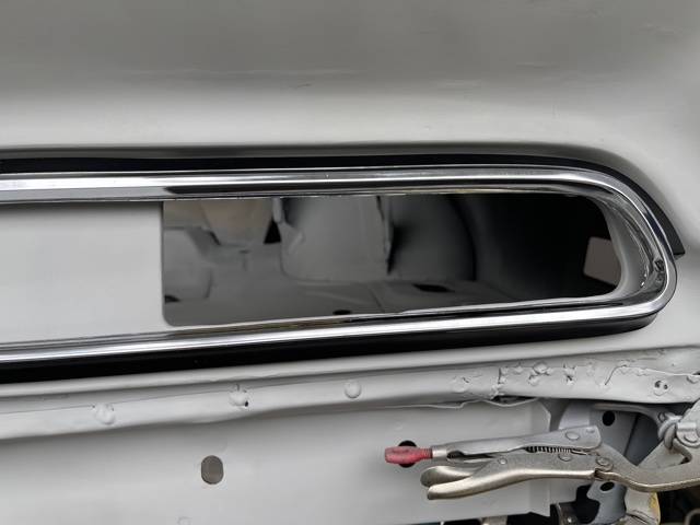

I found this part sitting in a dealership in the mid-west. Paid $29.00 for an NOS right side Challenger tail light chrome surround. Wish they had the other side. At the time there were different parts scattered throughout the country in dealerships in parts departments they were just trying to clear out. Got a few parts this way back then. Had to take it out and just see how the fit was on the A66.
