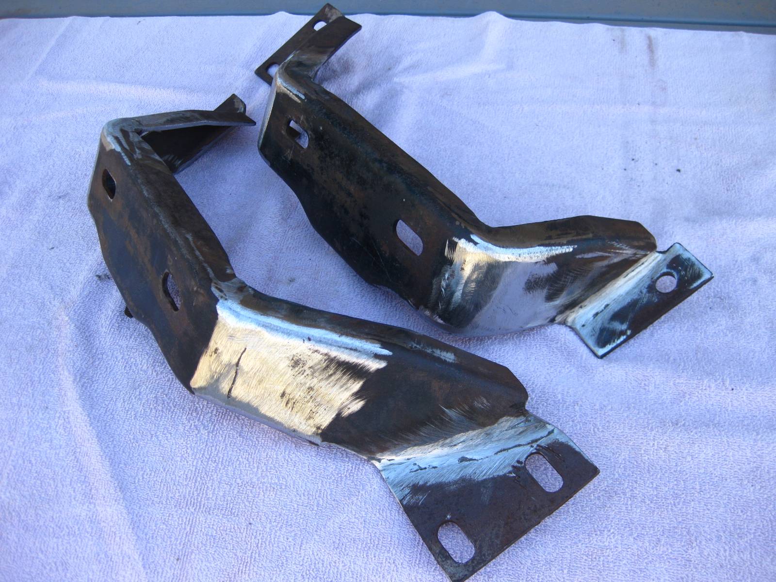

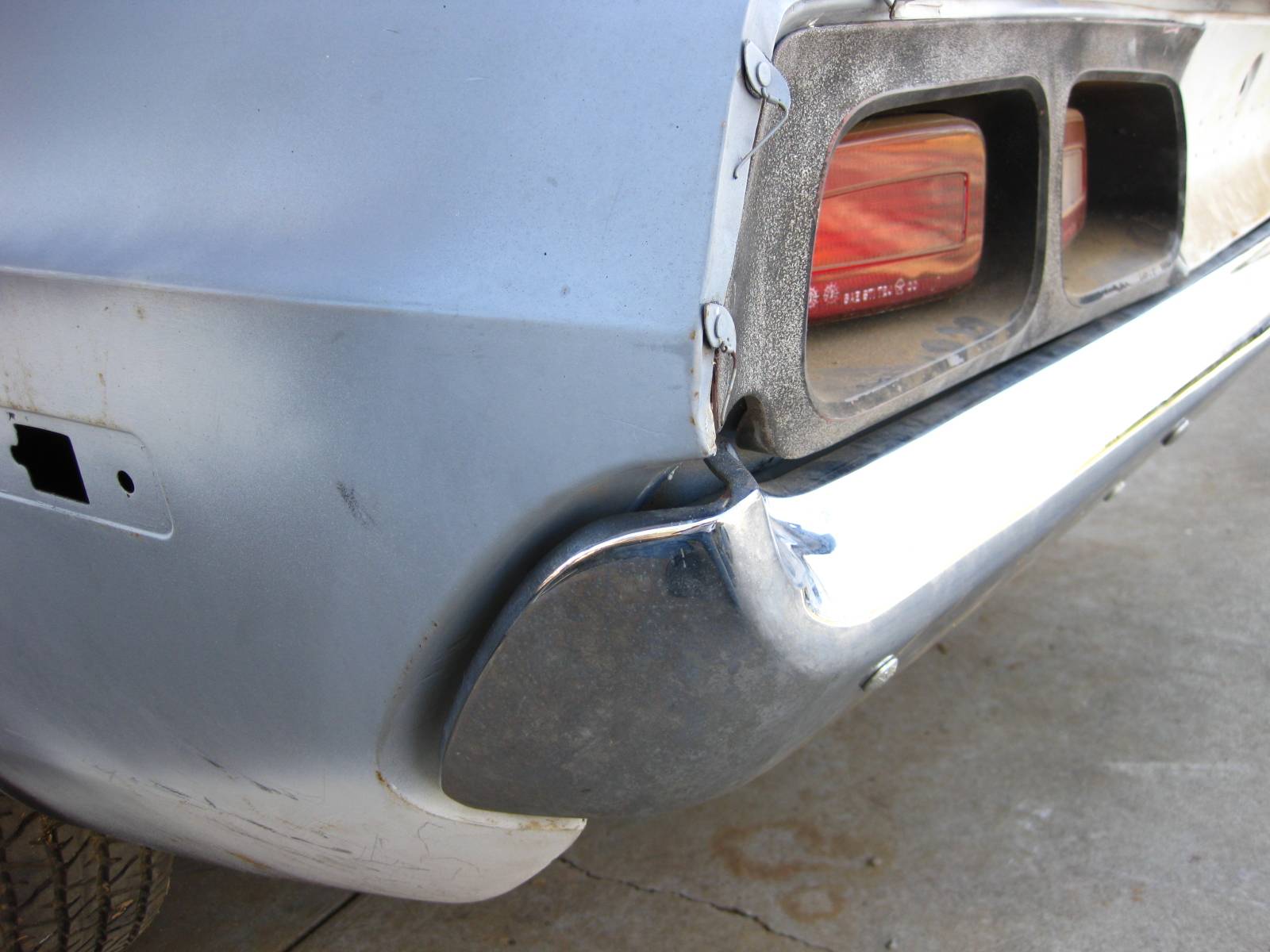

Here is how I did the rear brackets to snug up the bumper of my 73 Challenger. A little cutting and bending to keep the geometry the same, but it can be done. Sorry so late on a reply. Any chance you could take a few pictures of how the fuel line runs from the tank to the fuel pump? I'm having a hell of a time figuring it out as I removed it about 8 years ago. Ugh.
