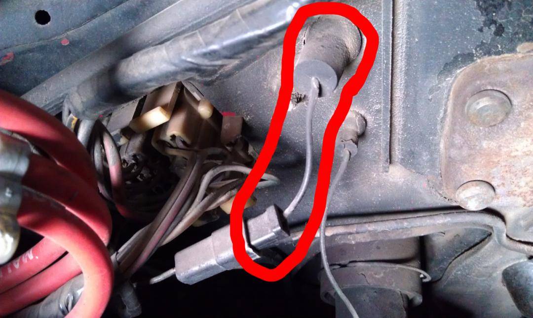

Hi,
I started converting my 70 Cuda to Rallye gauges today and I found a wire that I don't know what it was for. As it is now, it is hooked up to the minus side on the coil. I traced the wire under the dash and I think it ends up at the headlight switch? The resistance when I checked was a bit high though, something like 700 Ohms.
What is connected to this wire on a stock car?
The car is equipped with a Mopar Performance orange ignition box if that makes any difference..
Can I disconnect that wire and connect the negative side of the coil to number 20 on the bulkhead connector and hook up my tach as usual or do I need to have that wire connected to the negative side?
Thanks for any help!

No offense to you that replied, but I basically knew what to do, I'm not cutting the oil lamp wire as it is possible to back the terminal out and just connect it to a female spade terminal with a round connector in the other end.
But anyways, can I just disconnect the wire that I marked in the picture and run the wire from the negative side of the coil to the tach?
I have looked at wiring diagrams on mymopar.com for both 70 Barracuda Non-Rallye and the Challenger Rallye and in none of them is that wire marked.
The bushing looks stock and the terminals are Mopar terminals.
Very strange..

Is your can equipped with a manual or automatic transmission? I' m asking, because, it looks to me that the wire you surrounded in red is in fact, the wire that goes to your ''reverse'' light inside the car, next to the ash tray, (manual only). Just a tought.
Robert
Thanks for your reply! That's what that was, the reverse light wire. Thanks!
Doing another trace and I found that the black wire with yellow tracer on the MP electronic ignition module terminal is hooked up to the coils negative. The two looks almost the same. What is strange is that doing a continuity check on the wires, from the negative on the coil to the reverse light wire, there was a connection there which is what I first used to see which wire was hooked up to the coil.
