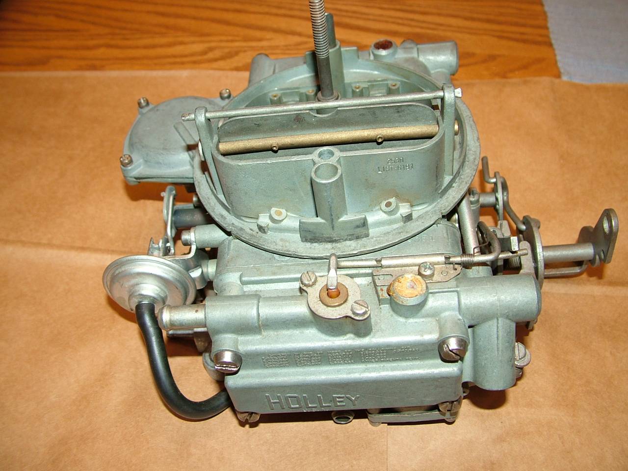

If it's a 4 spd it came with a Holley 4160, List 6191.
Here is the carb that is original to mine.
moparleo
Oct 17, 2011
7,201
1,981
Do you have a Factory Service Manual yet for your car ? It answers most of the questions that people ask on this forum. They are a free download.
383 a/t heated air intake system Holley # R4668A
" " fresh air intake system Holley # R4735A383 a/t
or if Carter equipt
383 Carter # AVS-6125S

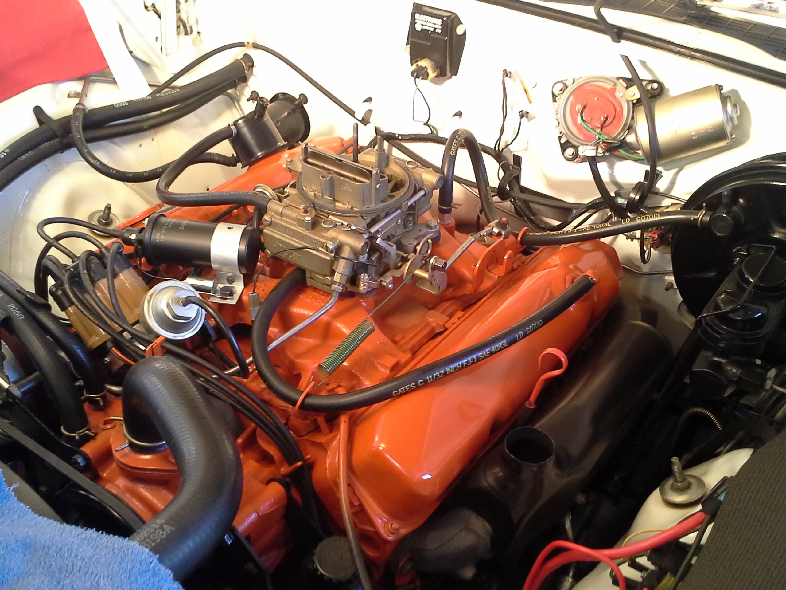

Charlie71rt
Dec 7, 2016
60
7
According to my broadcast sheet decoded by Galen mine is R4667A 71 383 4spd built in September 70 with the wire to the electric vacuum advance, I searched for years to find one.
