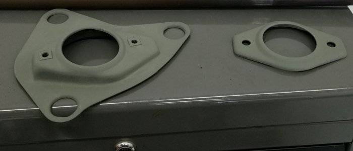

Correct color for lower steering column mount?

I have a B5 blue AAR with brilliant blue interior. Steering column was incorrectly repainted silver in engine bay by previous owner. I'm totally restoring the column and I am attempting to determine if the two steering column mount parts in the pic (shown in primer) are to painted interior color brilliant blue or semi gloss black. Can't find a pic of an original column from any interior color other than black. Thanks in advance.

All I have seen is black but If the column is painted blue they could have been blue

Gloss black for every car regardless of interior color.
not semi gloss, not satin.
