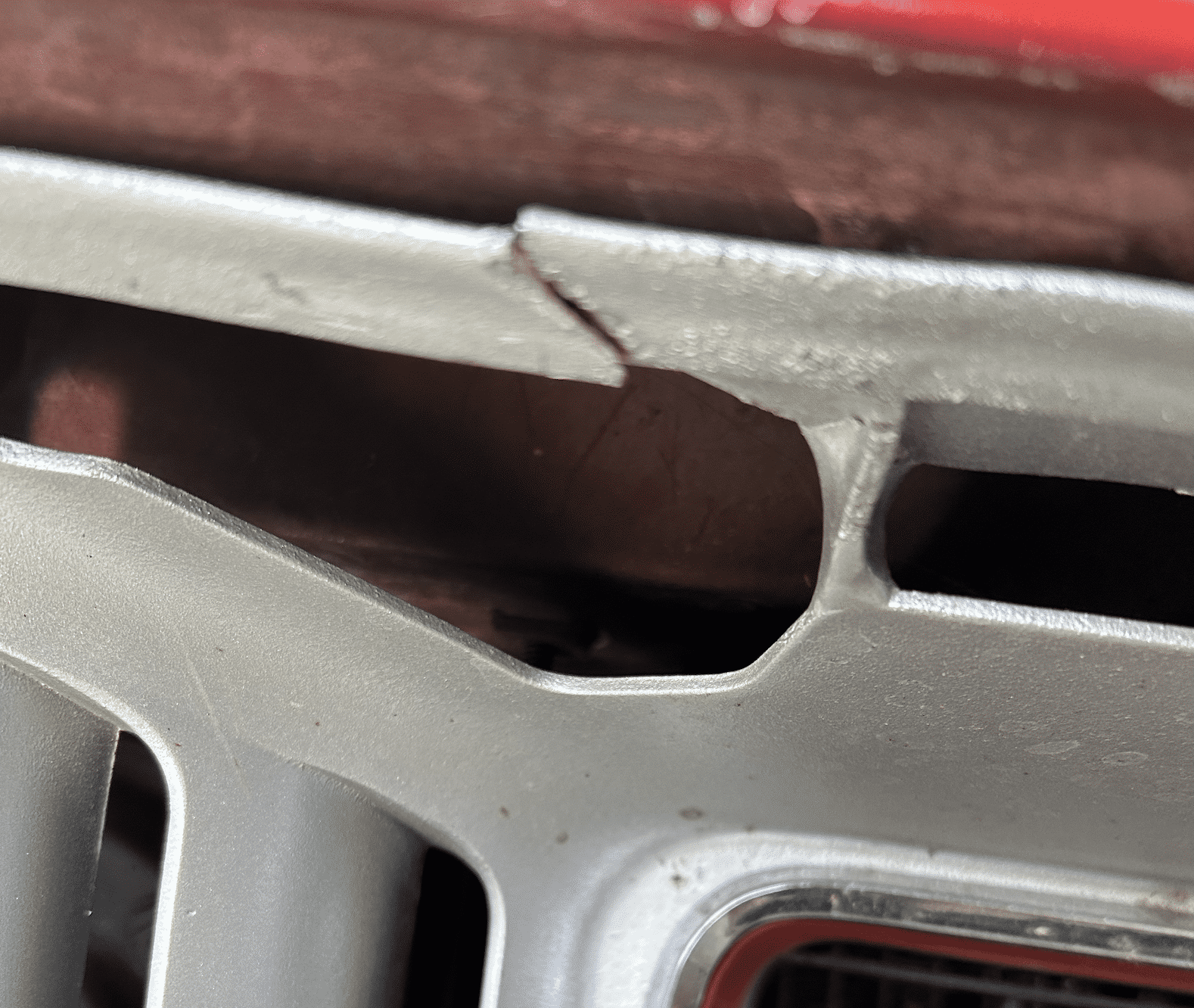

My 73 Cuda grill is cracked on the top. The area looks like it might have had a repair in the past. What would you do to repair this? Doesn't have to be perfect, just good enough not to be visible to the casual eye.

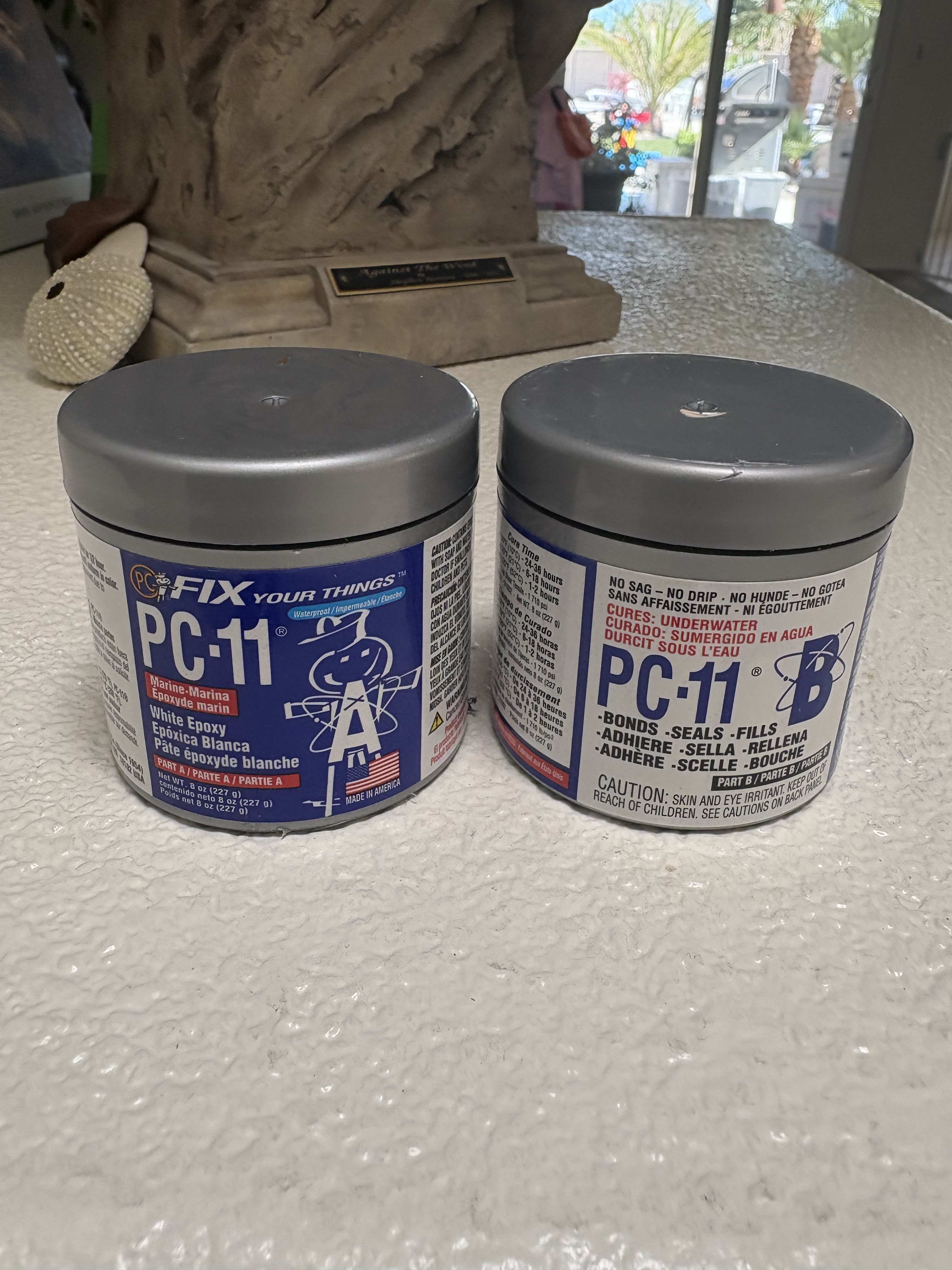

Hey Kansas, PC-11 this stuff is phenomenal. Mix it , apply it, you can tape over it to hold it in place. 24 hours later take the tape off, sand, and paint. You won’t even have to remove the part. Thick too so no runs or sags. Amazon has it too🏝
Thanks for. the tip, Surfcuda...Got the auto mix pen on the way from Amazon for $8.

It appears my grill is light Argent...Gonna take it off later this fall. When the fix it good, I think I will paint the entire grill as opposed to trying to "spot in" the fix. Any recommendations for a proper paint "think rattle can" color, I'm open to suggestions.....
Kansan
Krylon dull aluminum is close and sold just about everywhere - Ace Hardware, Walmart, Auto parts stores, etc.
If your grill has the textured Argent paint you can get it here;
