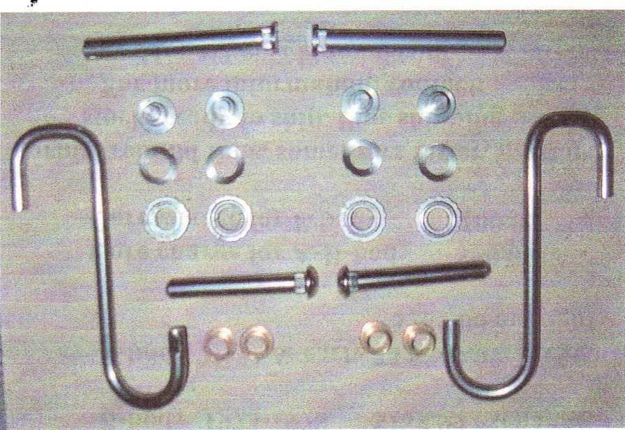

No instructions because they were not made to use on the lower hinge. They are just an extra set of upper hinge bushings and long GM pins.We use custom, oversized steel pins for the lowers as well as replacing most all other parts with new production USA made parts.
