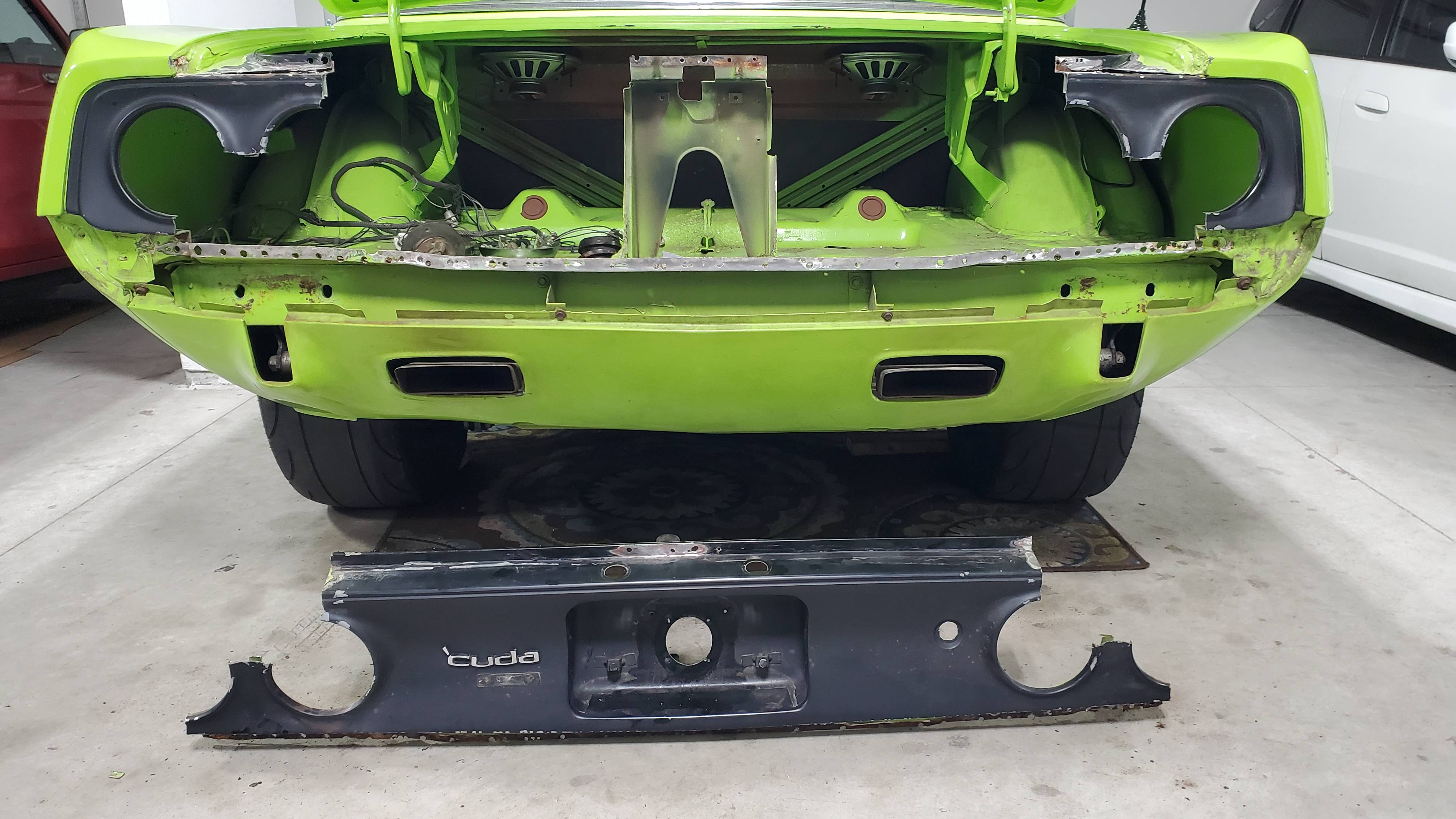

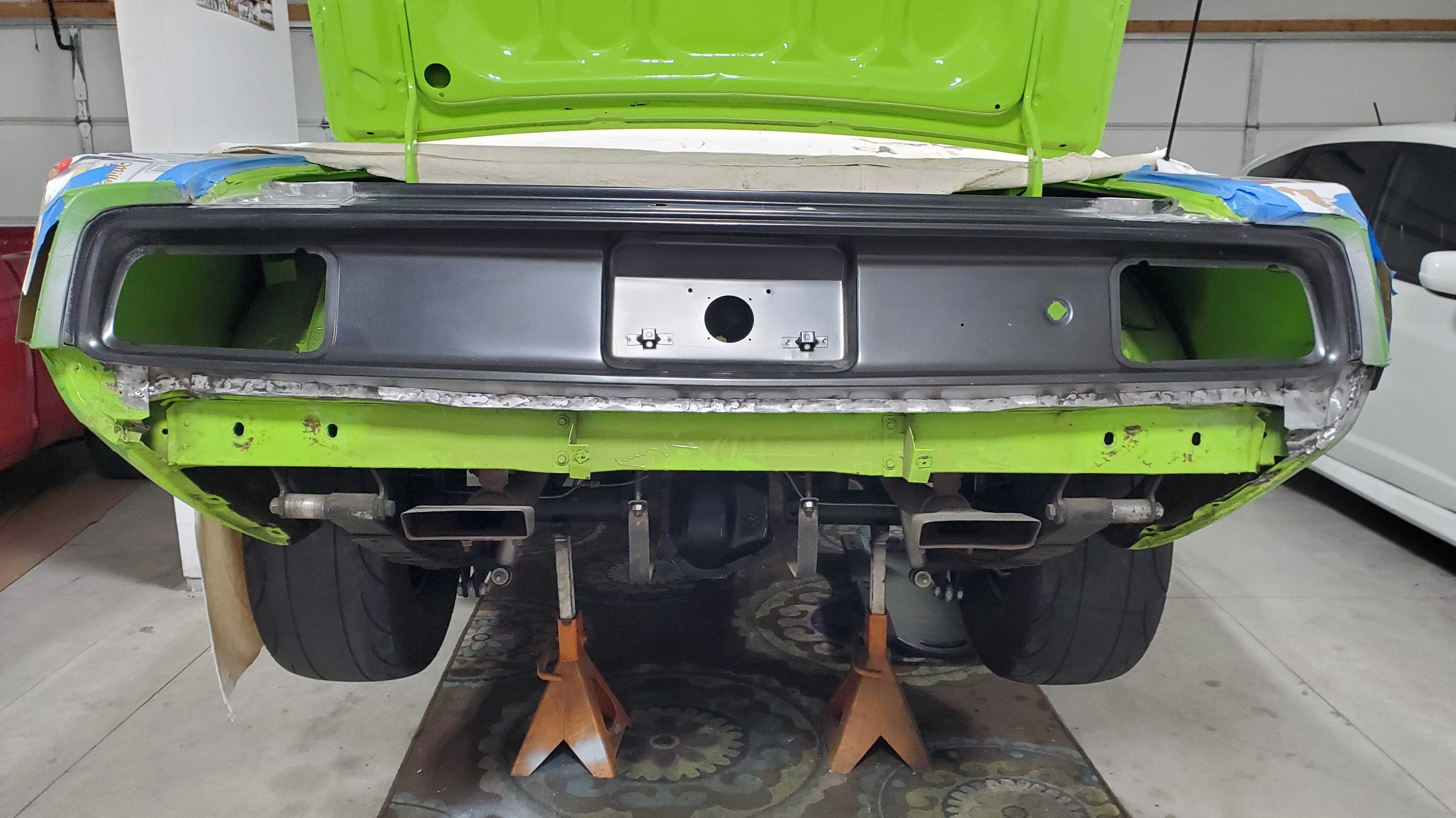

unfortunately due to covid AMD shipped less than half of the parts I needed for the conversion, but at least this gets me started.

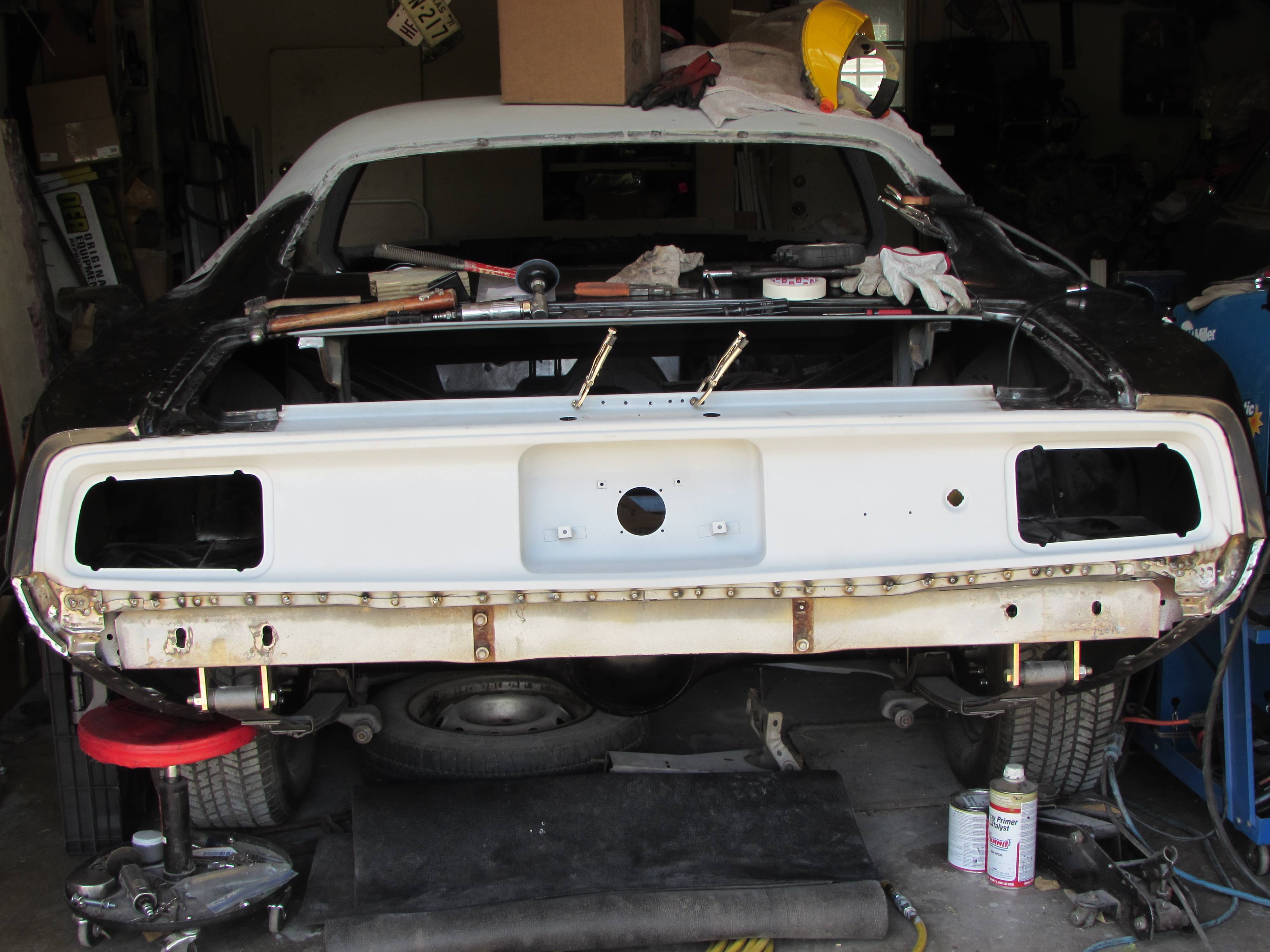

I guess you will be doing this. Welding in my tail panel in my 71 BHG when I replaced the trunk floor.

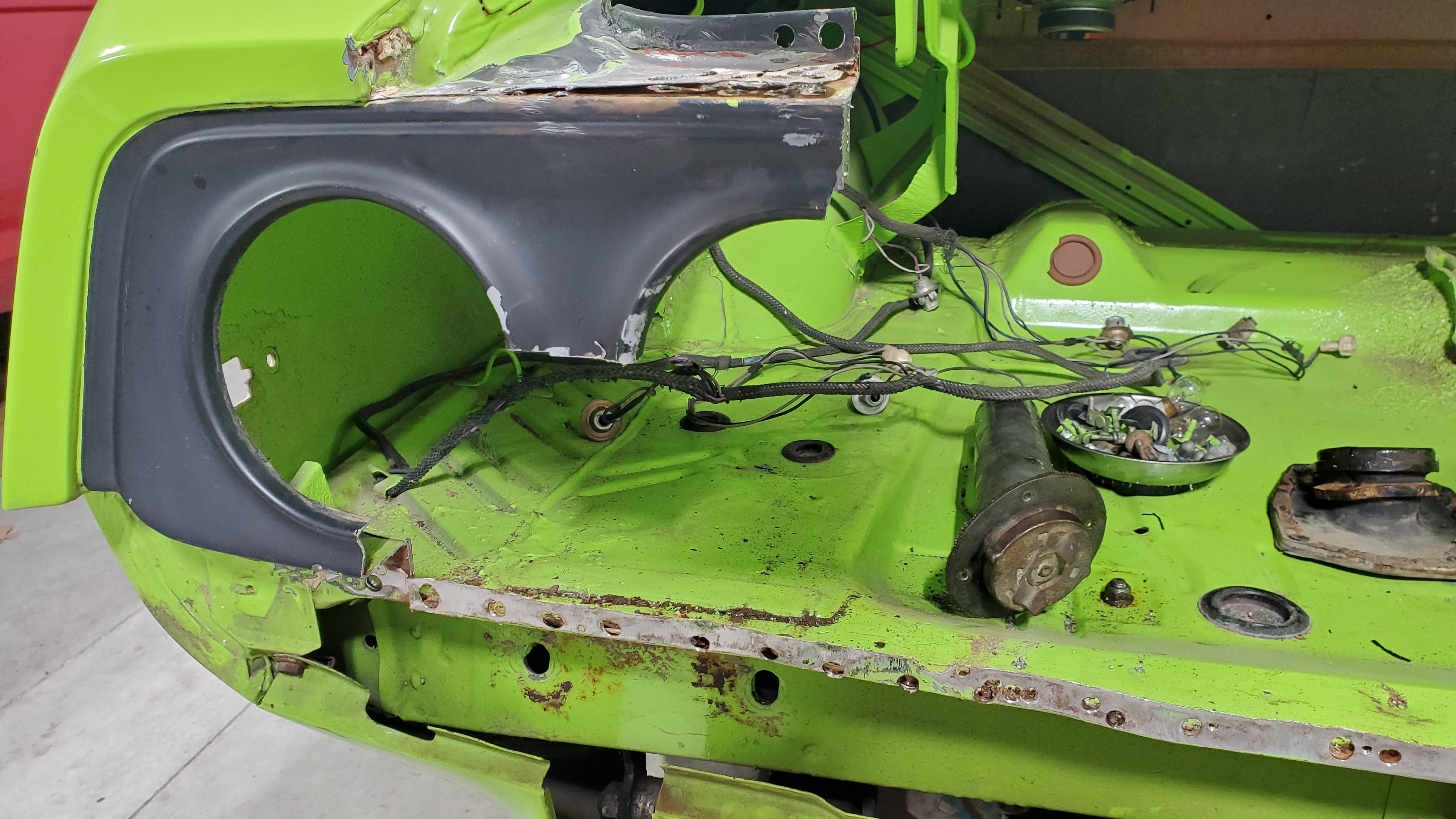

Racine, Wisconsin

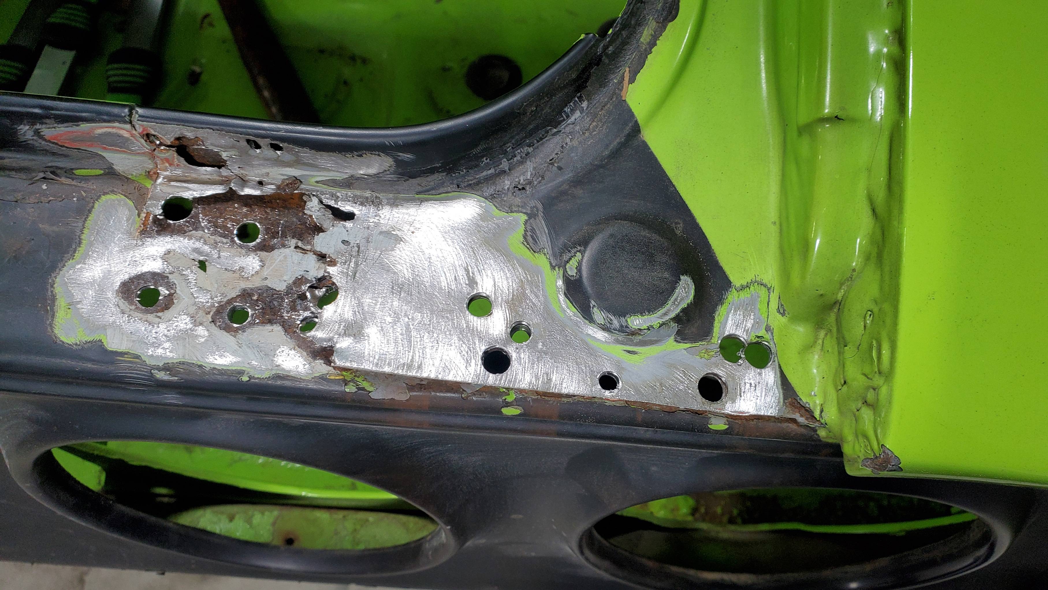

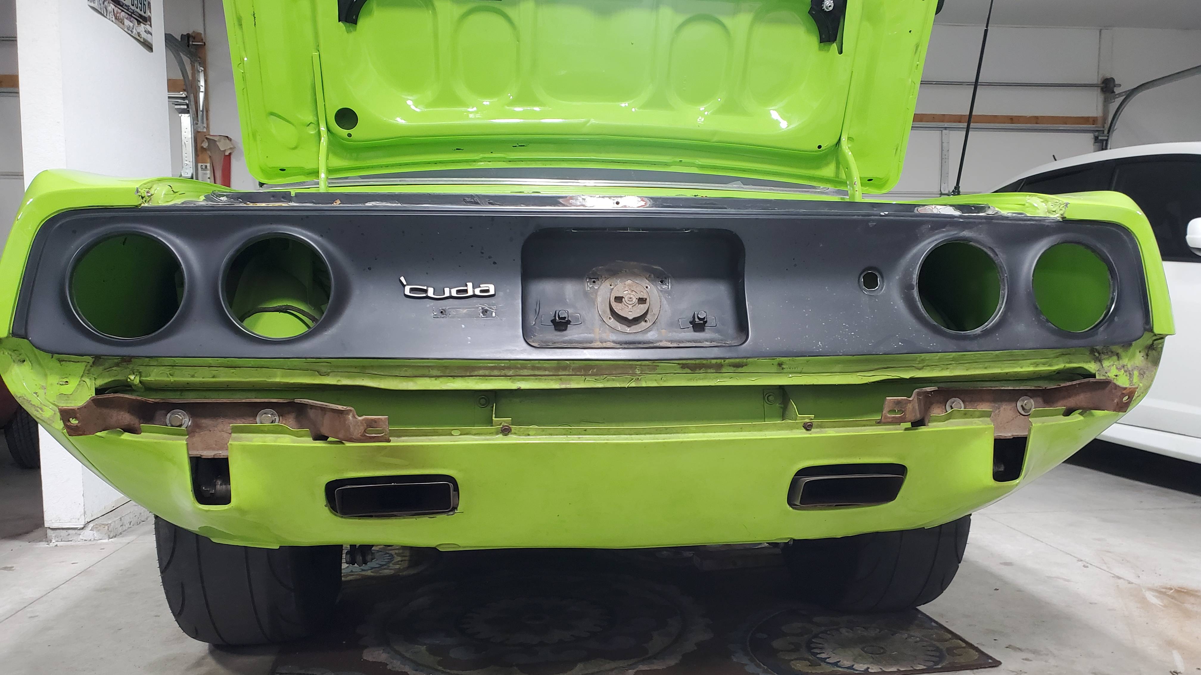

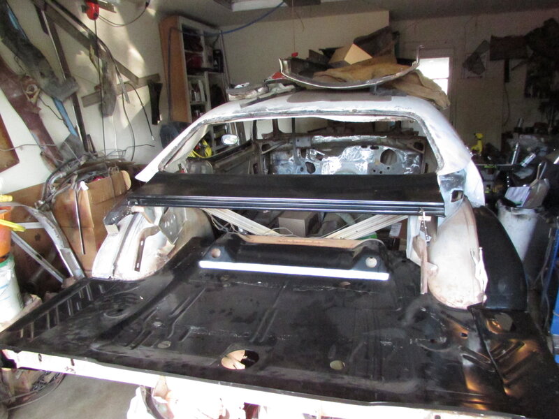

Figured out that I need to remove the center support or the tail panel will not go in... the factory welds are... interesting.

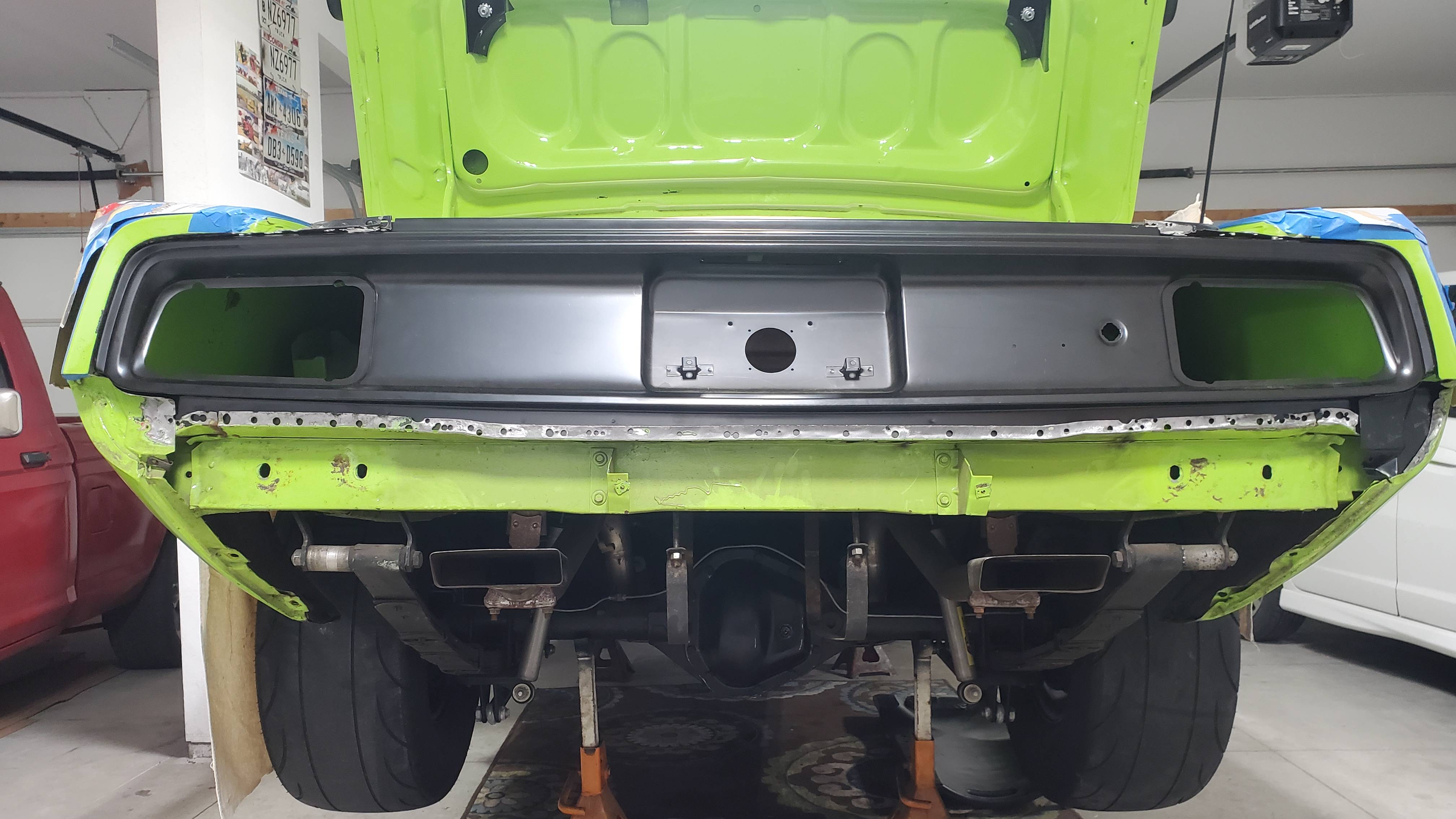

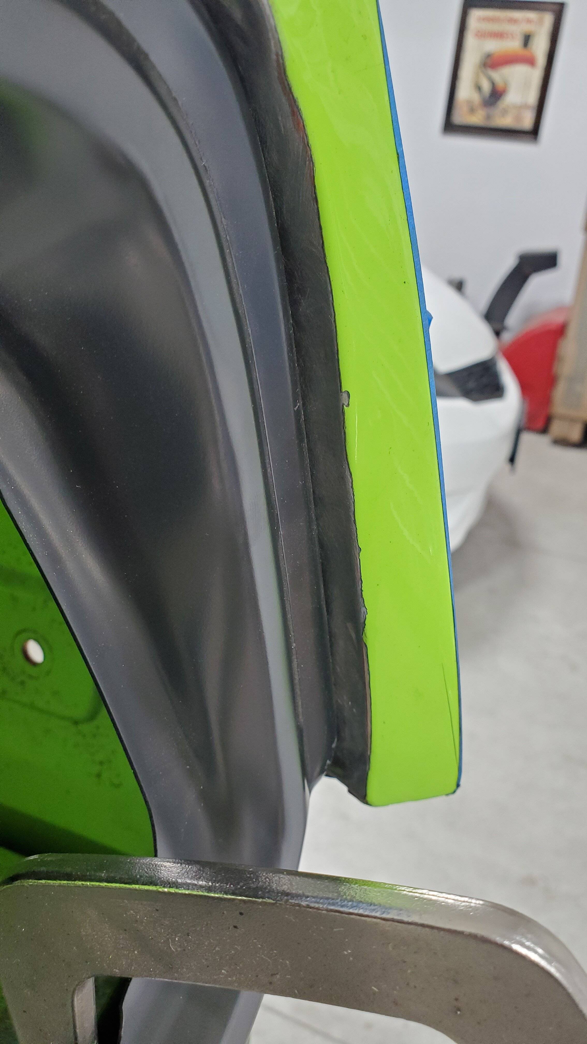

Racine, Wisconsin

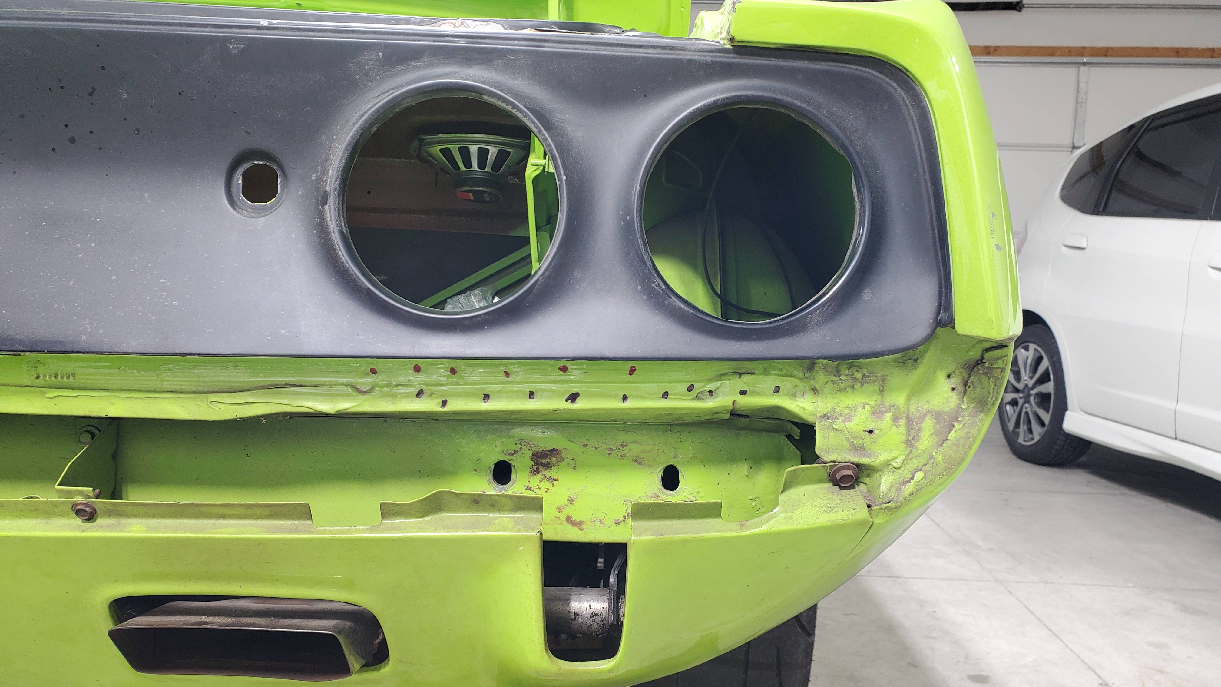

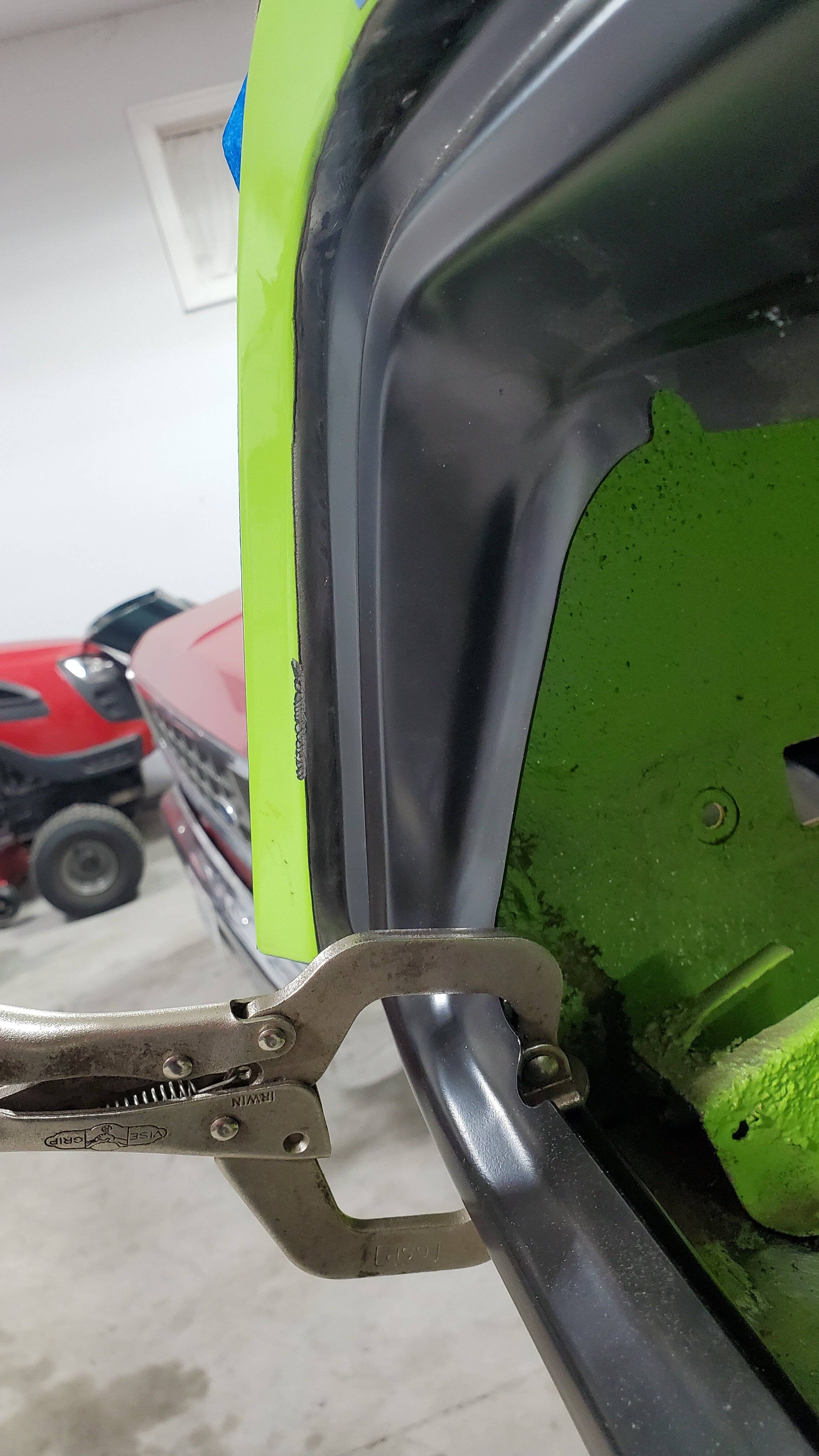

Test fit of the 70/71 tail panel. Bodywork is not my thing, so I am a bit worried about the fit up, but for a driver it is going to have to be good enough.

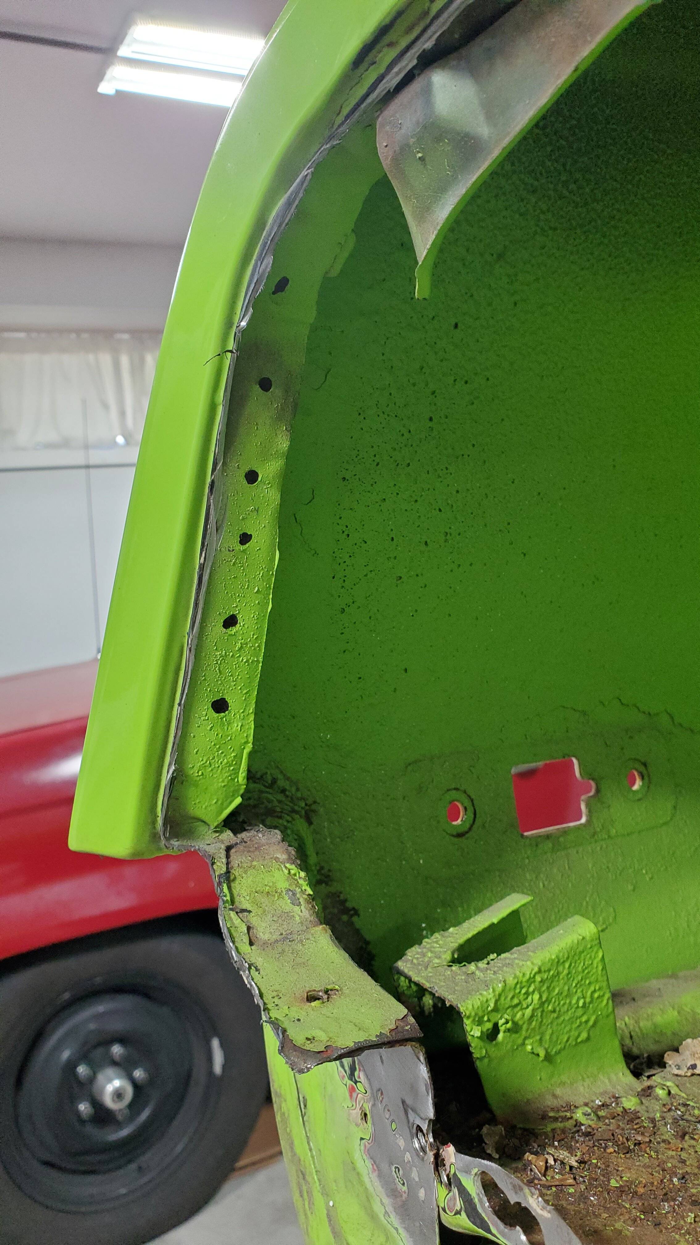

I started with the idea to save the old tail panel... it was not worth it... I spent several hours trying to find a way to remove the spot welds between the quarter panel and the tail panel... eventually I gave up and just hacked it up.

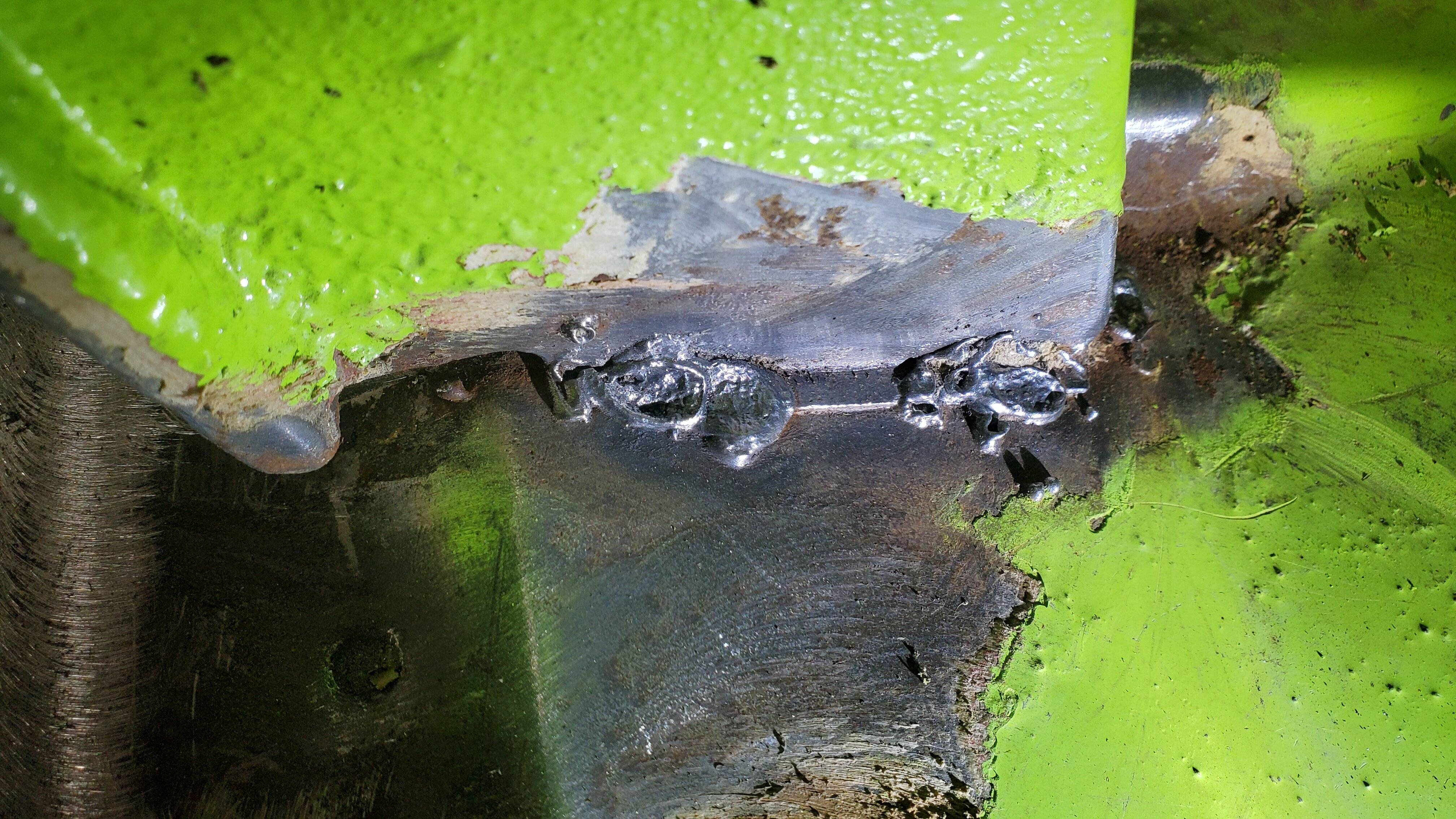

Racine, Wisconsin

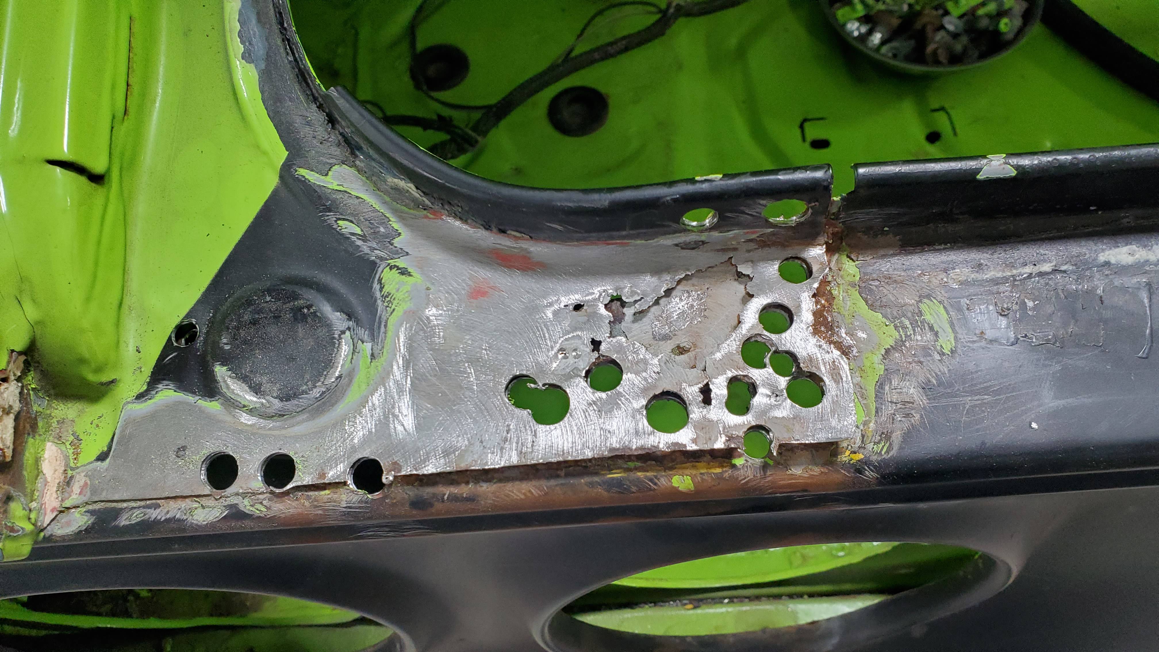

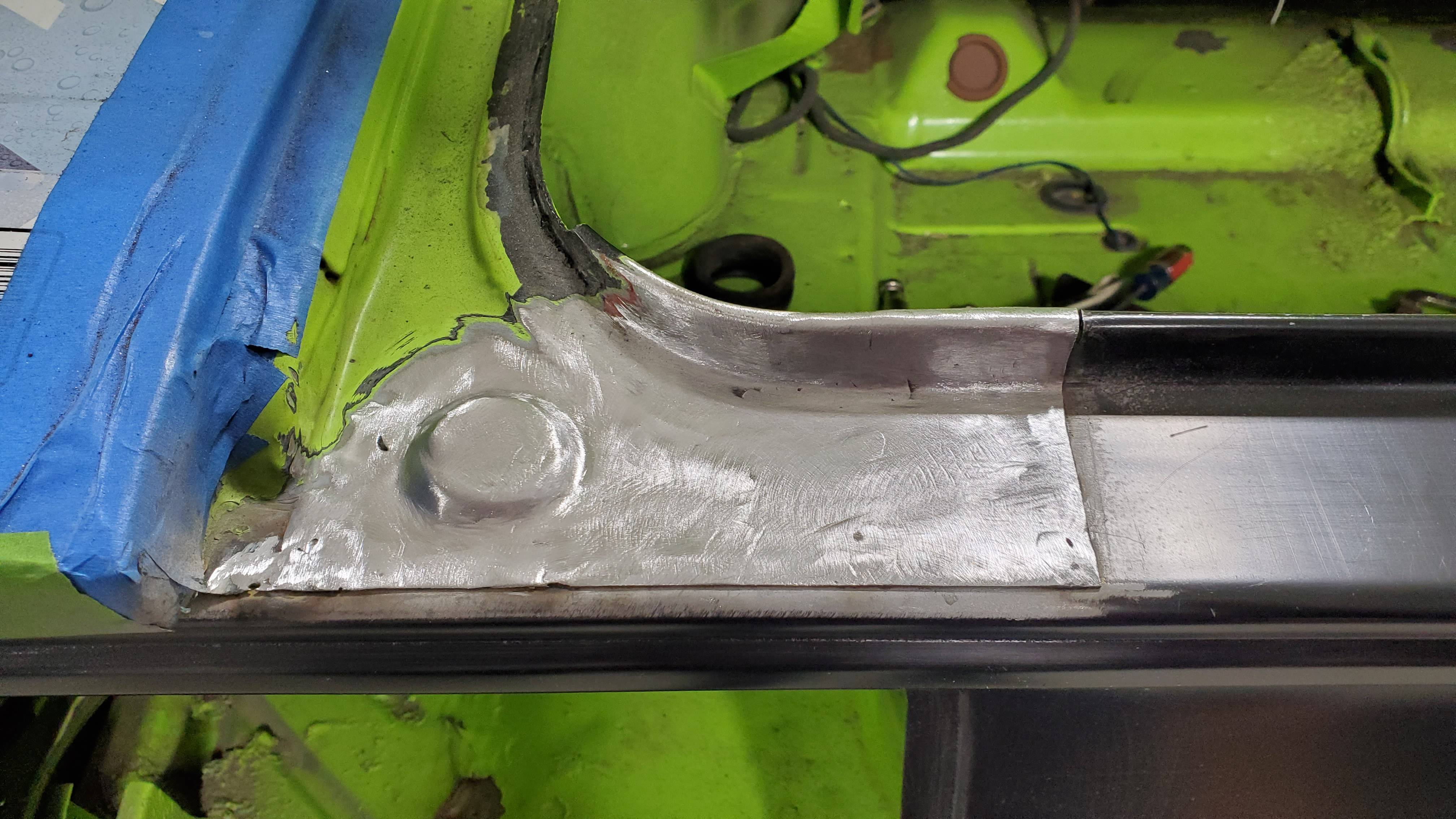

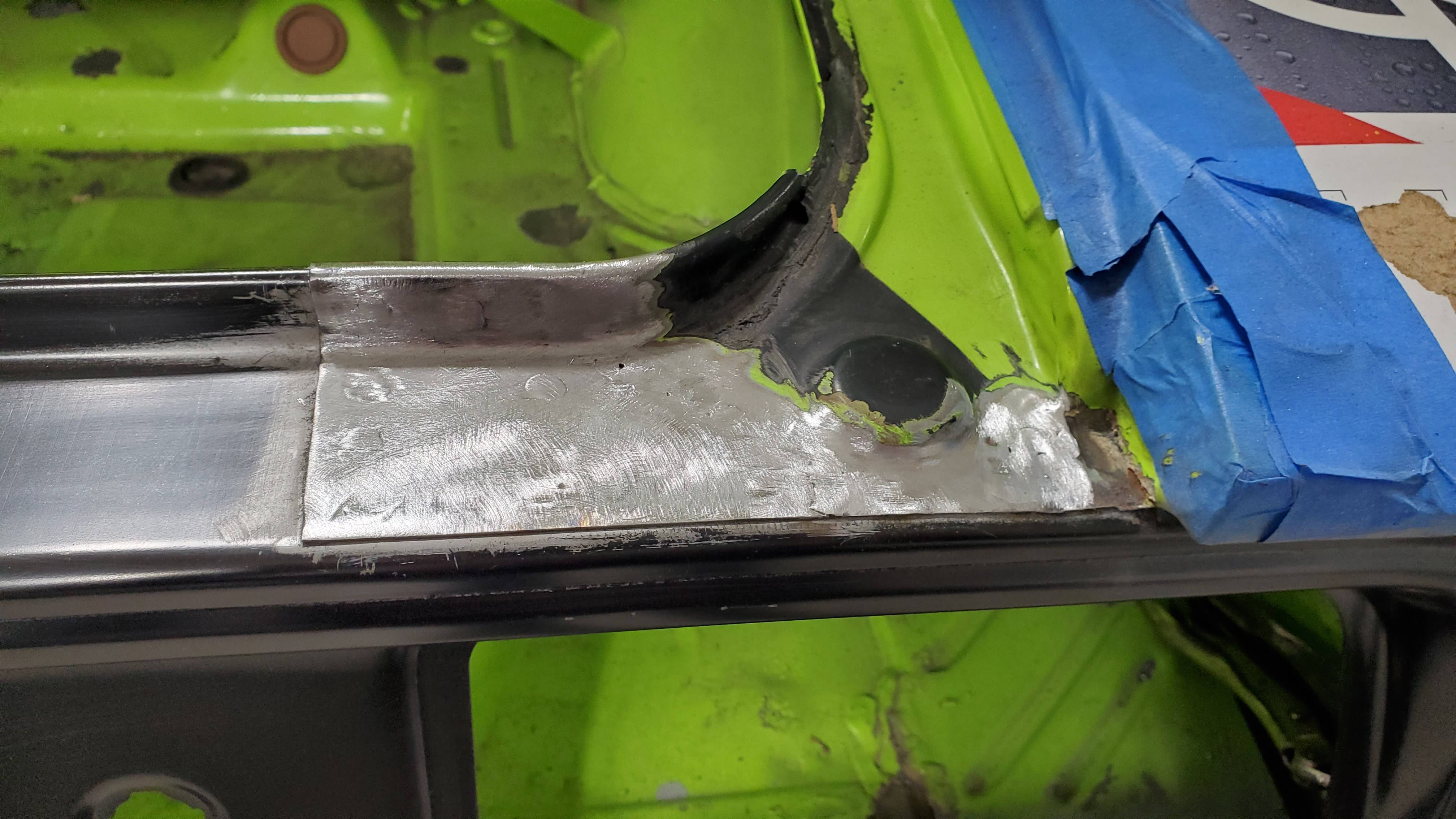

I am not sure if it is done right, but it is not coming back out while I own it.

Amarillo Texas

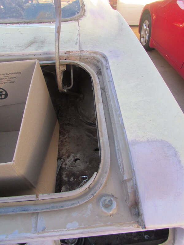

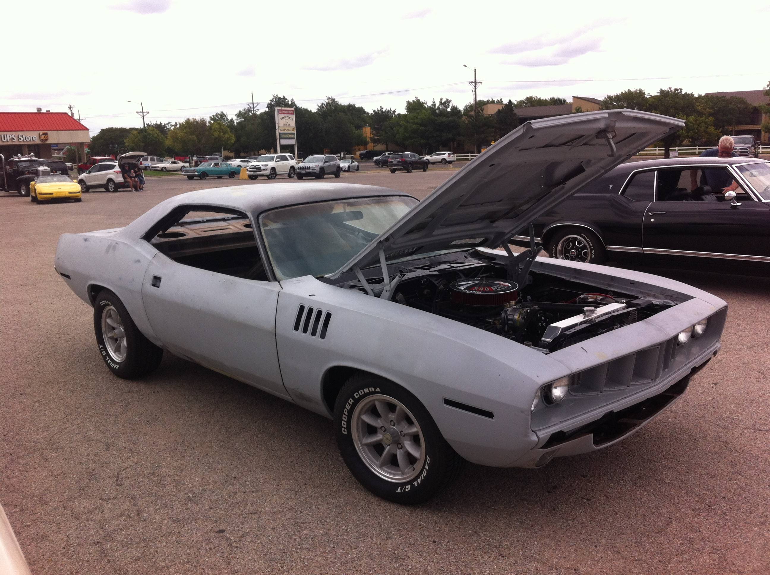

Here is a picture of my 71 before I took it apart. Had about a 1/4 inch gap. As long as the width of the trunk opening is correct, no worries.
