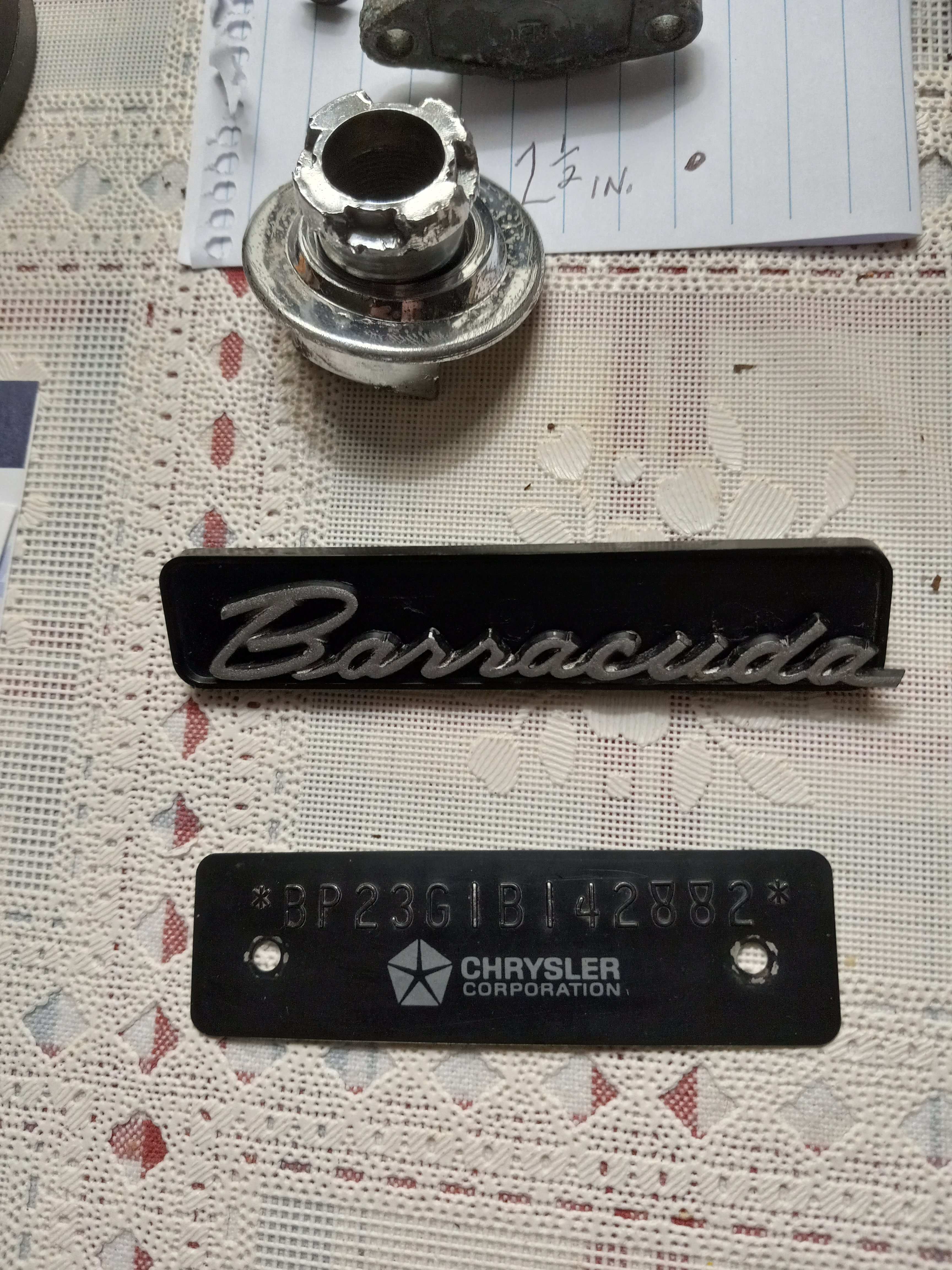

Had dash pad restored and took these off. Wanting to know the best way to reattach them.

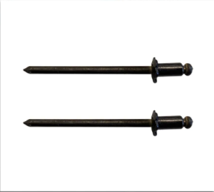

Roseville Moparts sell the rivets for the VIN.
[/URL][/URL]
For the dash Barracuda emblem, I'd just use a two part epoxy for vinyl.
The $45.00 for two silly rivets just because they have a hex top is laughable and a total rip off. You could buy over 500 regular rivets for that money.
There is a way to beat that and maintain the authentic look. You can use a small die grinder to grind off the backside of the rivet stud and then remove the VIN plate and keep the top part of the rivet and the piece of stud that goes through the rivet.
Now when you put the VIN plate back on, use a thin two-sided tape and then use a dab of epoxy in the rivet hole and underside of the rivet and insert them into the VIN plate holes.
Now take the $45.00 bucks plus shipping cost and go buy a bunch of beer.

To maintain that non tampered OEM look, you need those special jagged edge rivets which are non commonly available. Hopefully you have your original top part left so you could just epoxy that into the VIN plate hole and look correct.

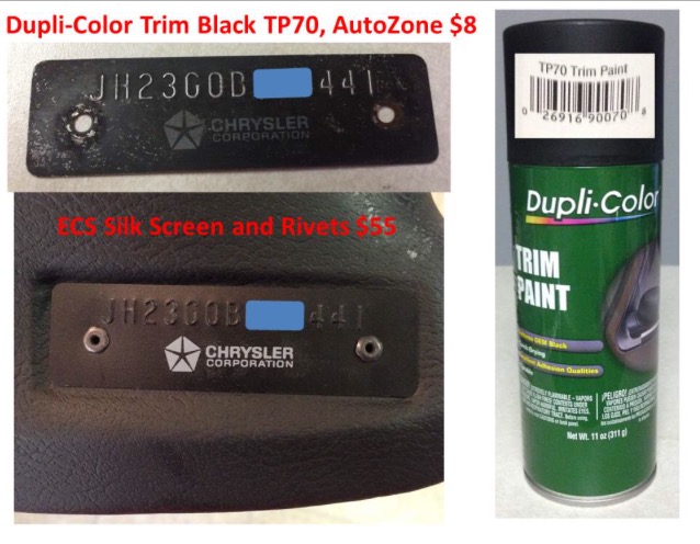

I didn't like the price either, ECS has a combo deal, rivets and the silkscreen transfer, but decided I'm only doing this once.
As they say, "Quality remains, long after price is forgotten"
