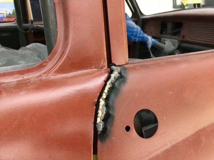

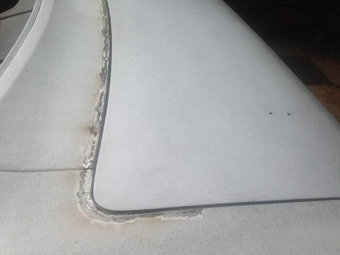

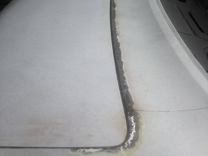

    I had same problem with my 72 cuda.I added a small strip all the way across the sail panel. lots IMG_3842.JPG IMG_3844.JPG of welding though .

    Good idea, Looks good. I'll let my paint and body guy know.
