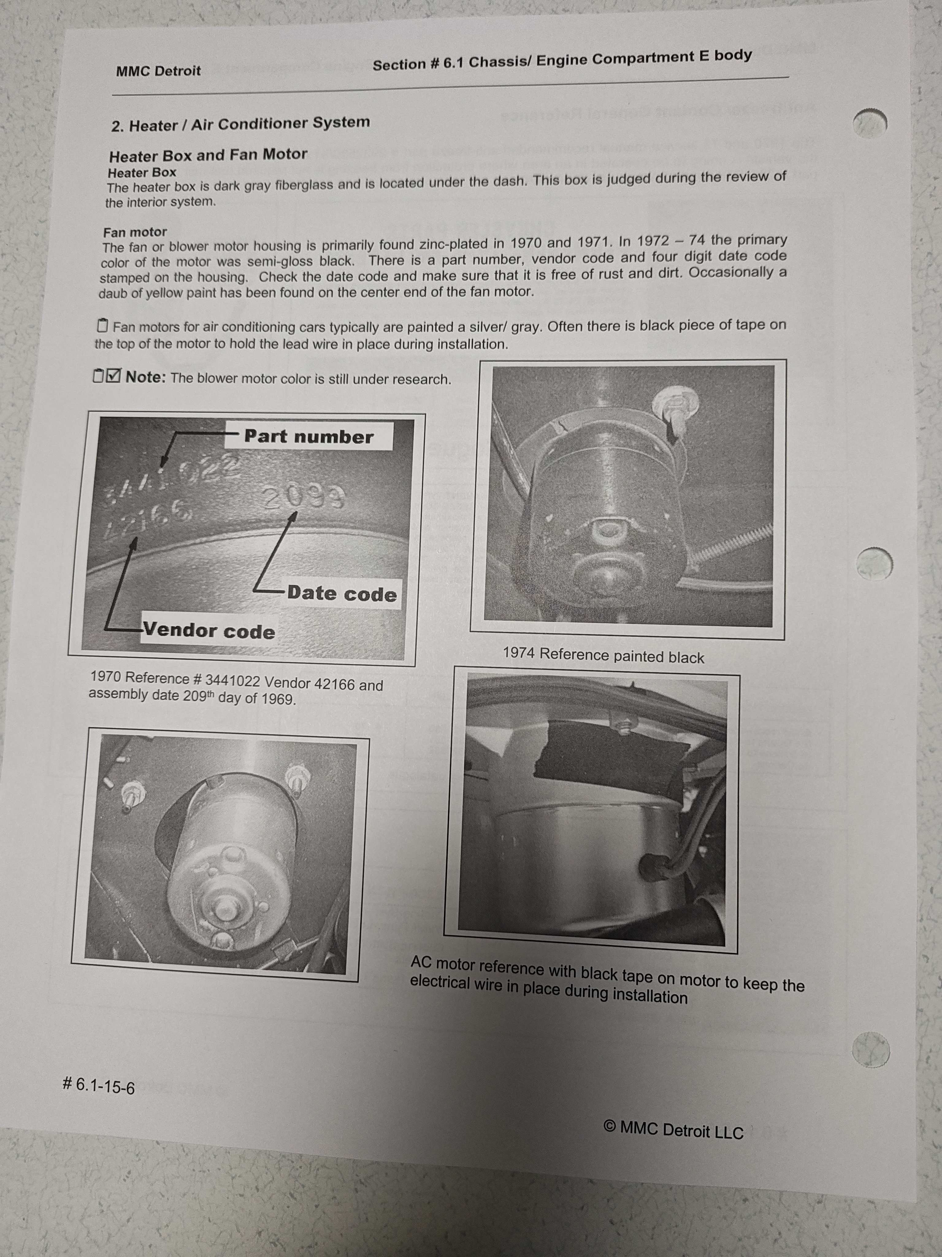

Aug 8, 2024 #2 Xcudame Well-Known Member Joined May 27, 2023 Messages 2,184 Reaction score 1,581 Location Southeast Arizona Silver phosphate. See below. Clearly not black.
Aug 9, 2024 #3 K KennyCuda Well-Known Member Joined Aug 3, 2020 Messages 407 Reaction score 59 Thanks they look to be a silver color the nuts
