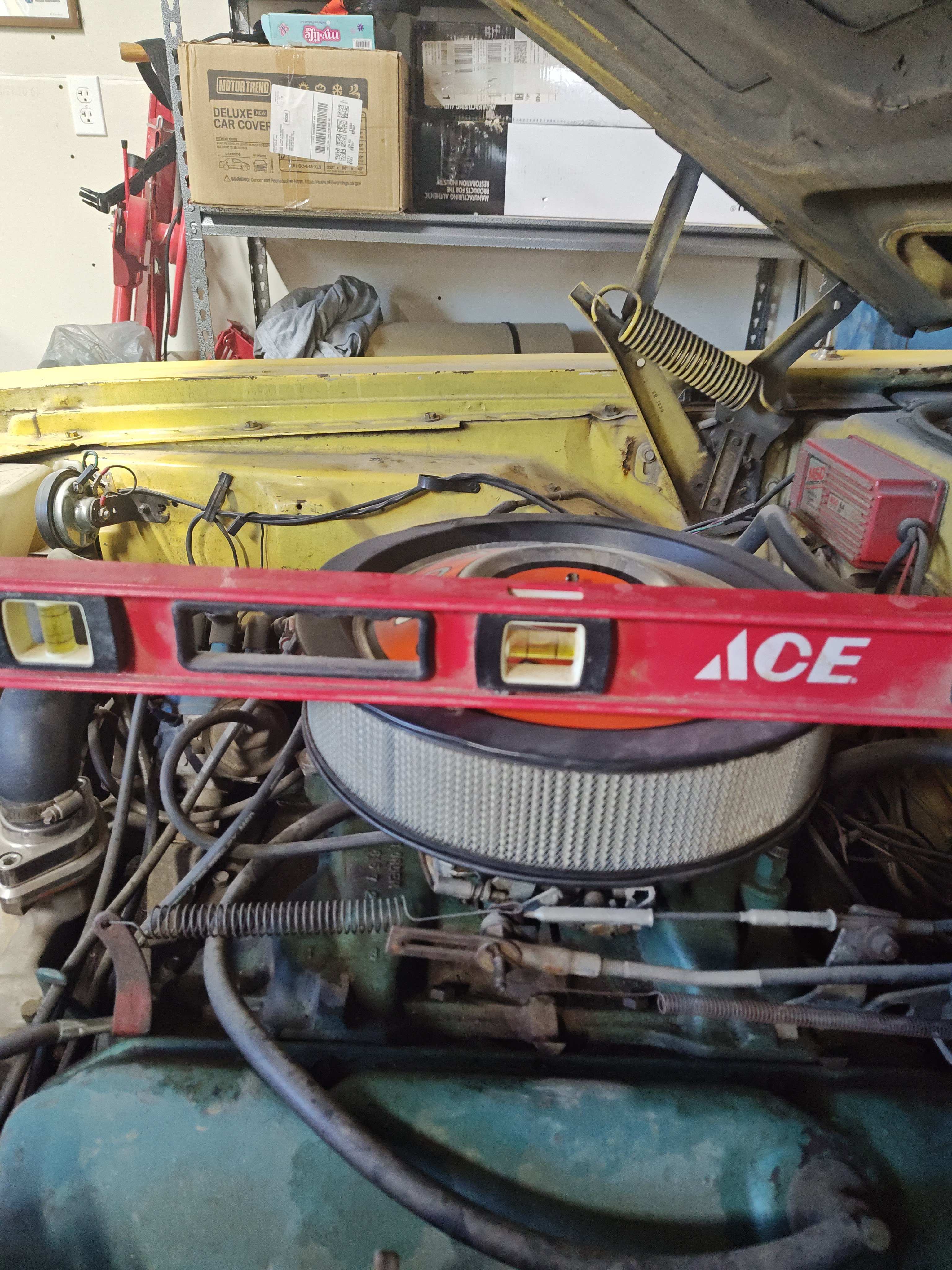

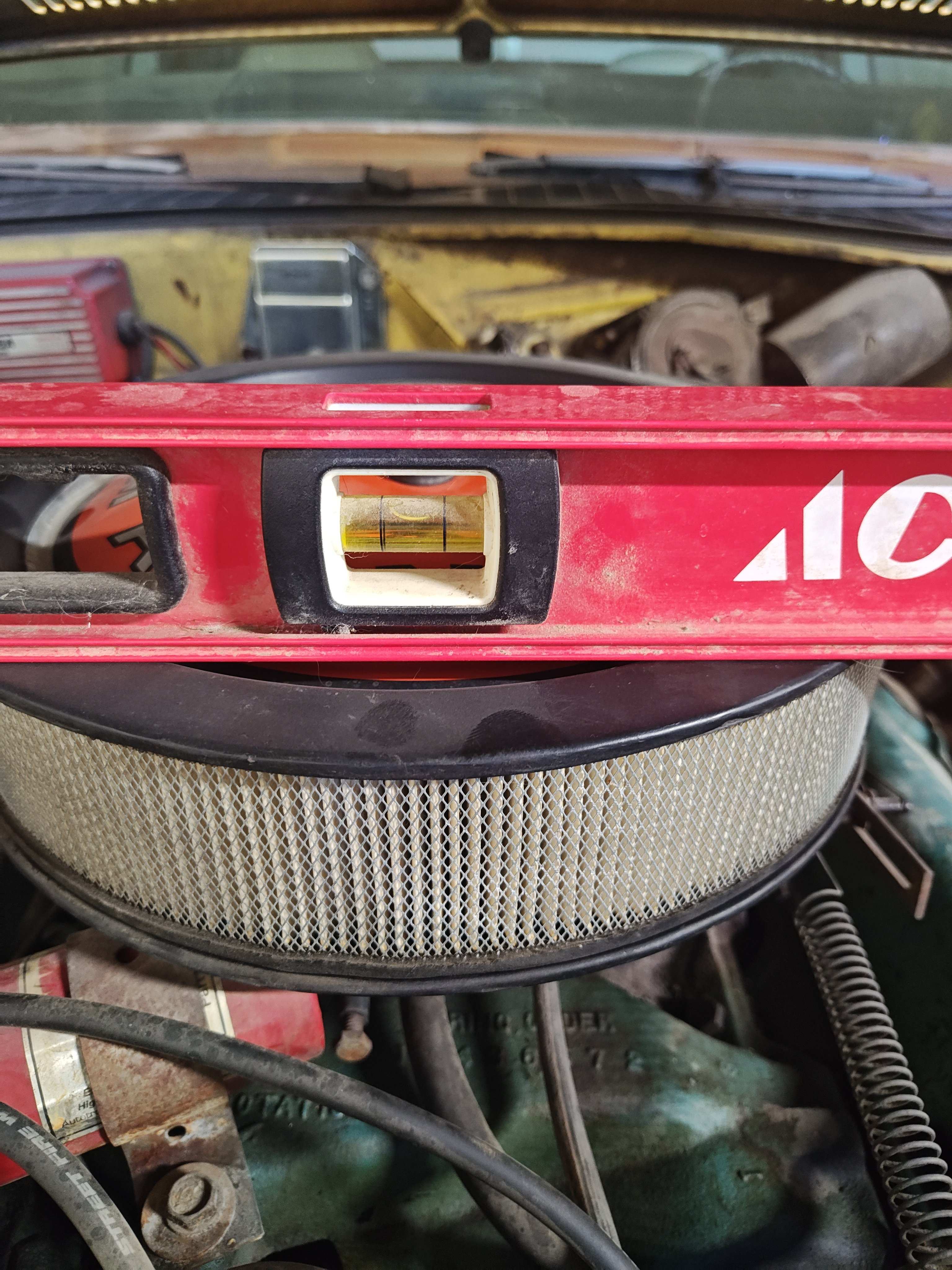

The motor sits lower on the passenger side than the driver side. Is that normal or should it be level?
440.
Should be pretty level side to side. Front to rear is pretty level too. I didn't check the tire pressures before measuring, but they look about the same.

Just an update. Motor mounts were good, the air cleaner was bent and made it look tilted.

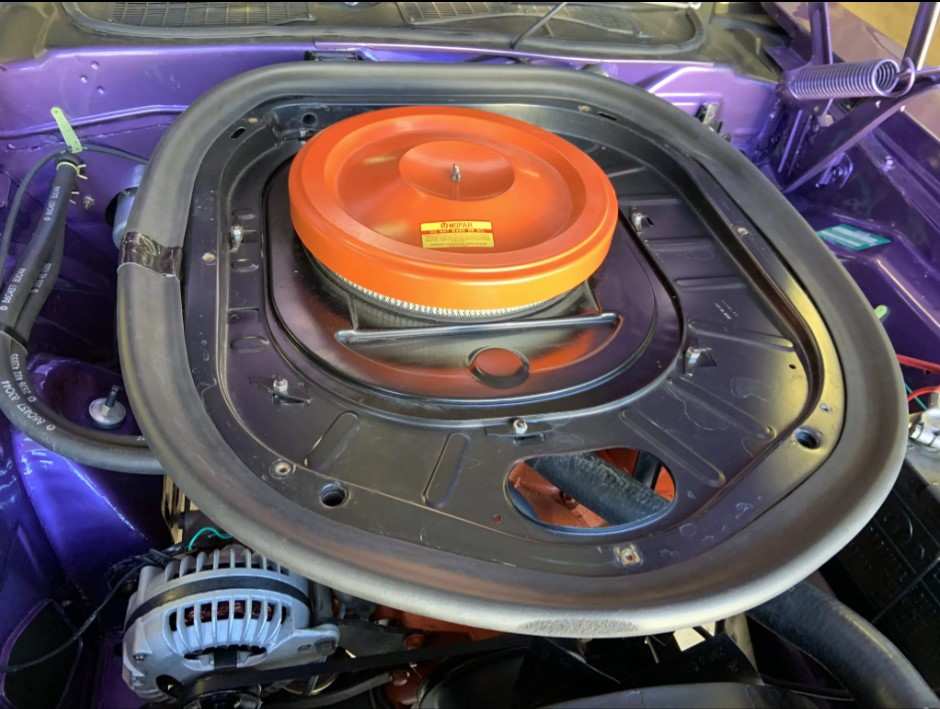

Here is another stupid question. Does the engine sit directly in the center of engine bay? Side to side. Would the center of carb be directly over center of hood?
The engines are offset toward the passenger side. Extra clearance for the steering gear.
You can easily see this when looking at a Shaker baseplate/adapter ring.

Throwing another comment here. If you zoom in on my photo of the level, you'll see it's slightly sloping to the passenger side. That's so when I'm in the car, it's almost perfectly level. Of course passengers change things. There is some rake where the rear of the engine is lower than the front. And obviously the whole engine is shifted to the passenger side for axle alignment and room for the steering gearbox. Ideally the driveshaft should be sloping down from the back of the transmission to the rear axle the two degrees at most. Everything level would be ideal, but it's not likely to happen with the given geometry.
