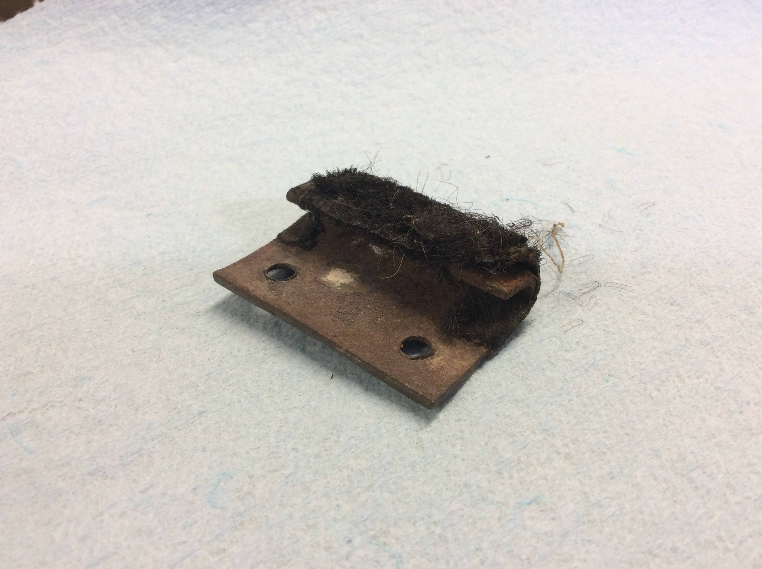

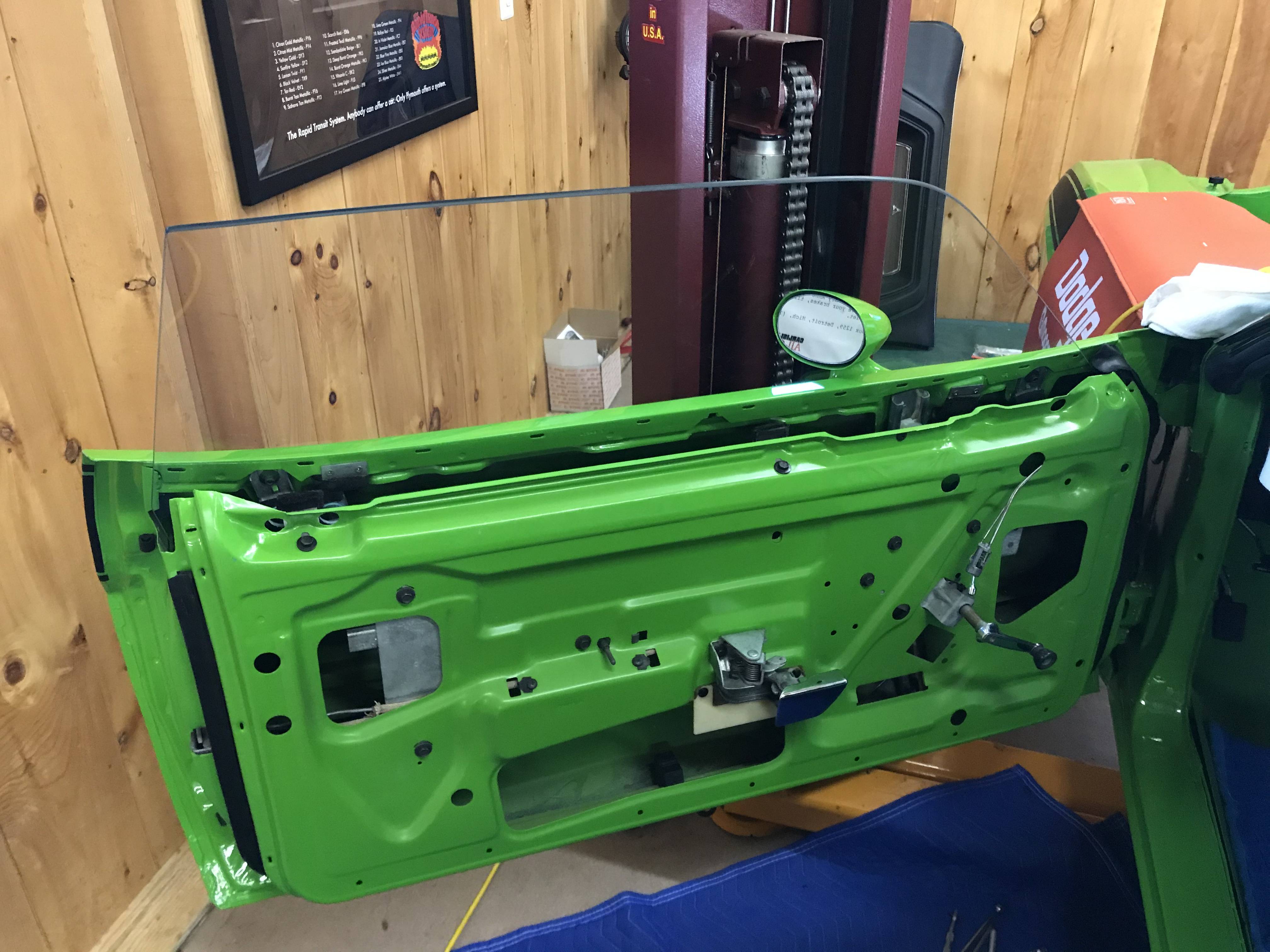

We installed the driver side door glass today on my ‘70 Cuda. Got all right parts in the right places, except of course, one piece we can’t figure out. Any help is much appreciated, and, yes it will get the resto treatment before installing.

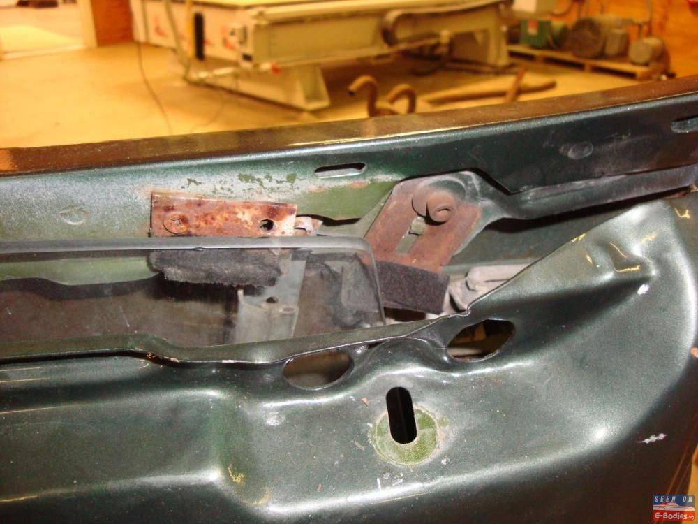

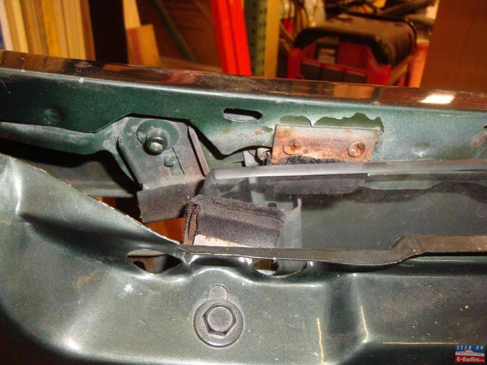

here try these

Floyd posted a great picture. Does anybody have a similar or individual pics for mounting all the stops and bits on a 70 cuda door, outer skin?? I find ZILCH for help on a web search. Most of the attaching holes were never stamped into my NOS door-skins. Typical for NOS sheet-metal.
