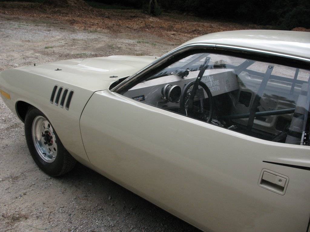

Car is currently set up with Lexan windows ( former Drag car)
I want to put door windows back in- need every thing - tracks- regulator -windows
