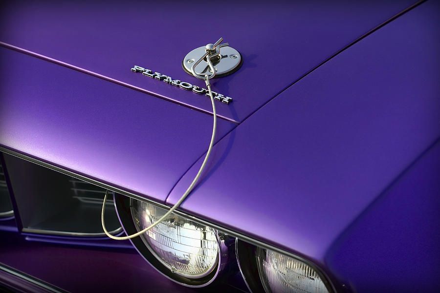

The 1971 hood gained the "PLYMOUTH" emblem in front of the driver's side hood pin.

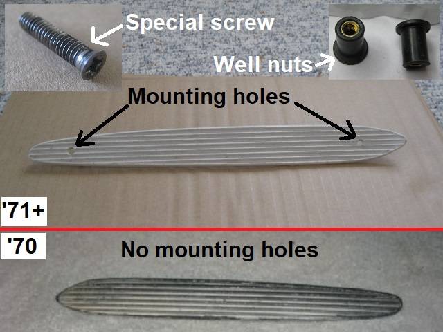

AFAIK hoods are the same. I'd like to add to everything MoparCarGuy said. The scoop inserts are different for 1970, they mount from the back with PAL nuts. The scoop has to come of to do so, maybe that's why Mopar went with screws & well nuts. There's a reproduction out there with no holes that advertises as '70 to '74 but technically those are correct for 1970 only. I pointed that out to the maker and he said buyers can just drill holes if they choose that style.
