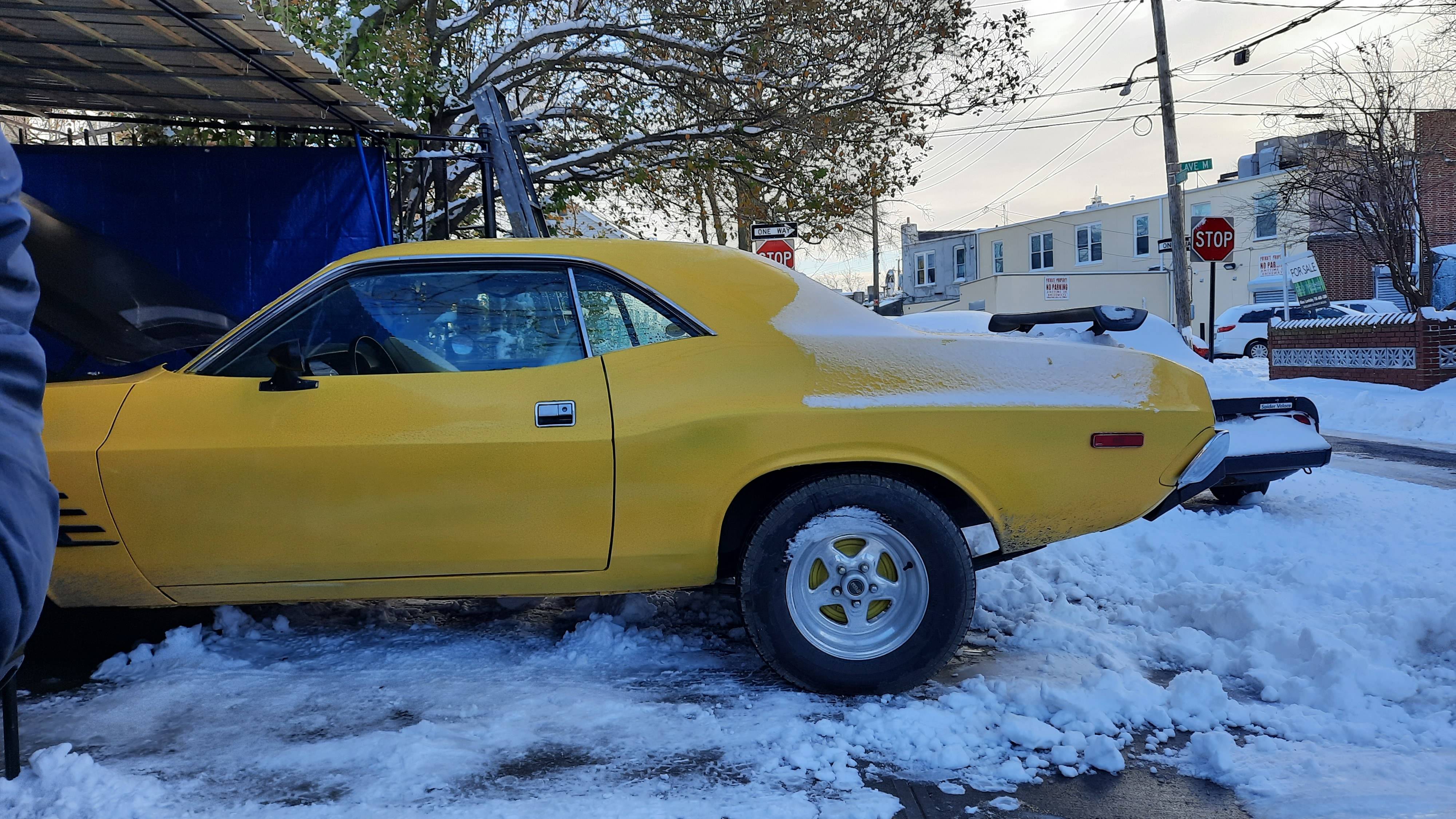

Good evening, i change the rear shocks today and shocks seems short full extend, car sit pretty high and look like some heavy or SS springs, is there longer shocks brand, part numbers ?
I change shocks with car on ground thank you for any help.

I assume you have air shocks back there. Take them off( before you damage the shock mount cross member) and get the proper springs. Then you can use the proper shocks. Shocks aren't too short, rear end is up too high.

Nice looking ride!

Welcome to the forum. Yes, you could use longer shocks if you are going to keep the back jacked up. If I remember correctly, I used shocks for a Chrysler imperial as they are 2 inches longer And mount the same as an E body.

Nice looking ride!

Again, your shocks are probably not too short. Your car is raised too high. A longer shock will extend farther BUT it will not collapse as far.
So it can bottom out and be damaged or cause damage to the shock mounts. What did you do?
