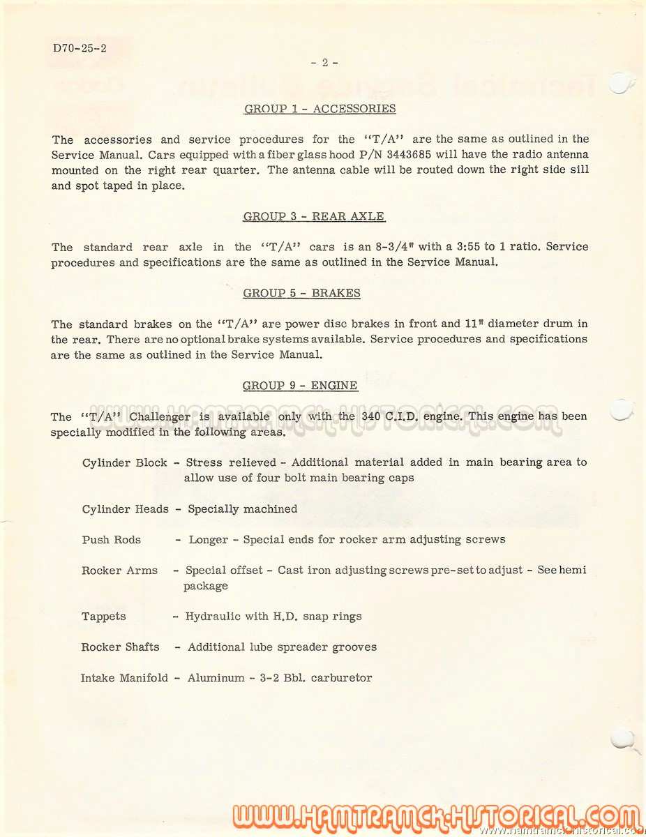

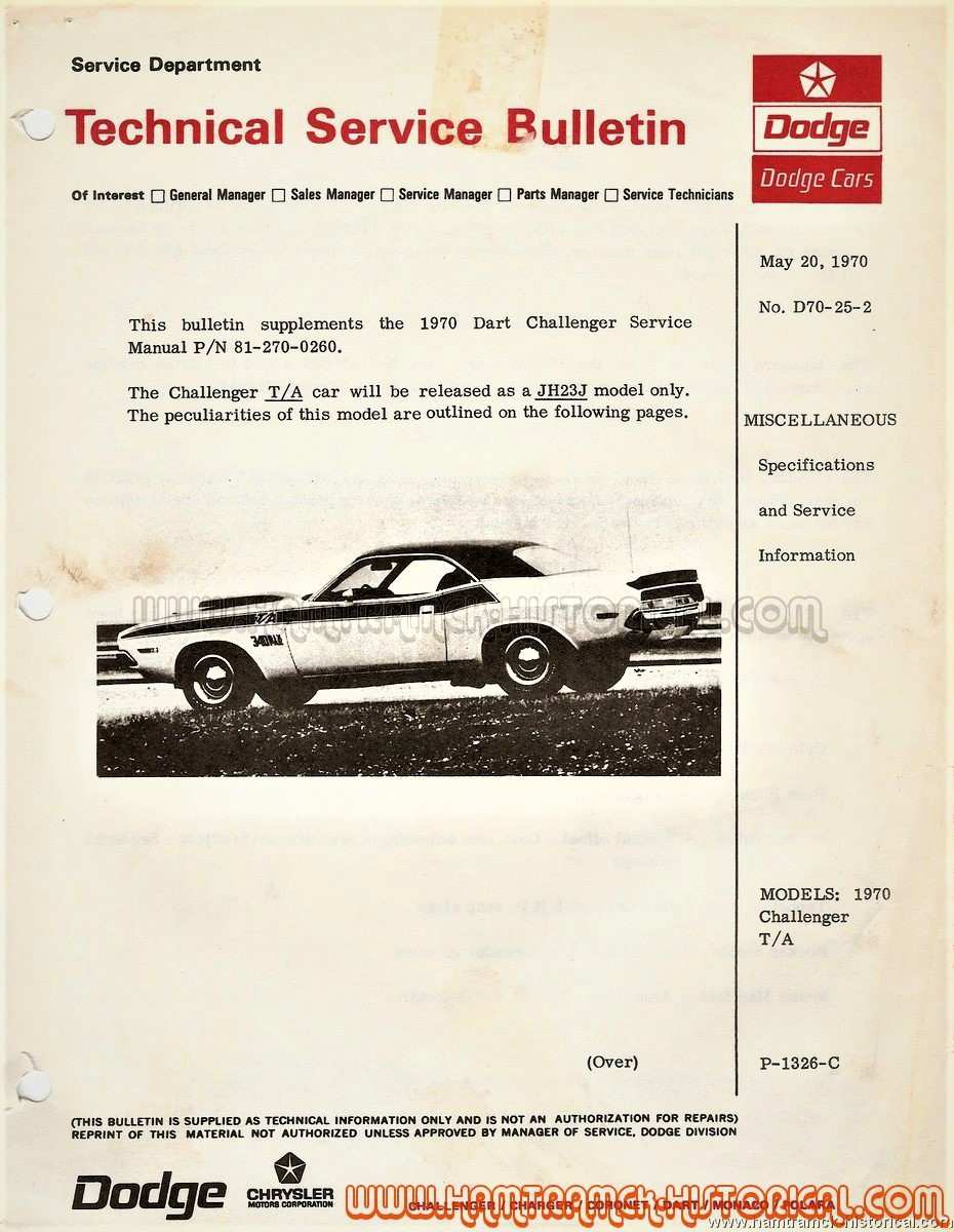

moparleo
Oct 17, 2011
6,939
1,727
T/A

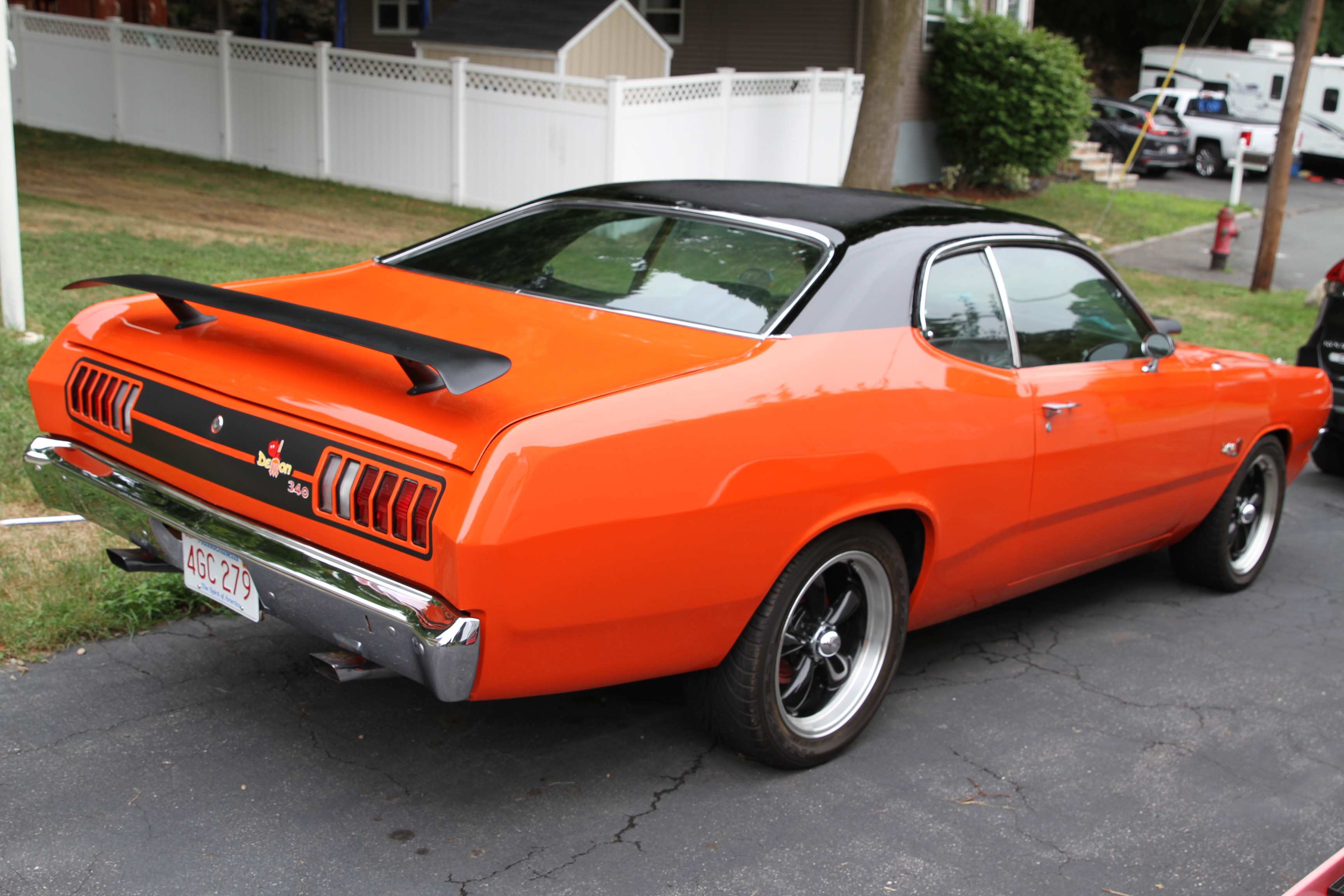

transam
Apr 19, 2018
28
5
Hi guys Im from the forabodies forum in hopes for a little E body guys help. I have a 1971 Dodge Demon 340 that I am building as a T/A package car. I want to add all the T/A options as if you could order it on the Demon/Duster too. I have most of the list accomplished but I cant find what shocks were used which brand and type. I have The sales brochure for the T/A Challenger had the following options which lists special heavy duty springs and heavy duty shocks. I installed Eaton heavy duty springs on the back but what shocks do i get? The bold text is what i have from the T/A package already and need the rest.
- 340 6 pack intake
-HD 4 speed with hurst pistol grip or 727
- HD "trans am" suspension that includes front and rear sway bar and "special" heavy duty springs and heavy duty shocks
-Hi flow cast iron exhaust manifolds
- side transverse flow dual exhaust
- rear spoiler
- eyebrow front spoiler
- fiberglass hood (will be doing six pack hood)
- non-glare fender tops and grille (matte black)
- TA side stripes (had custom made for demon side)
- front disc brakes (have 4 wheel disc)
-fast ratio power steering box
- sure grip differential 8-3/4 3.55 or 3.91

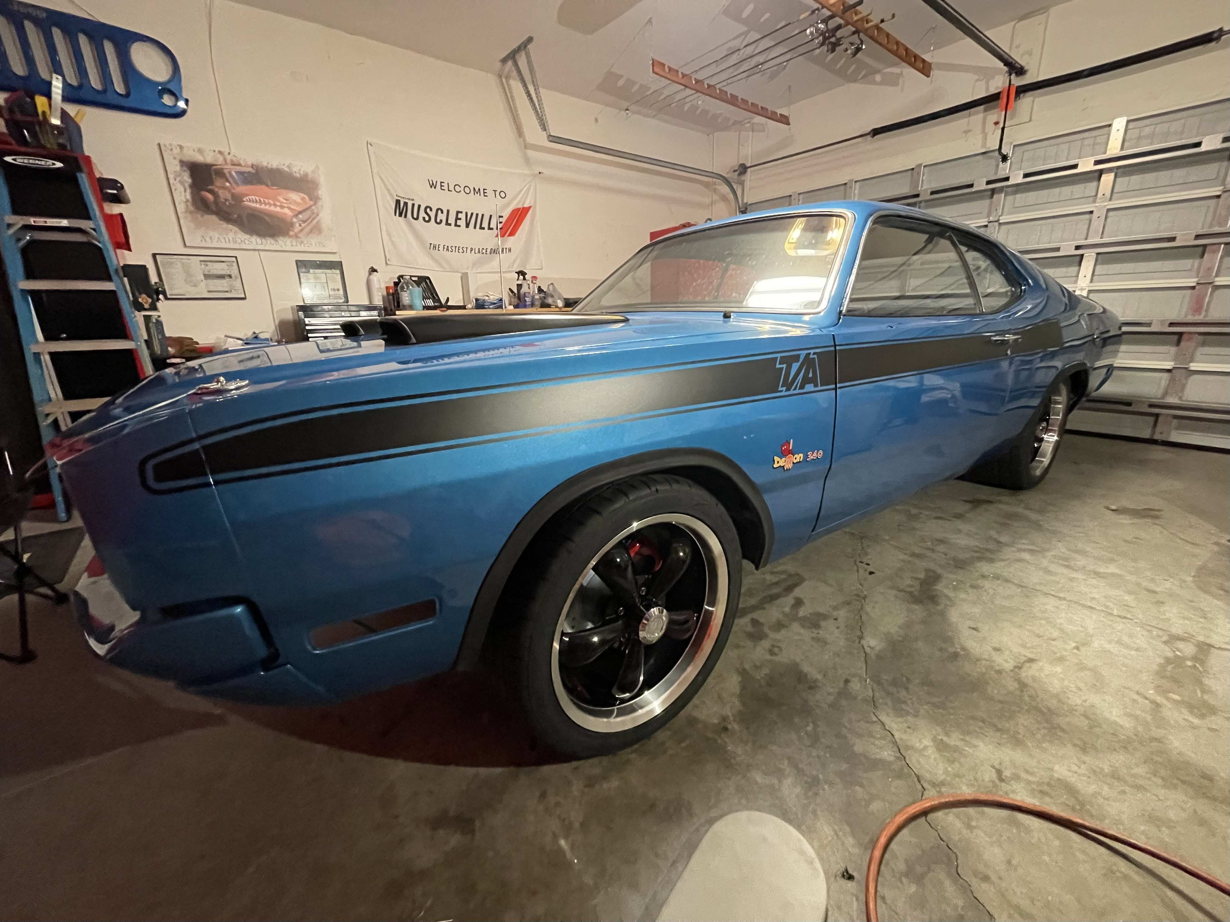

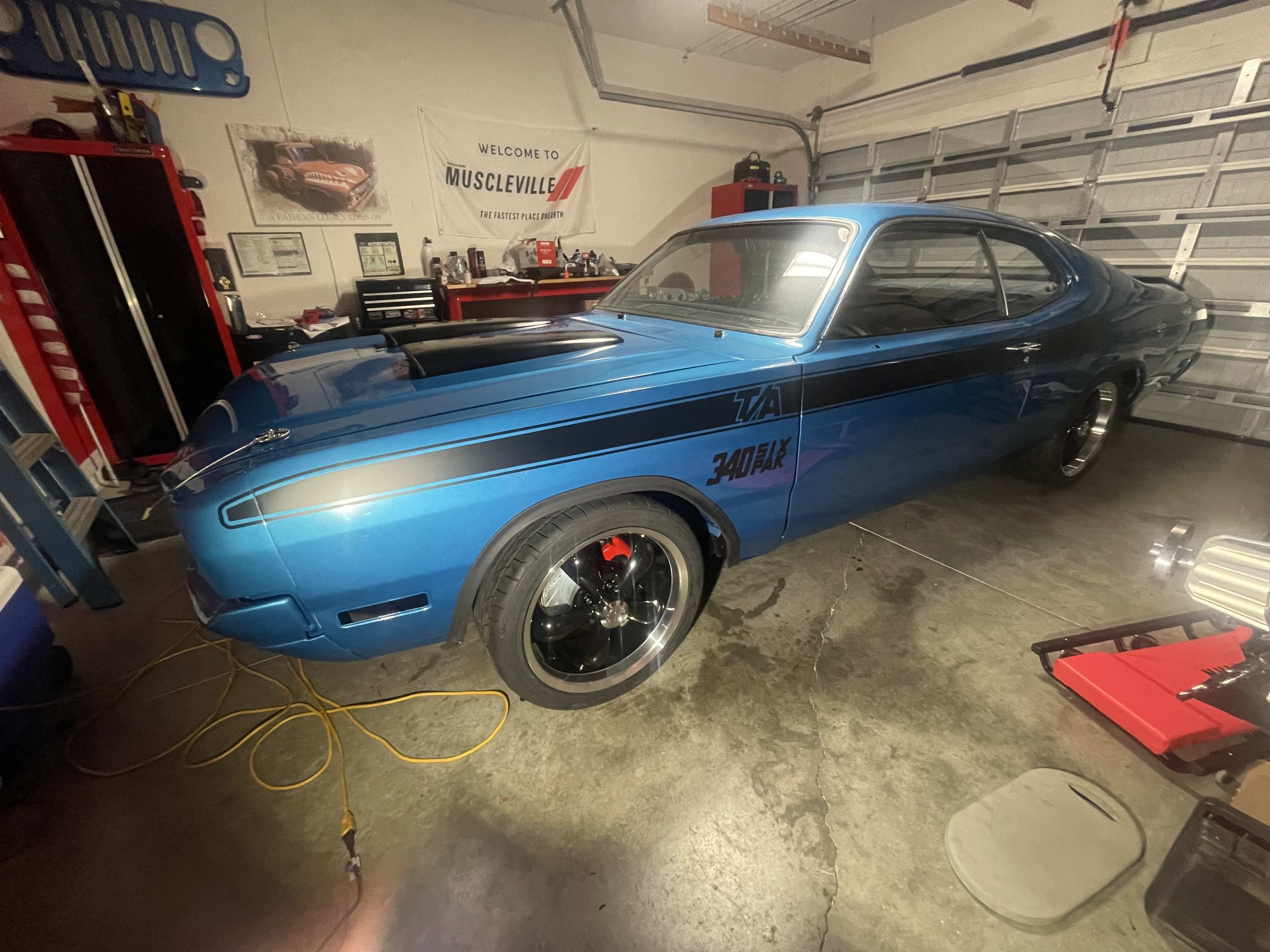

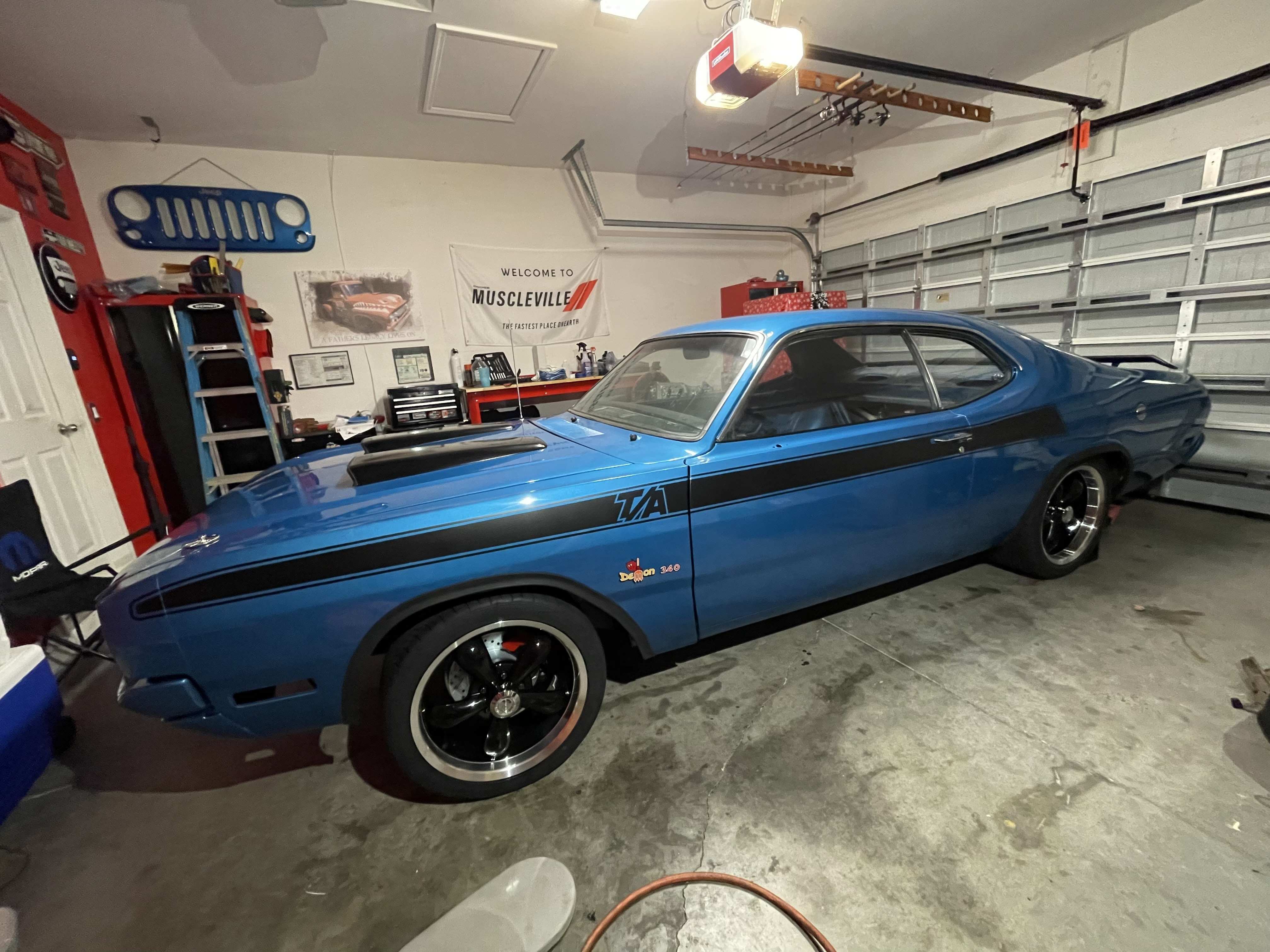

Here is mine. Still have not decided to install side stripes or not. Looks like we liked the same wheels and tires.

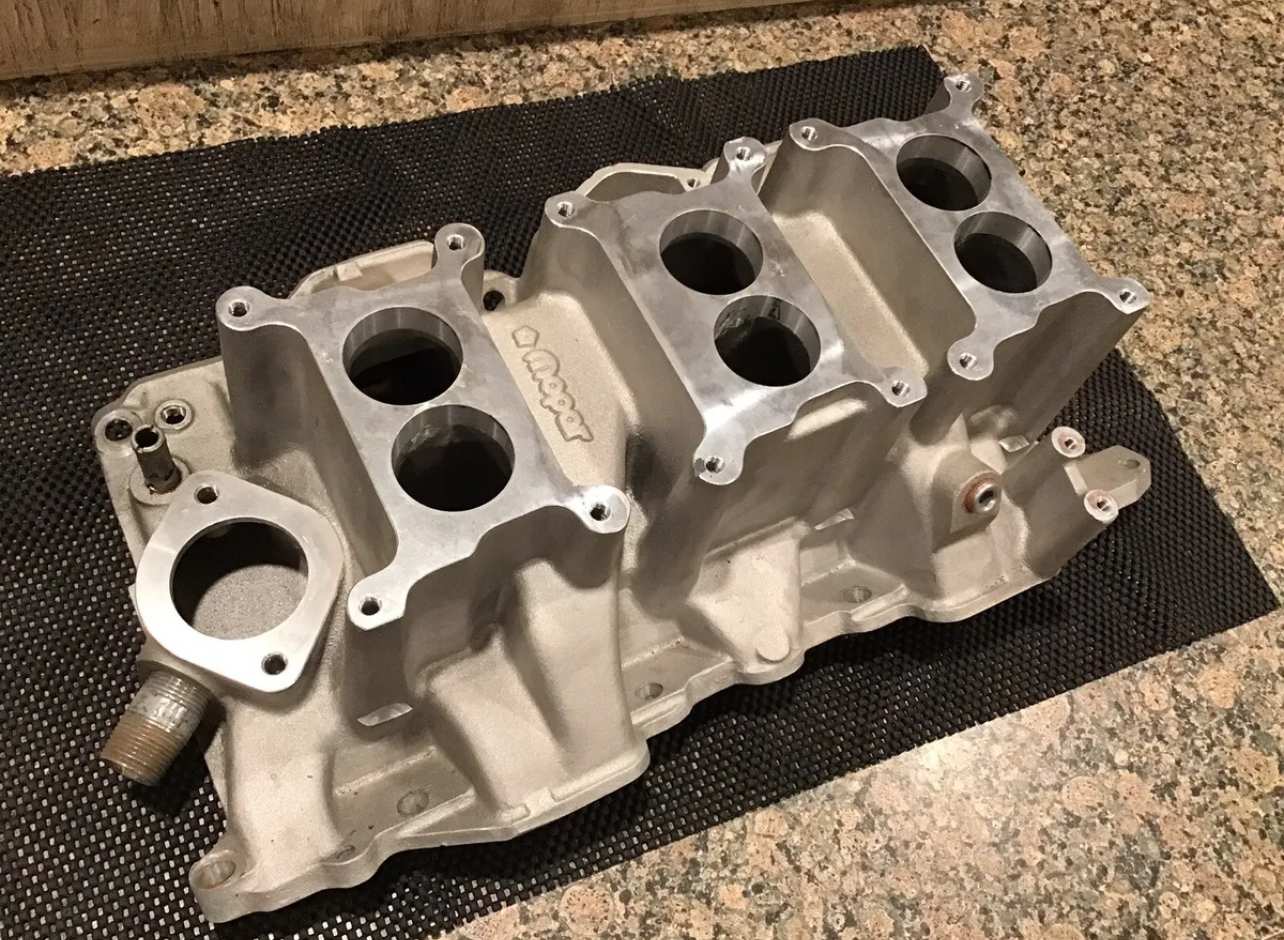

Just got in and added the 340 six pack fender designator decals and just got my six pack manifold on ebay, once that goes on it time to drop her in the Demon
