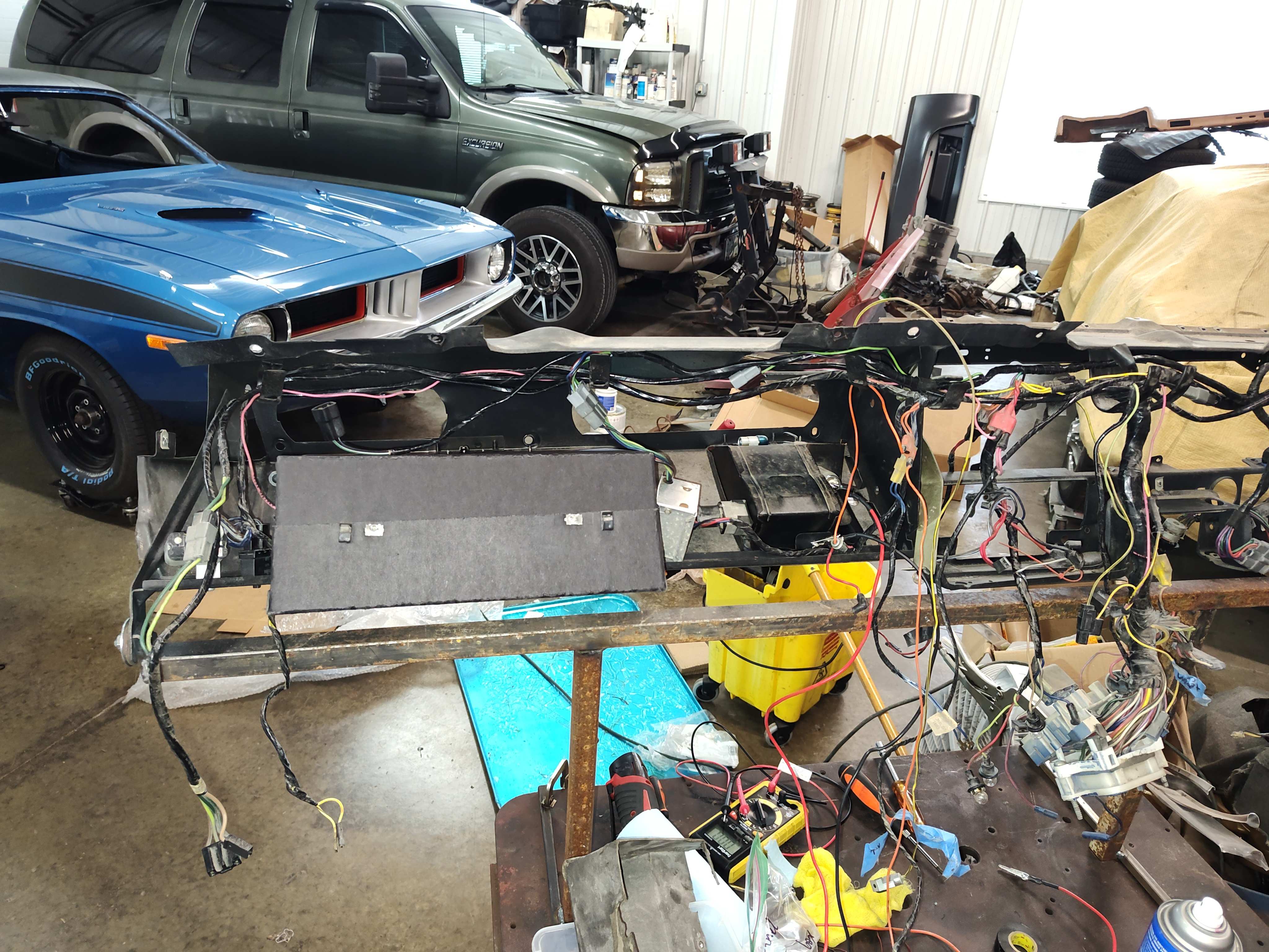

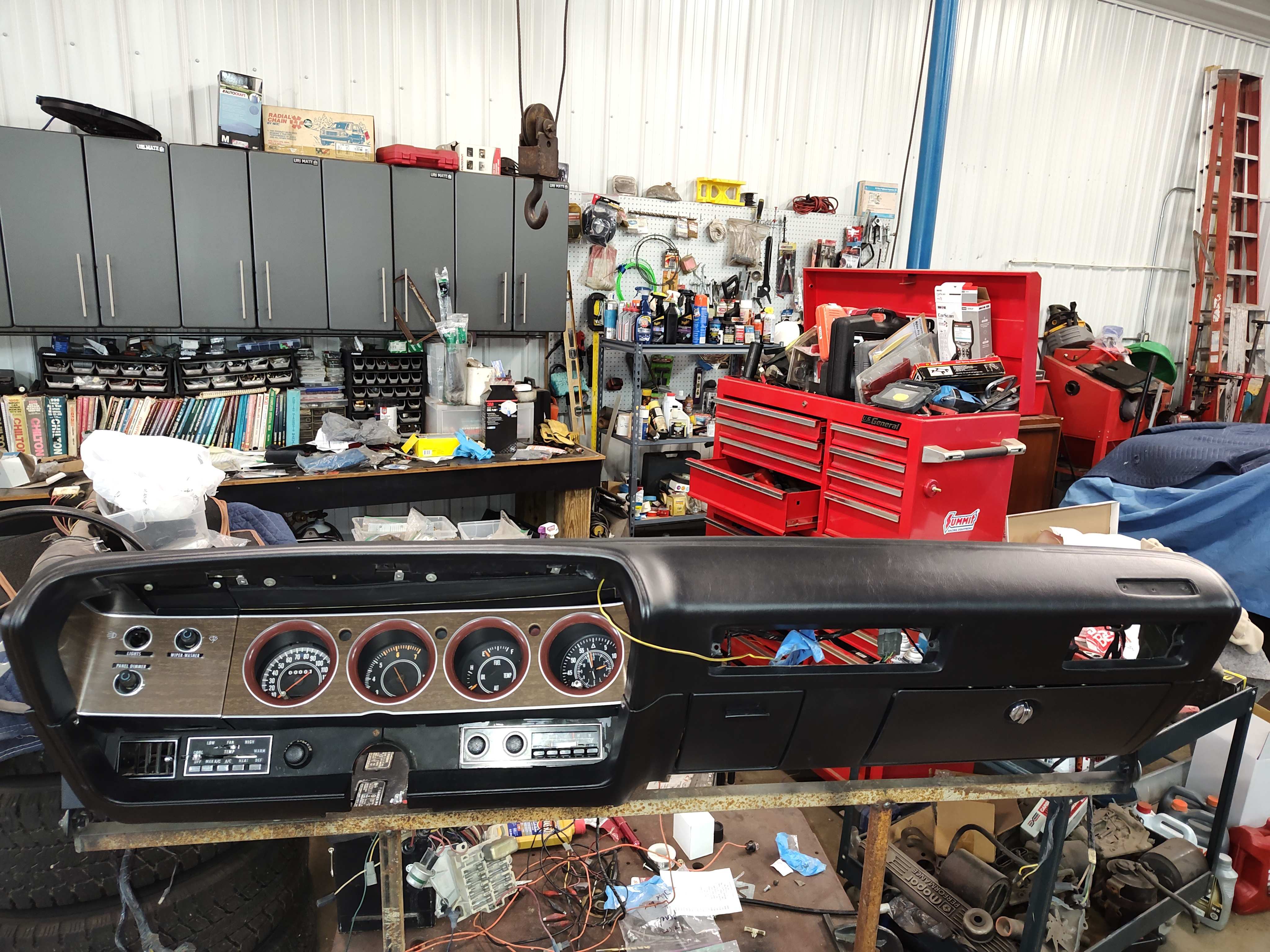

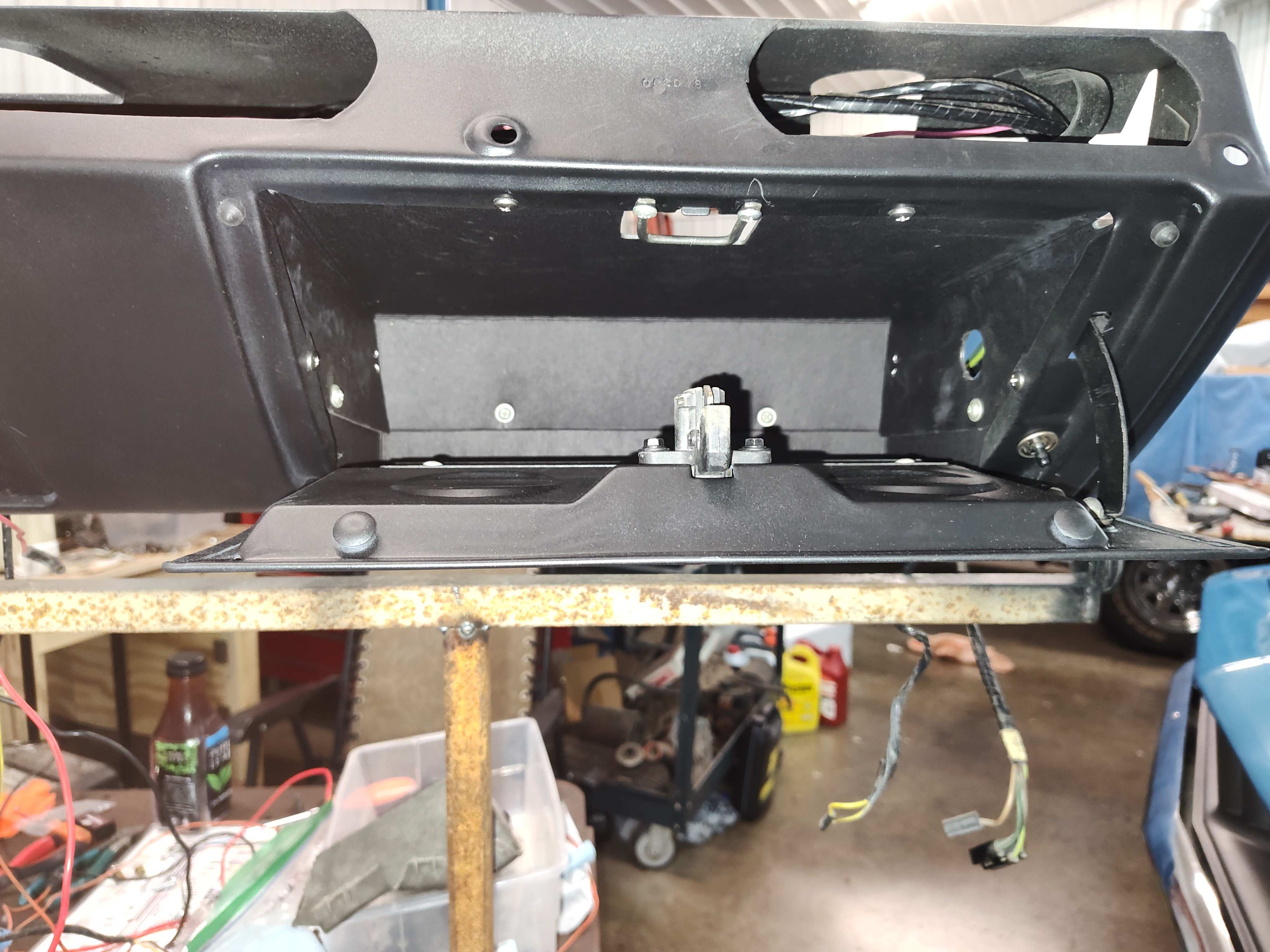

Unfortunately I don't have any experience with changing a dash pad in place but from my understanding it can be done but the front four screws require some creative use of I'm extensions and swivels. I decided to refurbish my entire dash so I pulled it. I was surprised how easy it was. When the steering column down it was a matter of literally four screws in the front the two nuts on the side and disconnecting the fuse box heater cable wires in a couple of vacuum hoses. Once you have the dash out it's nice because you can go through and fix wires and light bulbs etc. I've included a couple of pictures of my dash frame mounted to the jig.
Thanks. That looks like you are doing OK with some daunting work. Also, classic looking Cuda you have there!

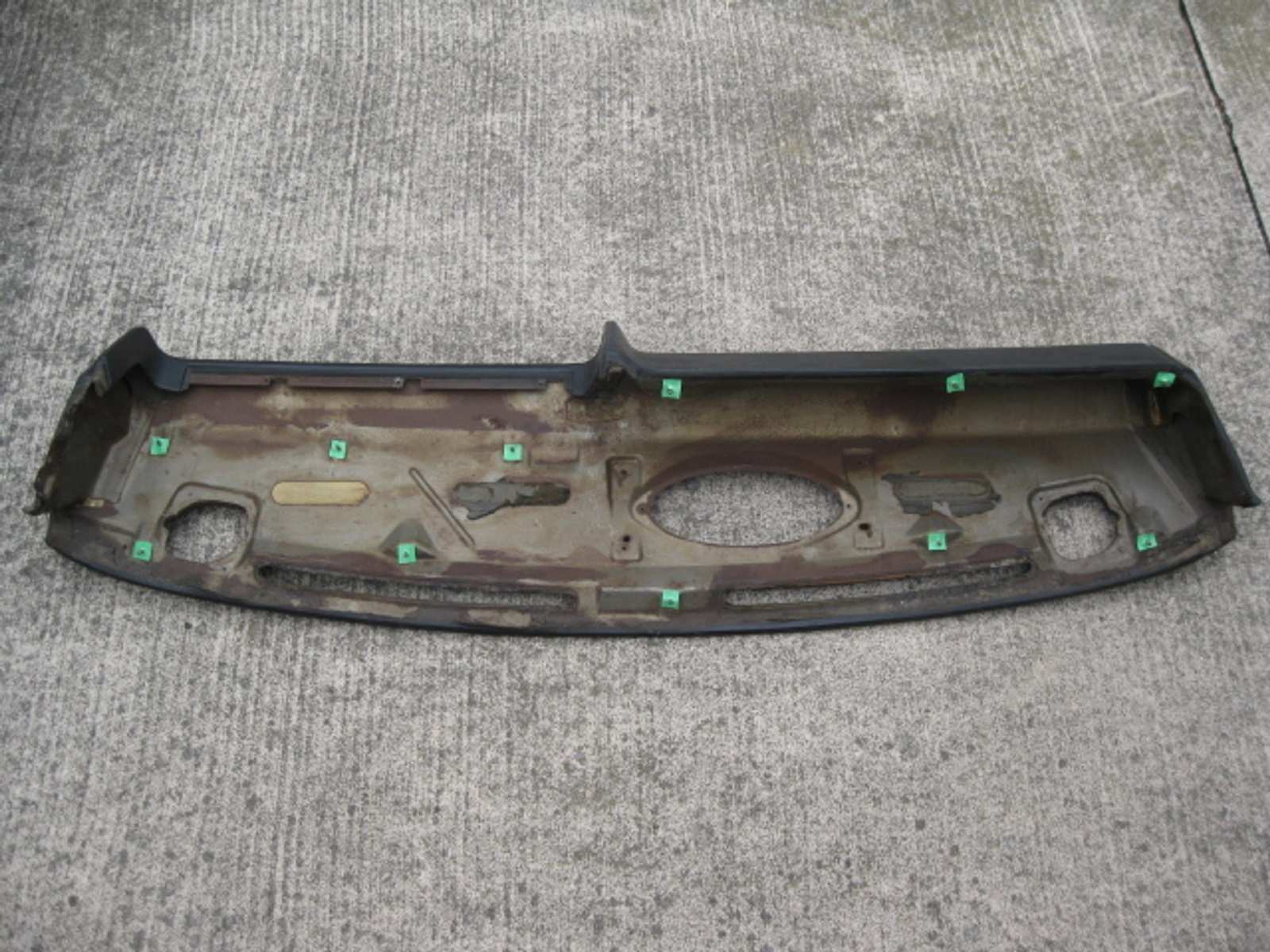

Here's the location of the PAL nuts. There's 4 bolts for the defrost vents too. I've swapped this out with the frame in the car (like heminut) a few times and I "think" I took the instrument cluster out too. I have a, soon to be, 69 year old brain, old info has been replace with UFI.

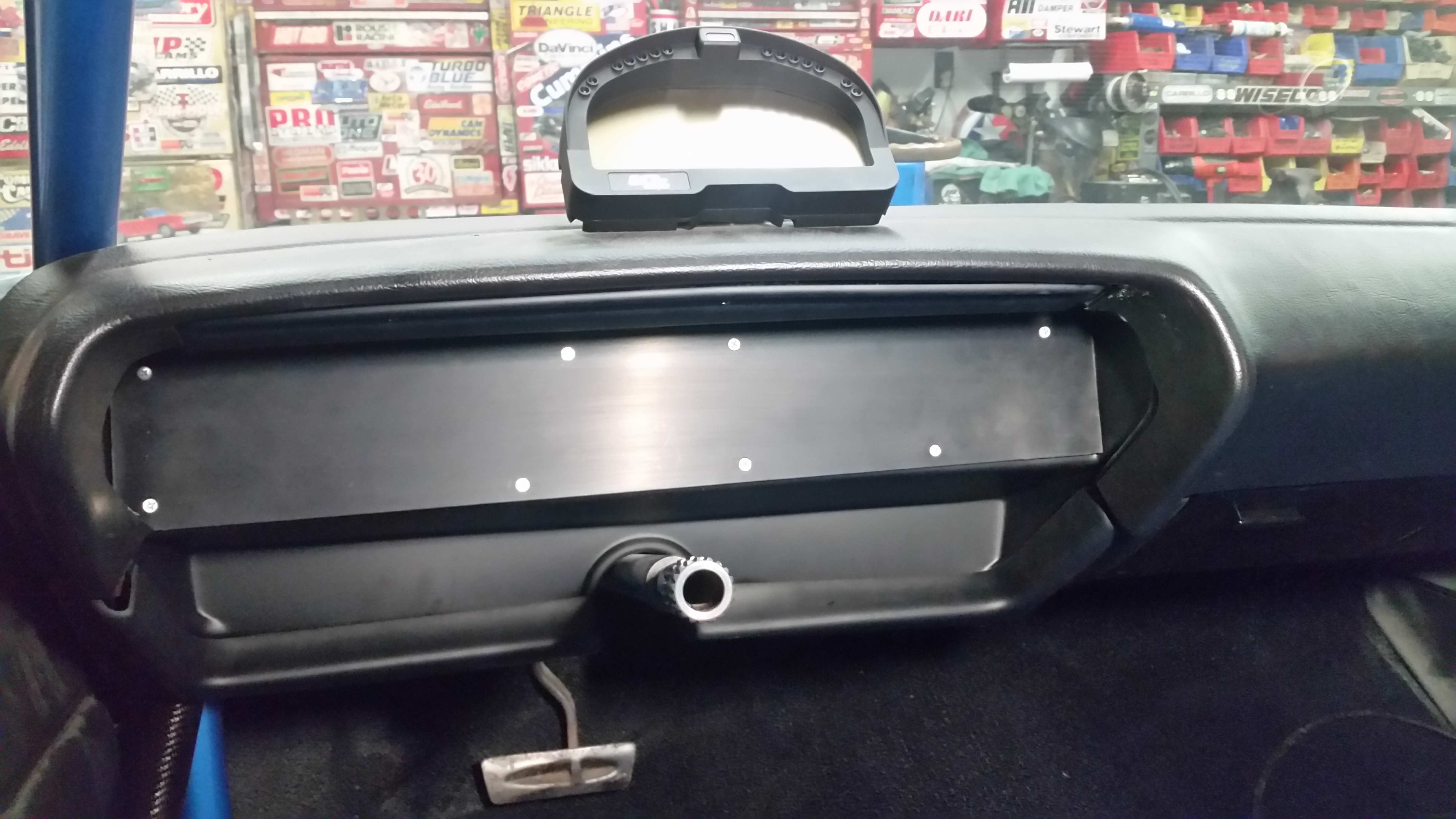

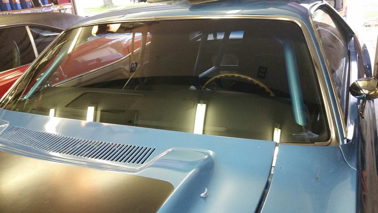

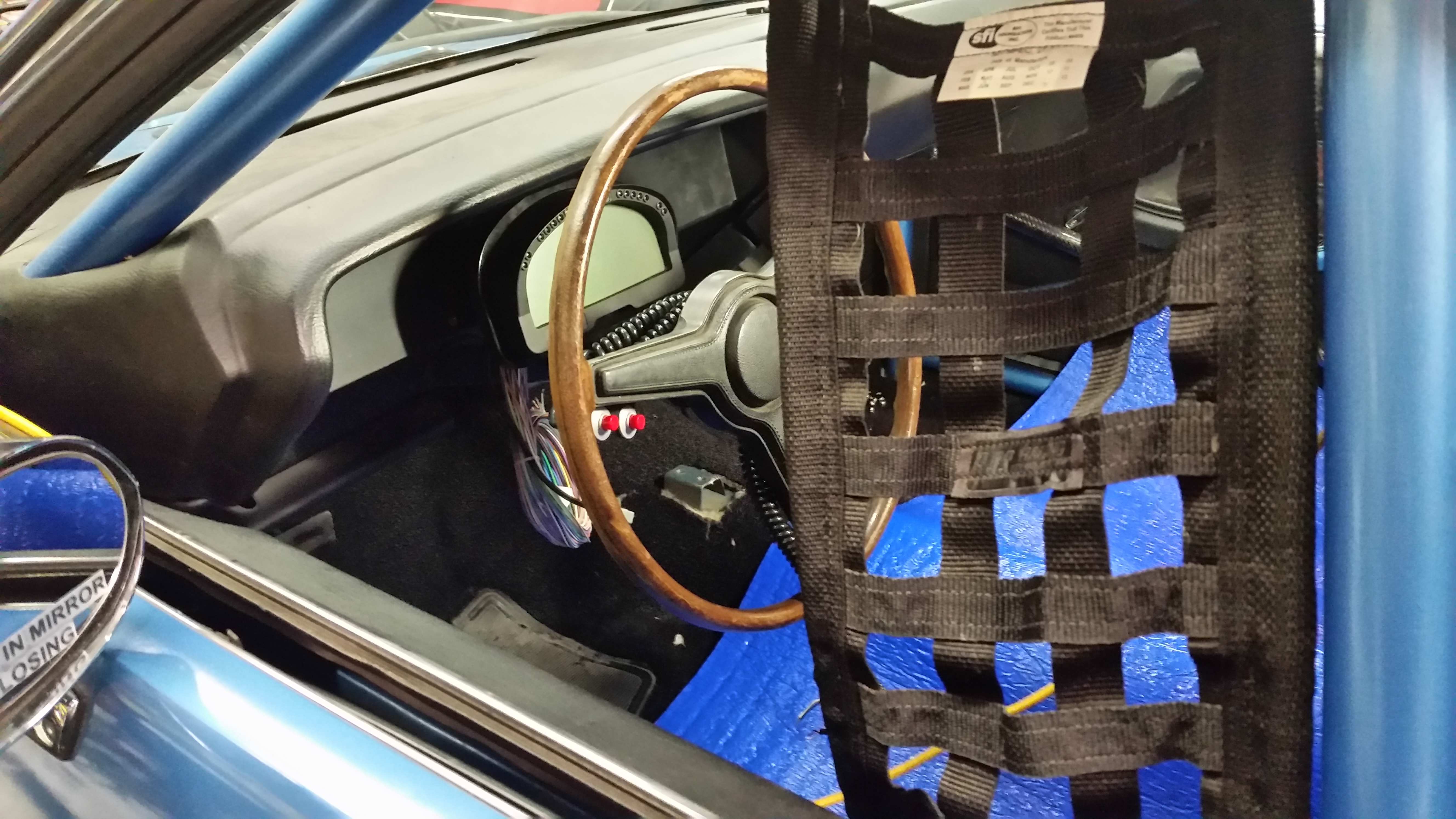

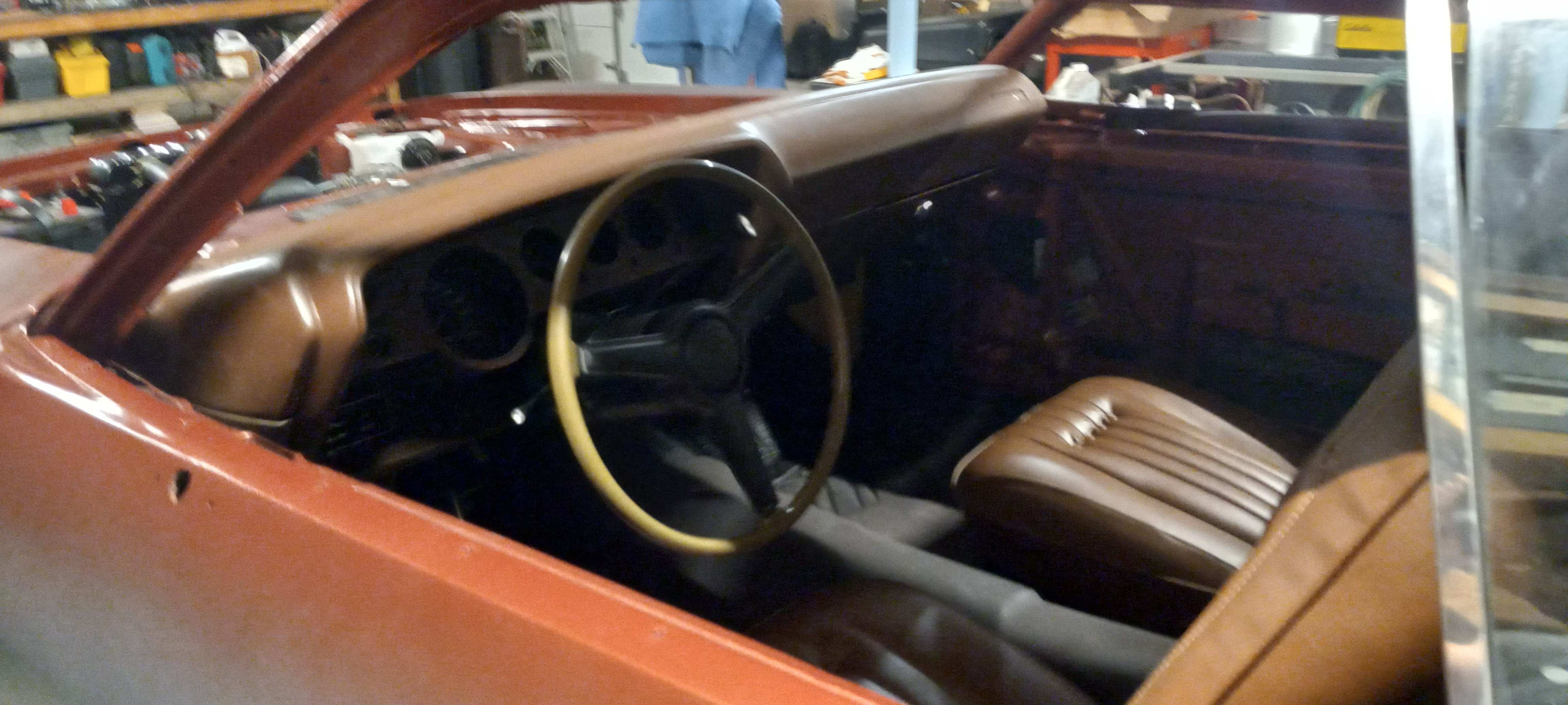

I re-covered my own. My car is not a 100% oem resto, so I wasn't worried about high dollar perfection. It came out nice. However, I had to cut through it anyway for my A pillar bars for the roll cage.

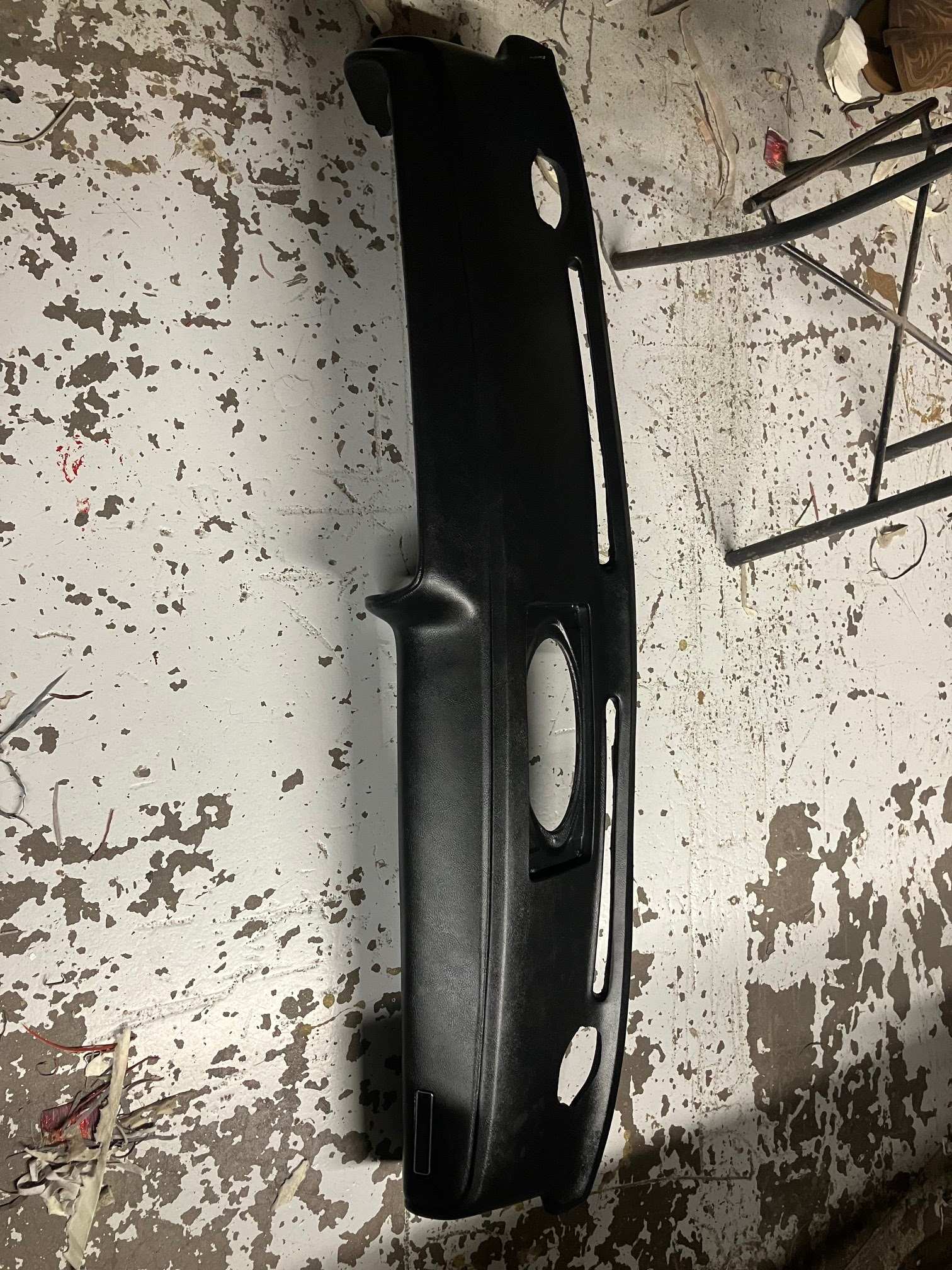

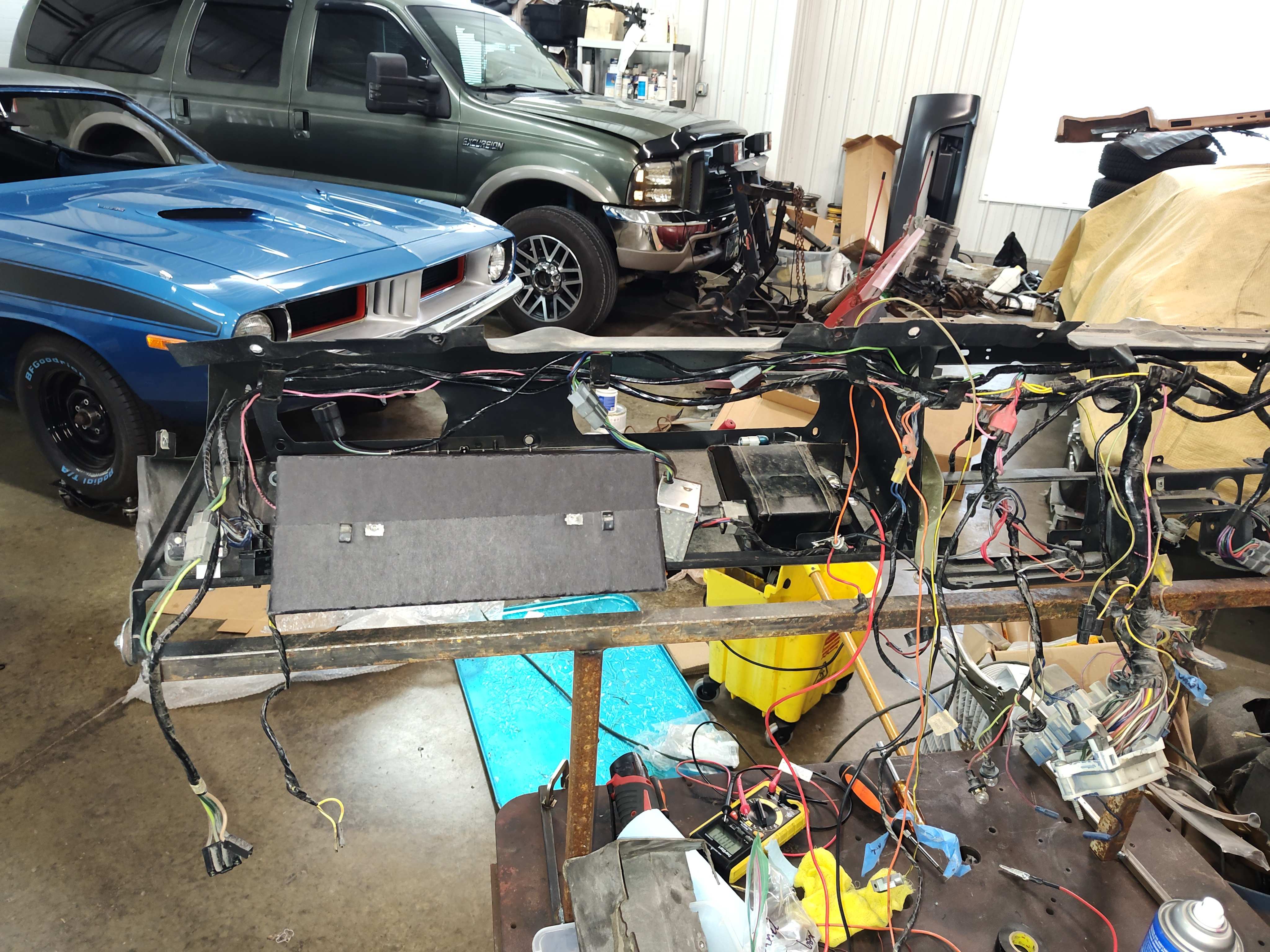

Here's a quick update. They're building my dash pad today and I should get it back next week. Here's a picture of the refurbished gauges cluster all the switches and relays waiting for the new pad

Well I just wanted to update anyone who's interested on the dash restoration. ABC moparts did a fantastic job with the dash pad. I finally finished the complete rebuild of the dash along with all the gauges relays, etc. I threw a picture of my blazer build which is being done at the same time. This dash is one that was damaged and I actually restored myself and retextured and came out really nicely. Again I'd like to thank Bob Baker at ABC moparts for the fine job on the pad.
