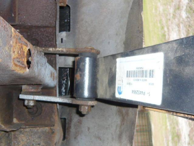

Does anybody have a photo of the stock rear spring hanger. Thanks

hope this is what you wanted. Sorry for the side view

The springs are mounted in a slight V shape from the factory. The springs are closer to each other at the front. When the rear of the spring is offset, it brings it over to where the front part already sits. The springs become parallel when the offsets are used.
