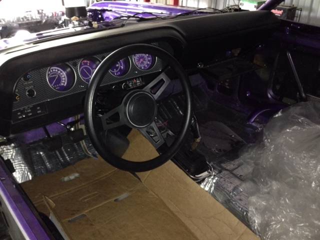

rbbruno3
Jan 1, 2011
1,677
384
upstate , NY
It turned out good ,just wish now I'd sprung for the better turn signal switch instead of the China one or just kept the original with the roller.Oh well not coming apart now. My car is prostreet so its not original color either. I painted column and dash frame in gloss. Should have taken better pics too. Hard to see in this one.
