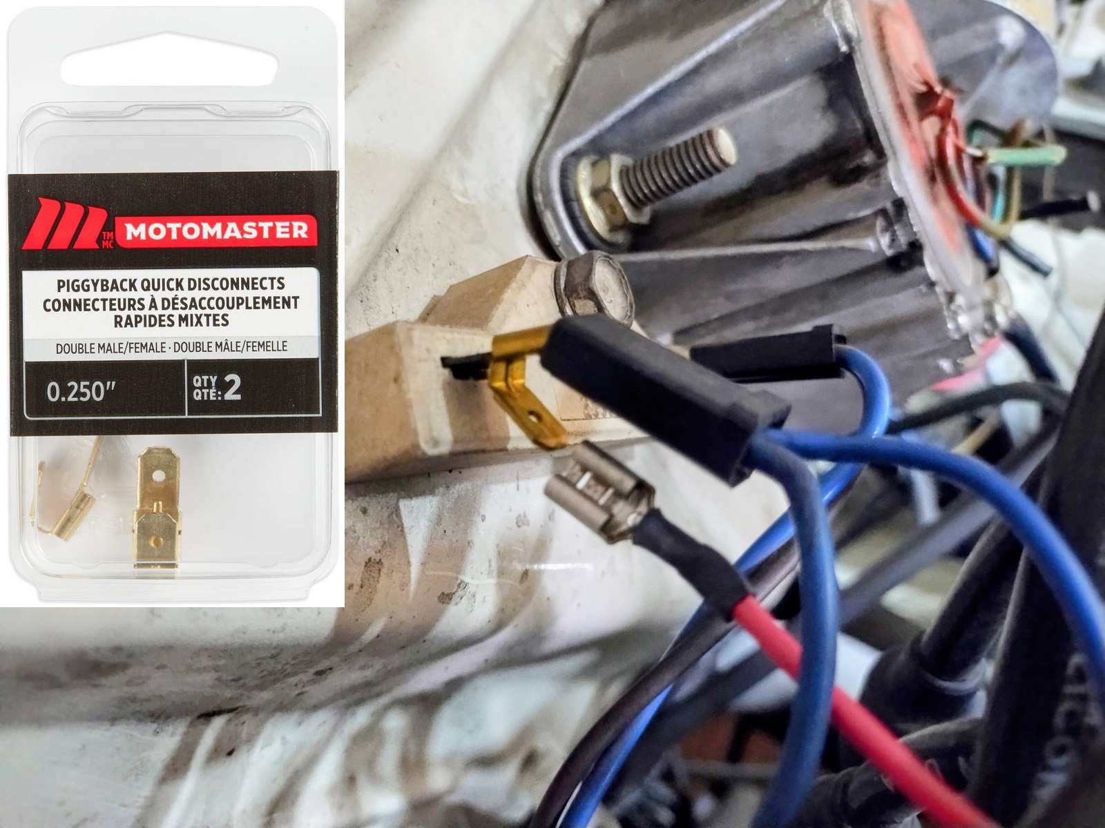

Here's my choke connection setup using a double male/single female piggyback terminal.
EW1BH27
Dec 31, 2021
746
444
Canada
Wish I could help you sourcing it in the US. My options were the electronics store in my city but theirs came in a package of 10, and this package of 2 from the Canadian Tire Store.

I have a box full of those connectors that I picked up somewhere. Work great on electronic ignition conversions as well!
