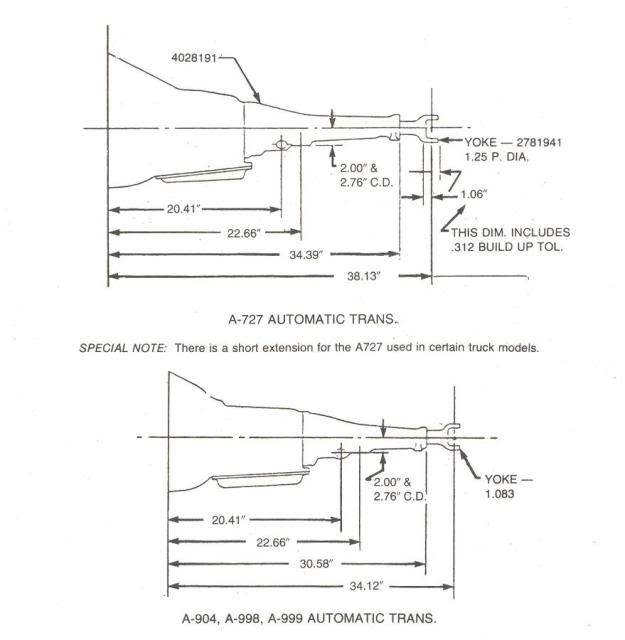

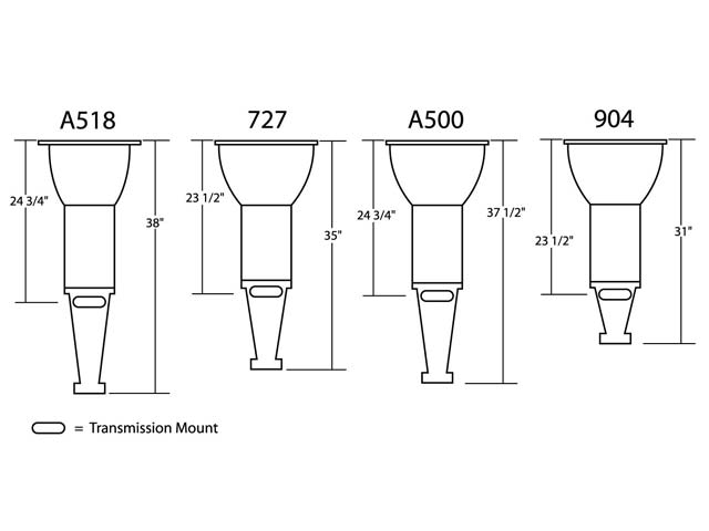

Is the driveshaft the same when I keep an automatic transmission?
The 904 transmission which would be the trans with your 318 is 31" in length. The 727 is 35" in length. The driveshaft would have to be shortened to work with the big block. I believe that the yoke would also have to be changed since the yoke is smaller on the the 904.
