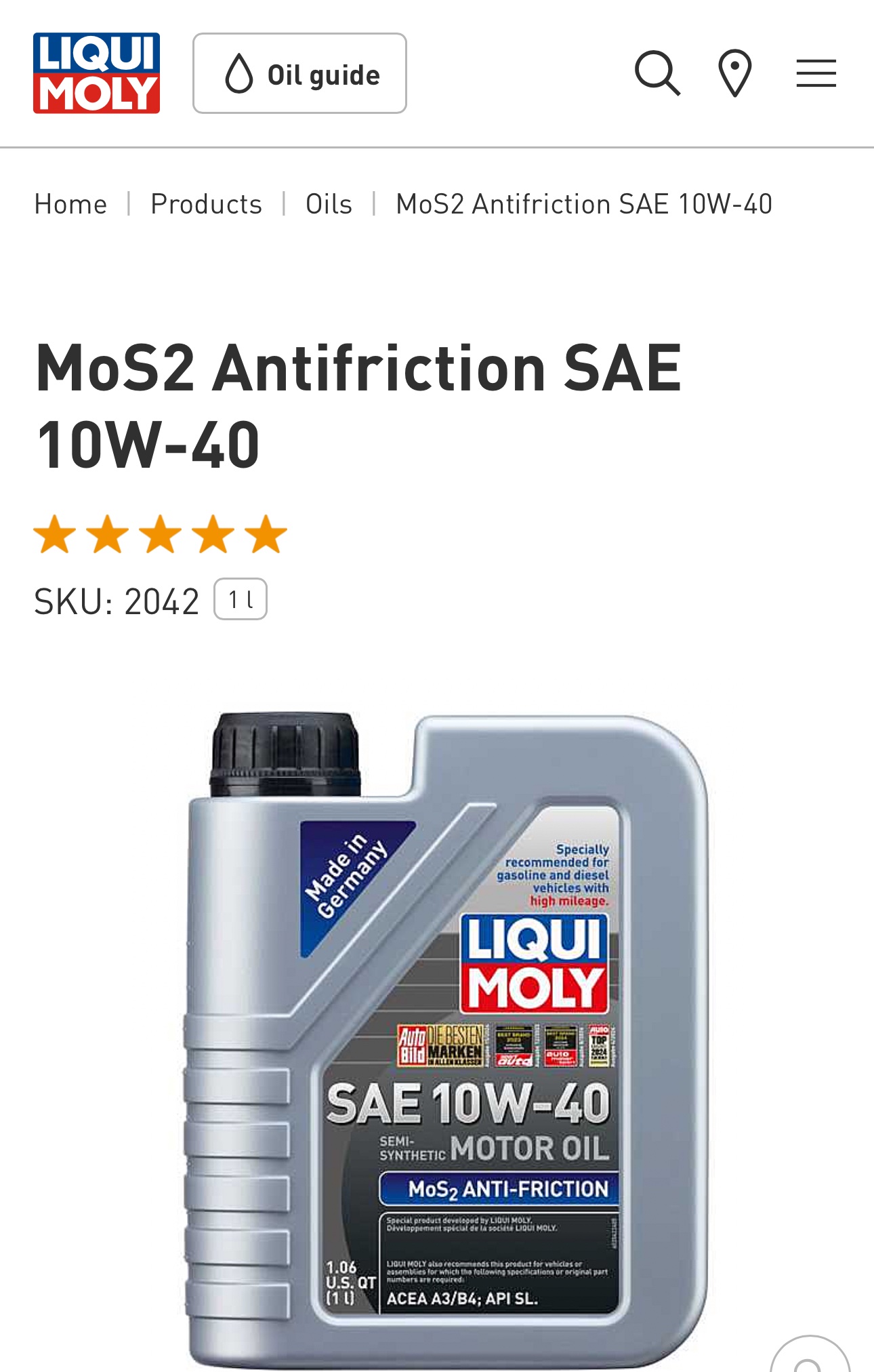

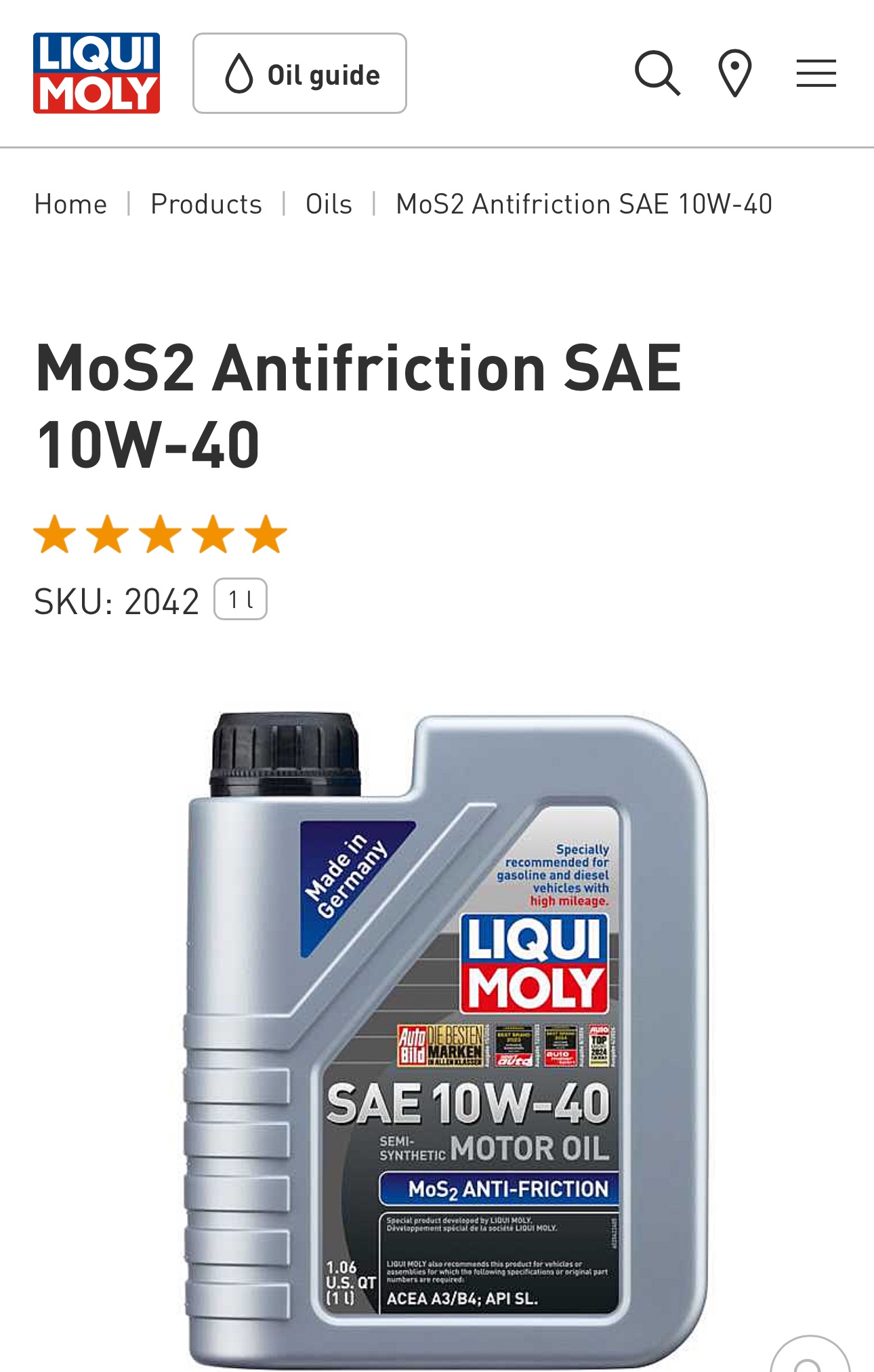

Liqui Moly makes a 10W-40 that has zinc and MoS2 (Moly) in it. This is an oil for your muscle cars engines with hydraulic flat tappet cams. The Moly creates a robust load bearing oil film for extra protection and reduced friction.

Available at NAPA or online, p/n 2042.

Is liqui moly have zinc in it? Or is a substitute for zinc?
This oil is for older engine designs (with flat tappets). It has zinc and Moly which provides a robust load bearing oil film for added wear protection for all the internal engine parts, especially the cam and lifters. One liter bottle p/n 2042, five liter bottle p/n 2043
