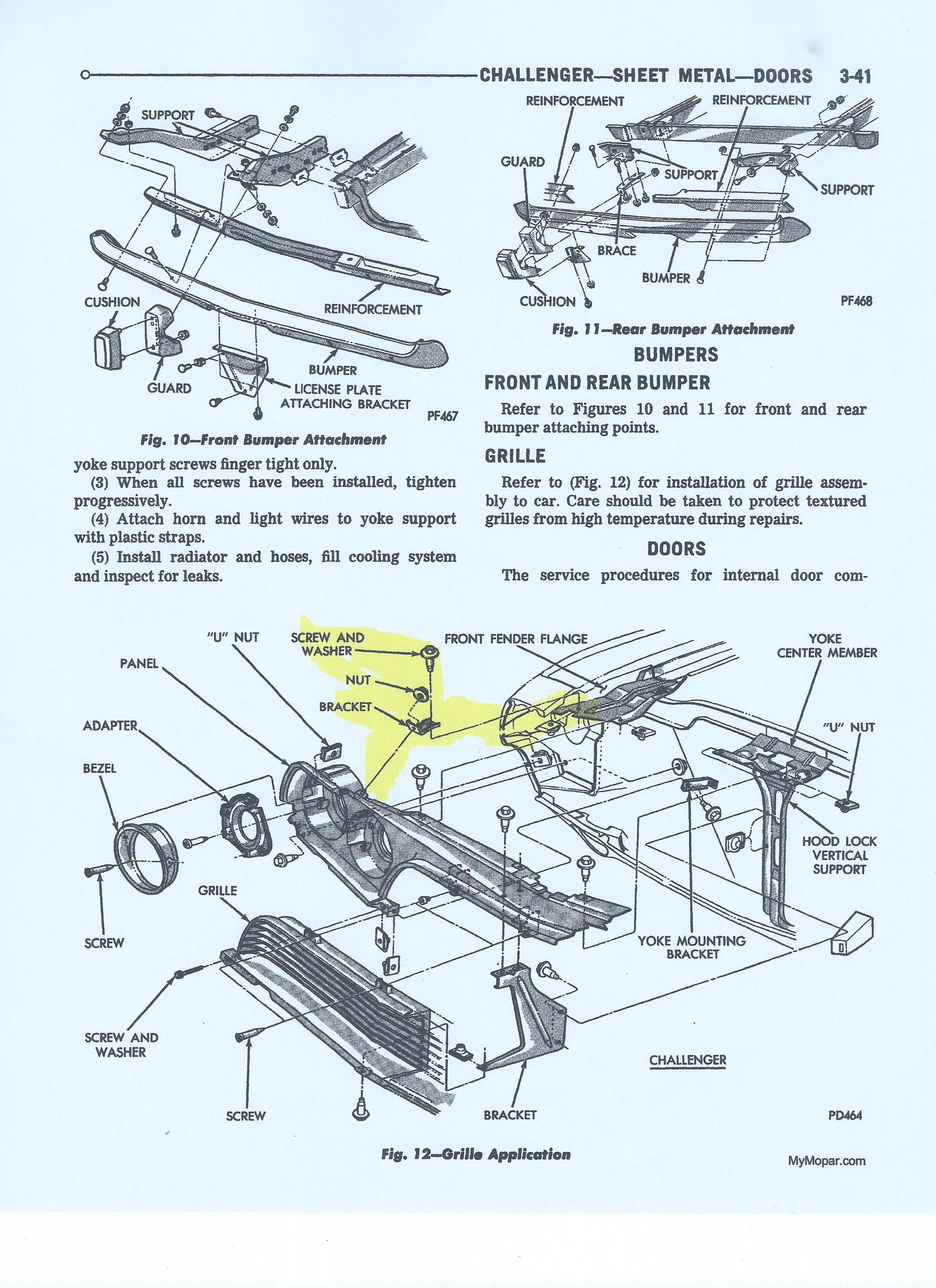

Is there an exploded view of the grille area of the '72-'74 Challengers? Not just the 'frown face' insert but the headlight bezels/buckets, header panel, etc. I've got a '74 Challenger the prior owner replaced the front fenders with '70 AMD fenders and cut out the entire grille area of the '74. It appears the intent was to convert the front end to a '70 grille for a drag strip only car. I'm trying to determine if I can disassemble the front end & replace the '72-'74 parts or would it be easier (a relative term here) to continue with the '70 conversion. I'd like the exploded view to see what I'm up against. Thank you in advance.
