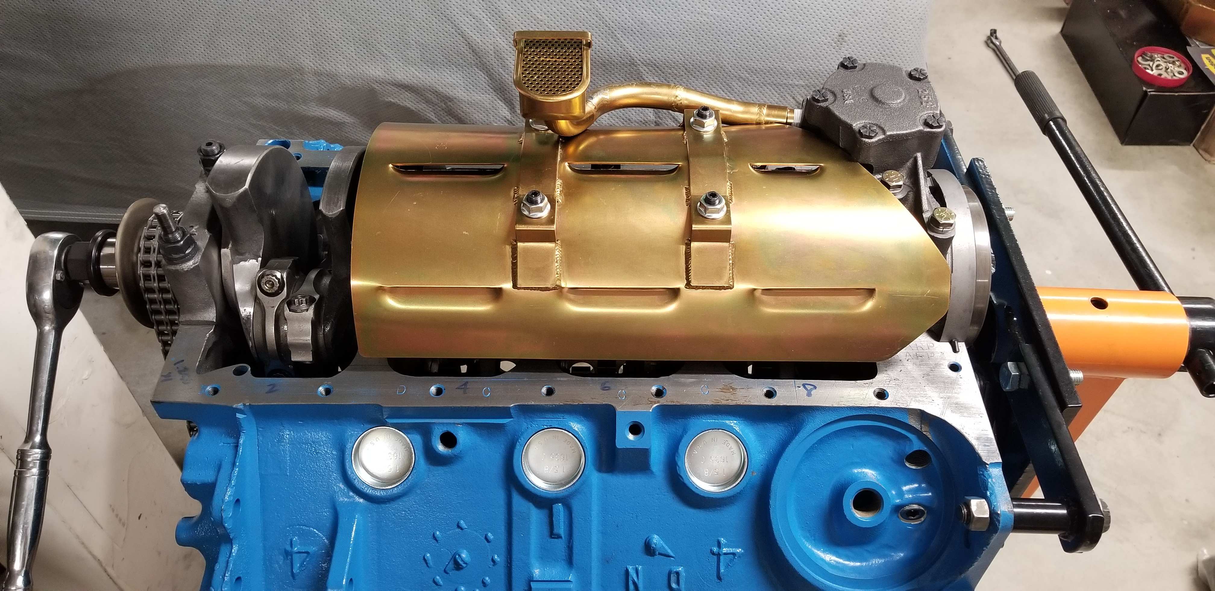

I'm running that same pan on my 340 stroker, with arp main studs my stock 340 windage tray wouldn't work so I used milodons windage tray which should have gone all the way to the front of the engine in my opinion. I did set the stock 340 windage tray on while the studs were out and it should clear with plenty of room, here are some pics of my windage tray setup.

Yes, seems like a half measure not covering the front of the crank but looks like they did the same thing on the SBC. It does look like decent part. Not sure yet if we're going with studs on the build. Just dropped the block off and I wish I was closer to him so it would be easier to make some of these decisions with in person accessibility.
autoxcuda
Apr 16, 2016
97
20
Los Angeles
I think the tray doesn’t cover that front portion might be because the pan itself is so close to the crank. Like, there’s no sump in that area to protect windage from.
I think milodon explained it to me, but I can’t remember.
