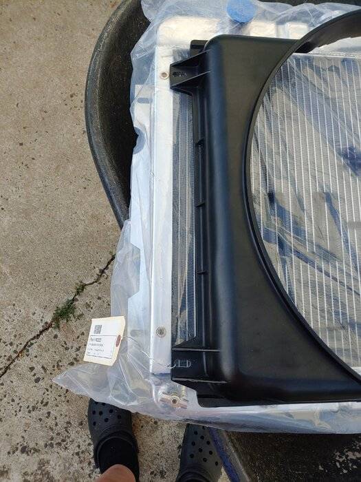

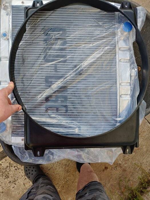

Hi ,1972 dodge challenger small block with 22" radiator,got a fan shroud from classic industry they said it was for a 22" radiator ,not even close to lining up,what are you guys using on a 22" radiator.

What part number radiator do you have? What is the shroud part number?

Well...I think that the problem is not the shroud as it is made to fit a factory radiator. You need to find out from the people who make that radiator what parts are compatible with it.

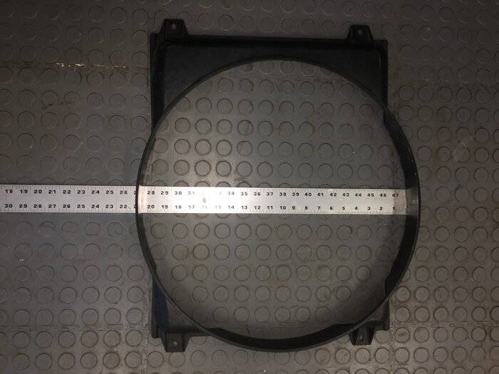

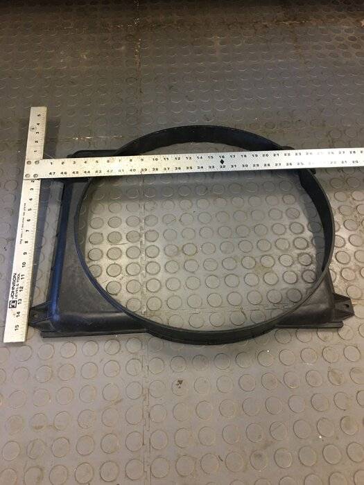

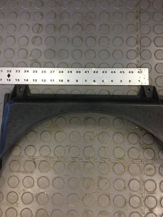

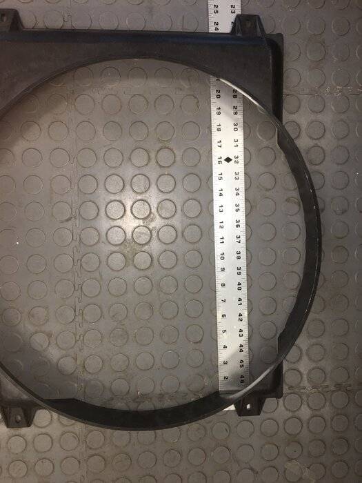

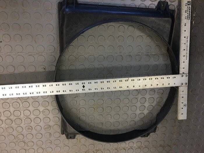

If Cold Case can’t help you, I’d be glad to look/measure a 22” shroud I have. Got a couple boxed up in the attic. It would be when I get home this evening.
Let me know if you need info.

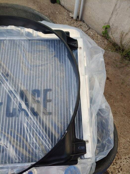

Here’s one I could easily find that is perfect. Check the dimensions and see what you think.

When using MOP755A, OEM fan shroud, #2785614 and 2998325 will work.
