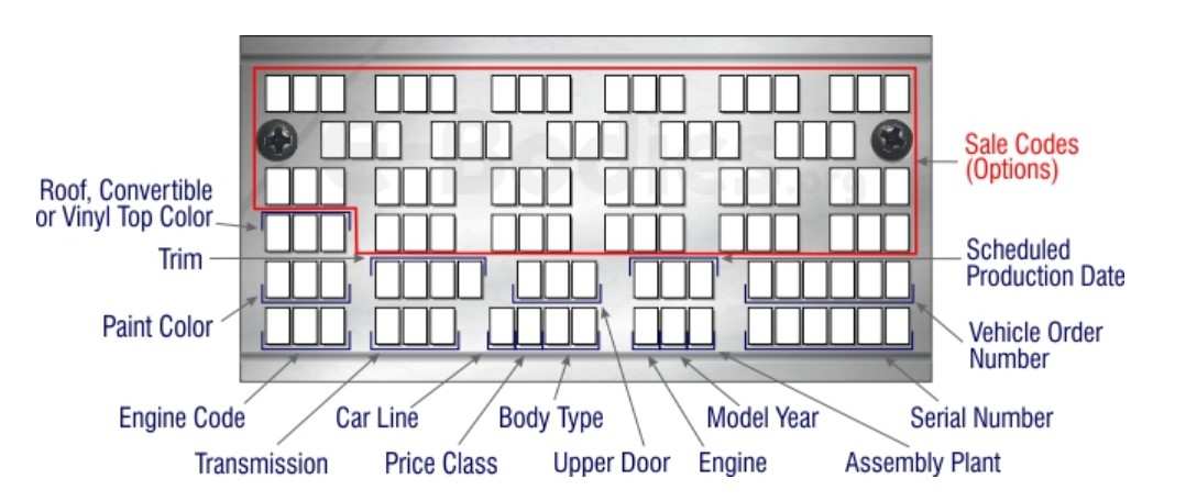

You can make a reproduction tag that is almost entirely correct if you have the Broadcast Sheet. It is not easy to select the correct codes because the period of time that the car was assembled has a great deal to do with getting the proper fender tag codes on the tag. The Vehicle Order Number (VON) is on the Broadcast Sheet (BS) and the Window Sticker (WS) but unfortunately not everyone has their original BC and/or WS.
@Challenger RTA is correct about the "assembly line number" remaining undetermined. This code ends up being the last code on the fender tag. There is no way to know which assembly line "number" code (EN1 or END only for 1970 Hamtramck E-Bodies) was on your original fender tag unless you have it. Guessing based on the VIN's Sequential Number using fender tags close to your VIN does not guarantee you got it right.
Maybe 6bblgt can assist with how this might be determined. He has info on what was "in process" and when for a lot of cars.
